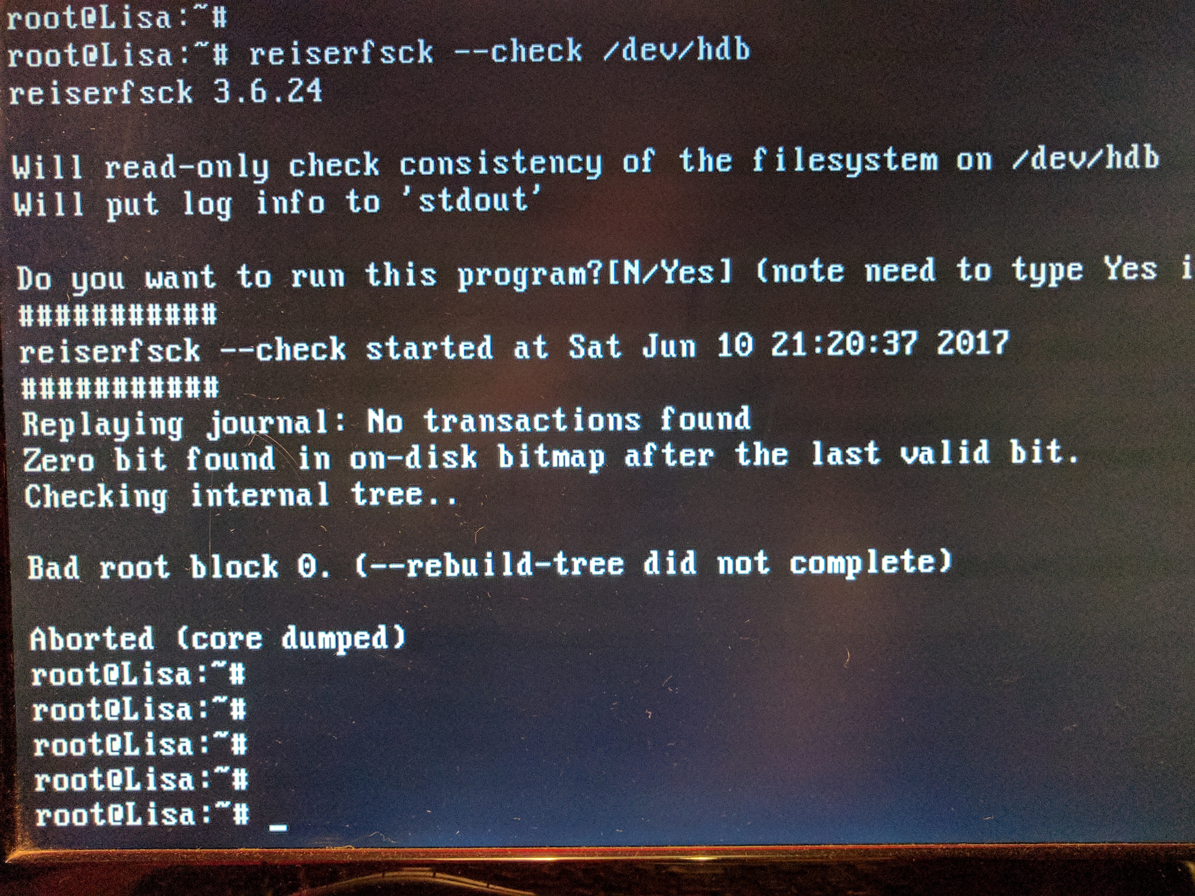

I ran reiserfsck --check that resulted in below screenshot. Then I tried reiserfsck --rebuild-tree and that logged a bunch of statements about corrupted blocks and got hung without making further progress.

The command line you used looks incorrect!    When using the raw device names you need to include the partition number so you should have been using '/dev/hdb1'.
if the array is in maintenance mode then you can use /dev/mdX where X refers to the disk number in the unRAID GUI as the mdX devices already take the partition into account.
