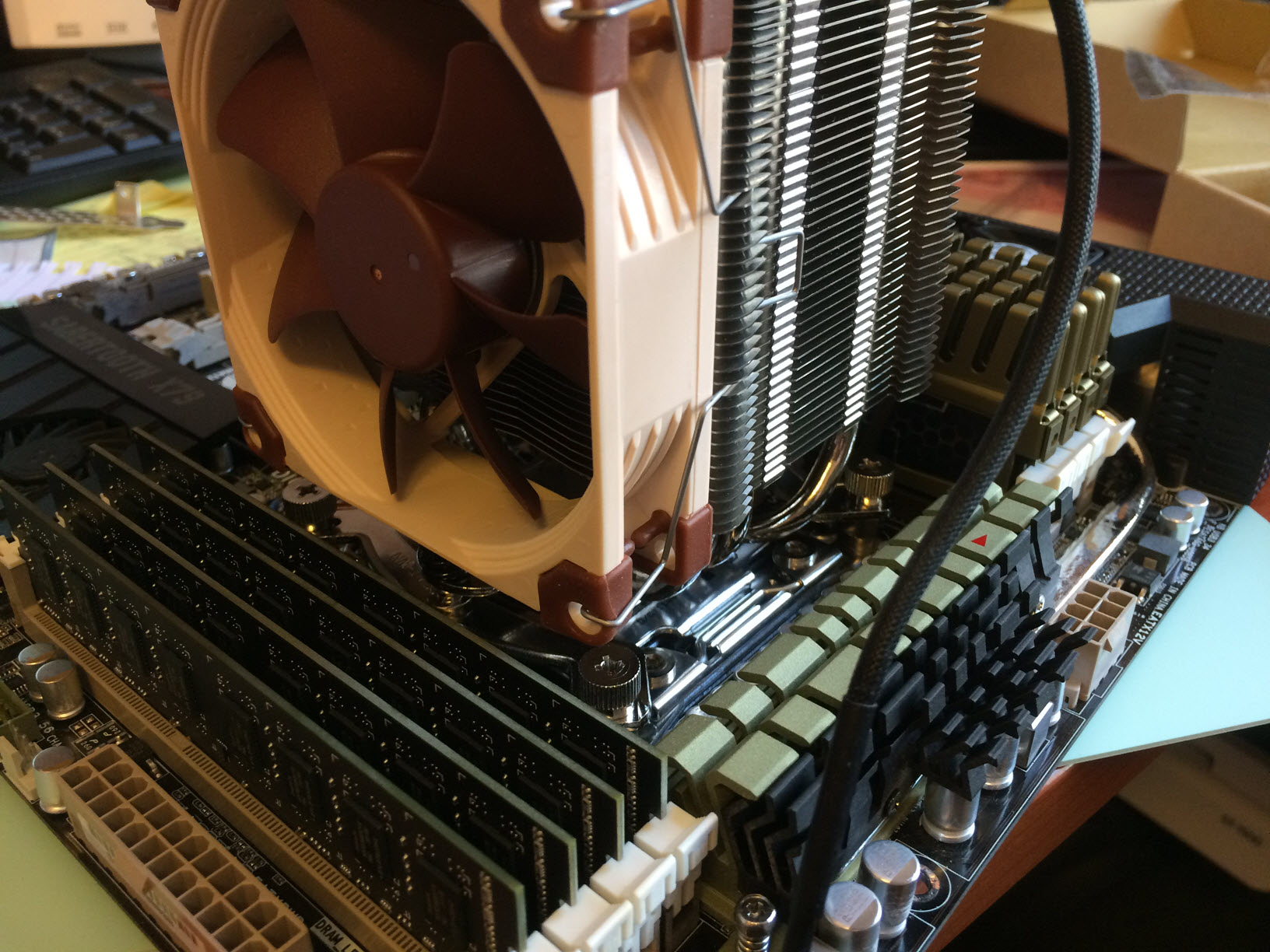

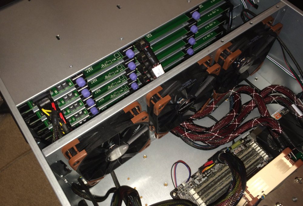

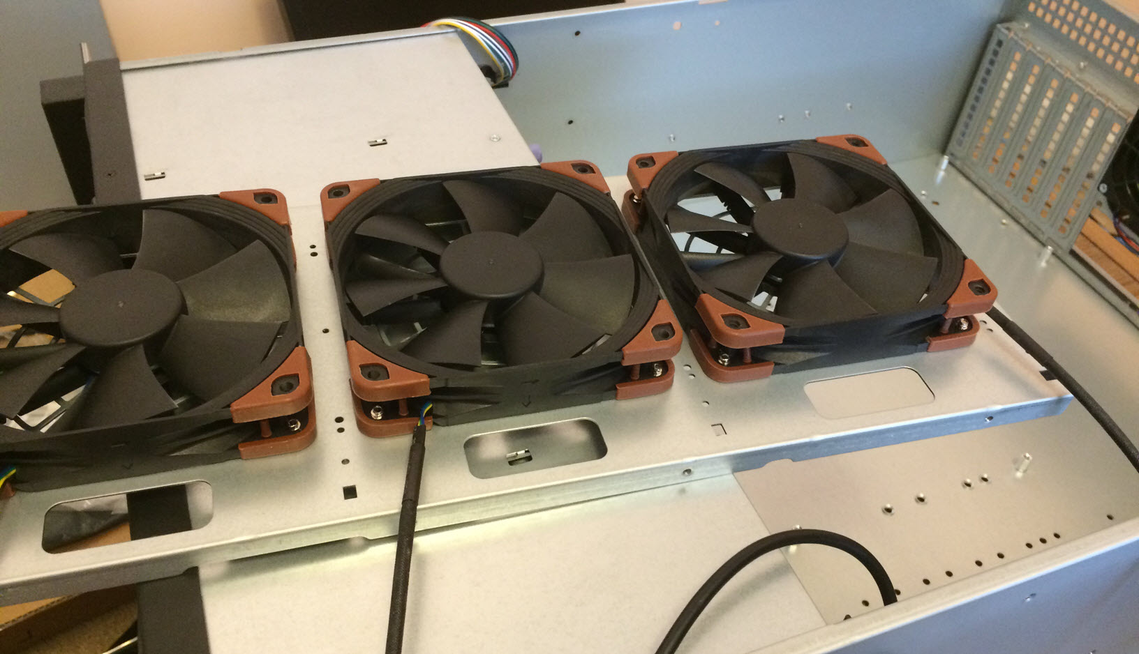

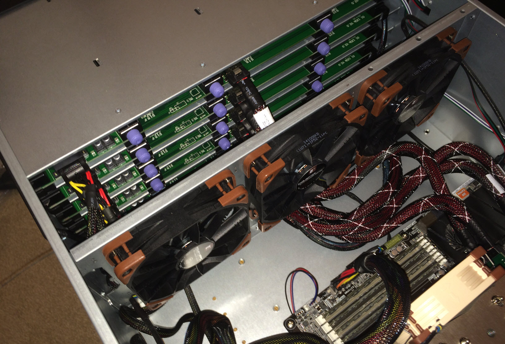

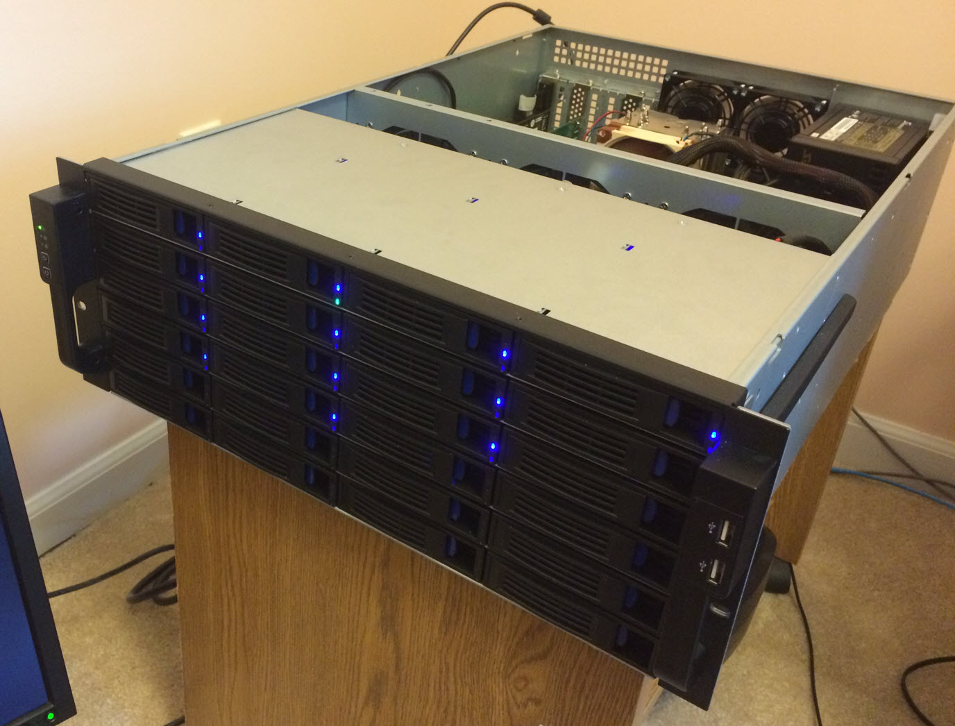

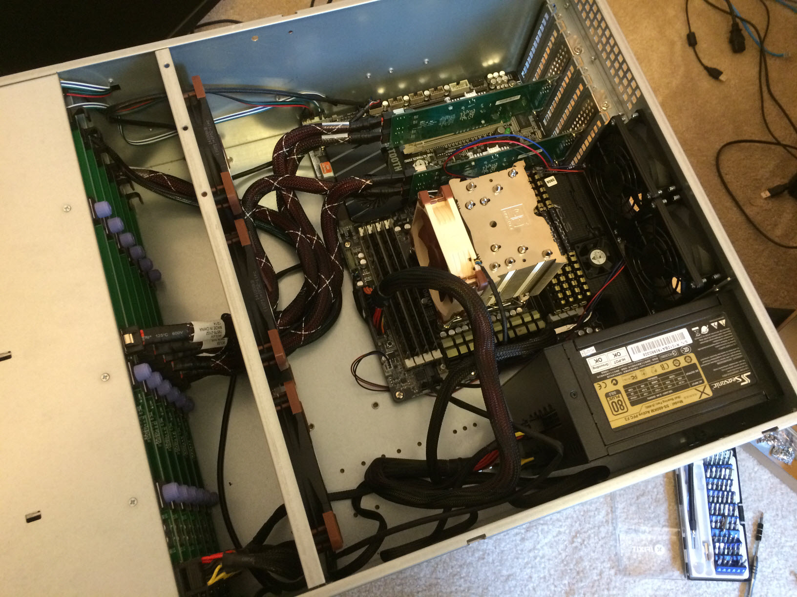

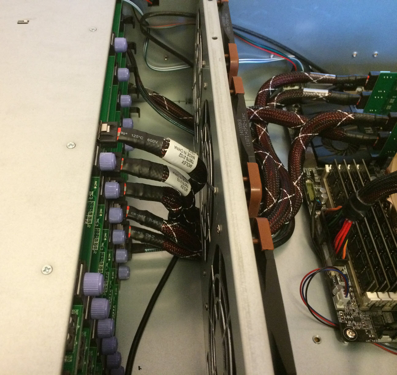

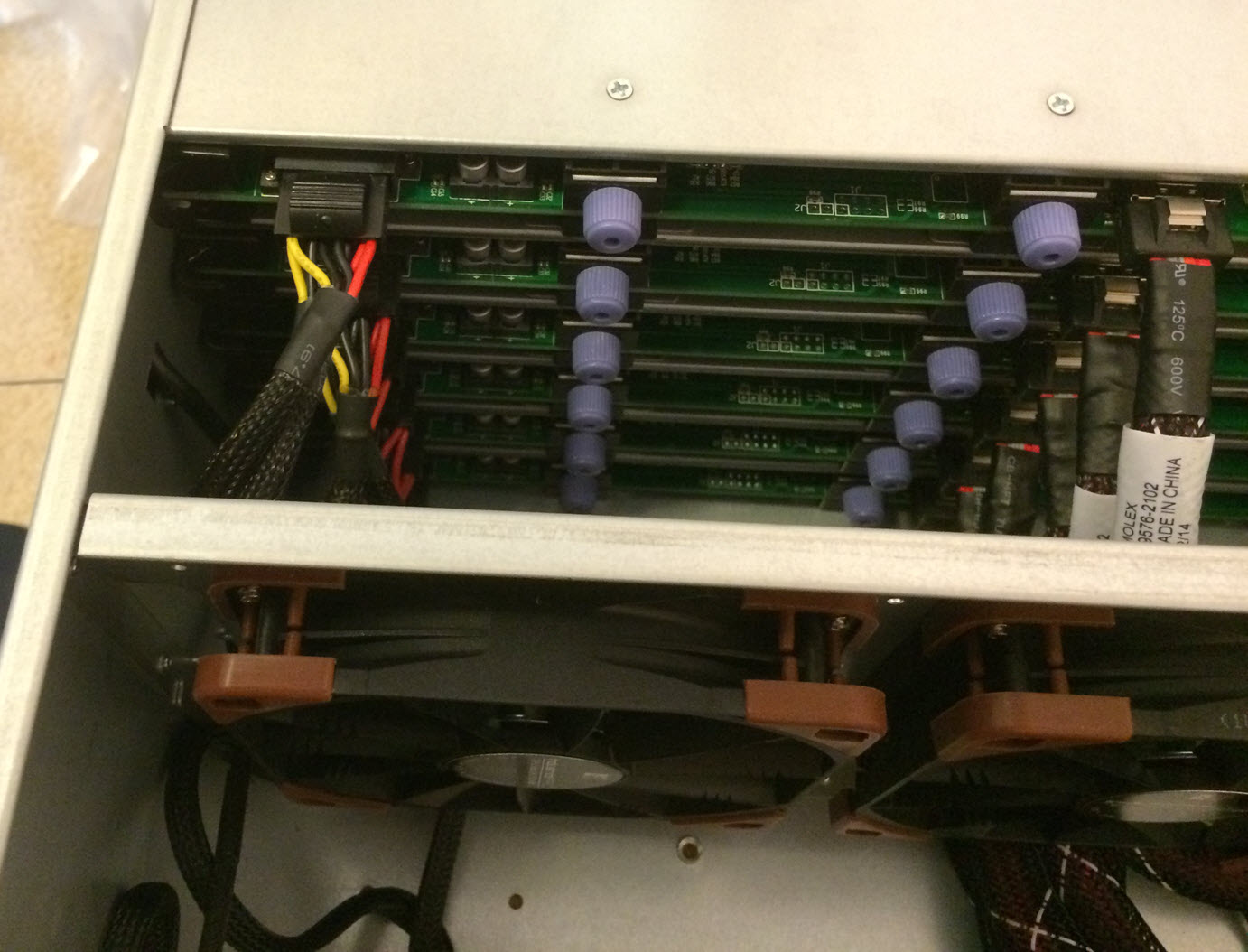

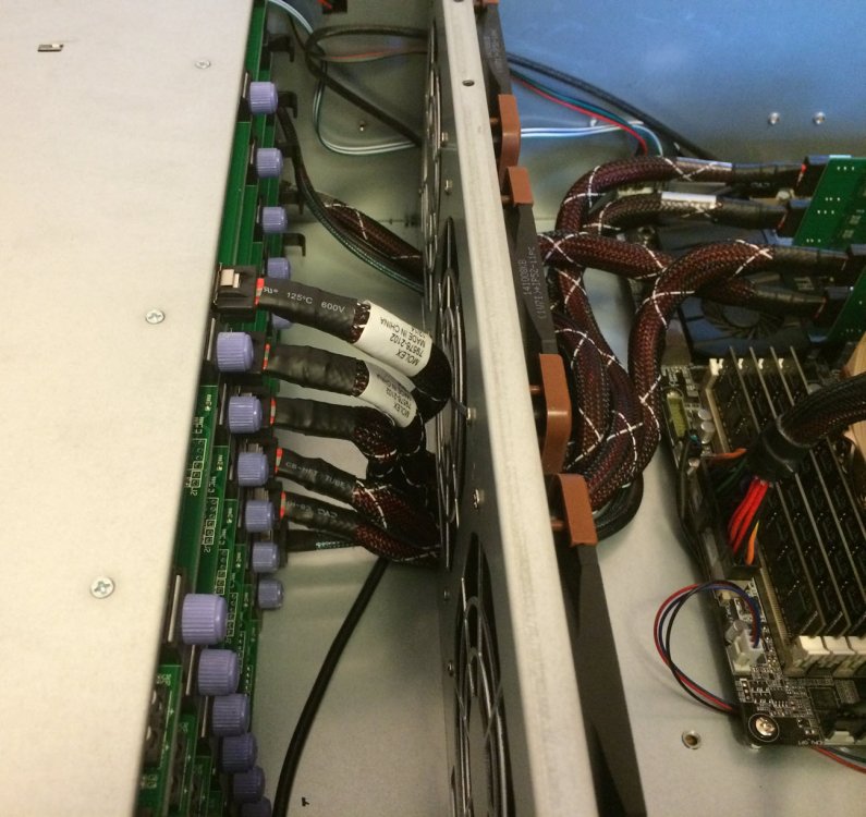

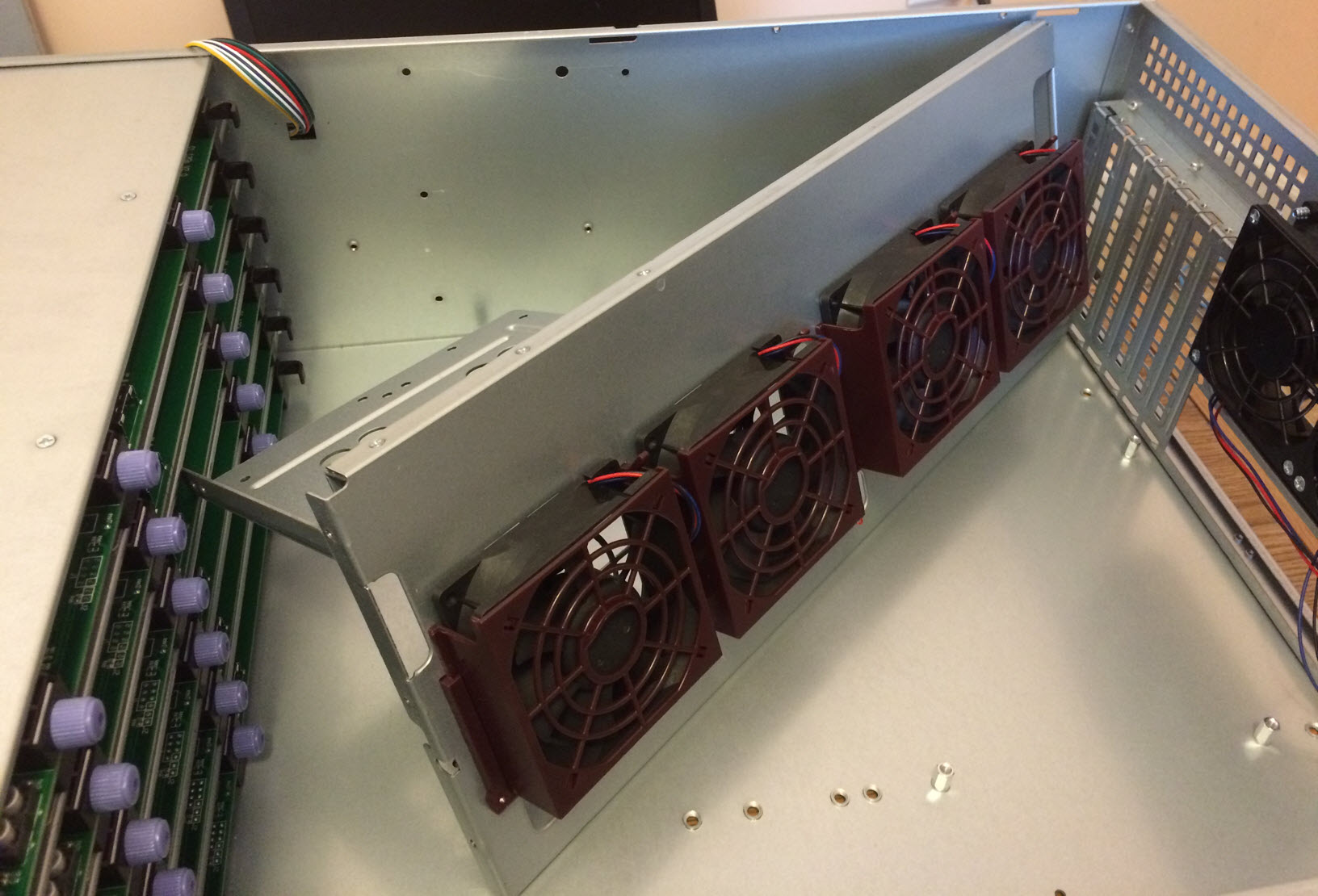

I already have a 15 drive 48TB system. One drive has been giving me a little issue so I figured I would replace it before it got too bad. Seeing the price of $309 for an 8TB drive was good news. I didn't opt for the Helium drive and went for the regular NAS 8TB model. Most of my drives are HGST and run fine anyway. Here are a few pictures of the build.
