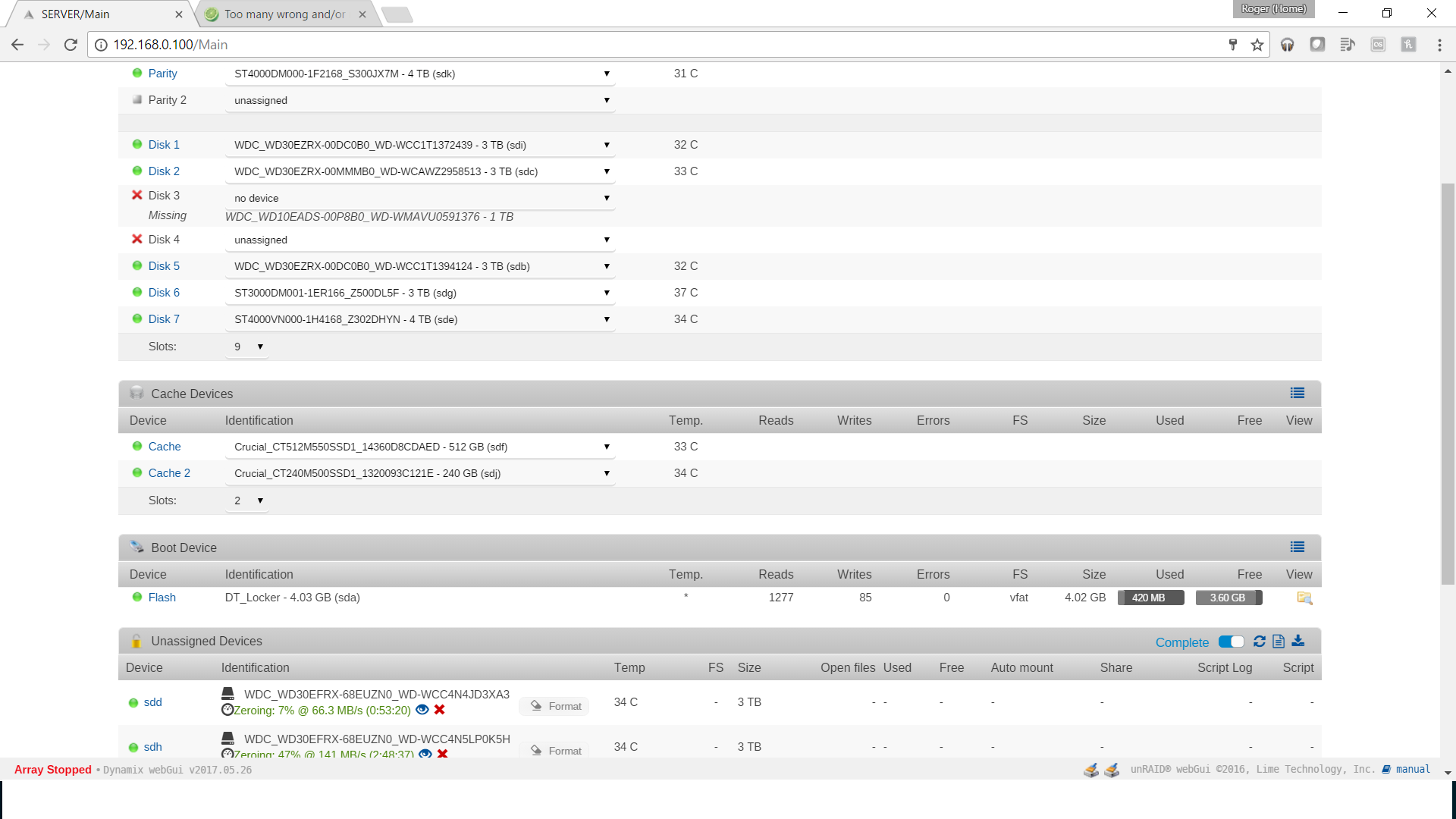

Too many wrong and/or missing disks! (cant replace two bad drives with newer)
I have had two drives fail on unraid and just added two 3TB WD RED but after assigning them, i cant start the array "invalid config"
Disk 3 shows missing bad 1TB. Replacing with 3TB red
Disk 4 shows unassigned. Replacing with 3TB red
Any ideas how i can get these two new drives assigned?
Do you have dual parity? You can't replace 2 disks at the same time with single parity.
Maybe this is what you meant, but you don't want to ADD disks, you want to REPLACE them. Unless you have 2 parity disks you can't rebuild 2 failed disks.
Go to Tools - Diagnostics and post the complete diagnostics zip.
I am running a second pre-clear on my new drives again as i thought that was the issue. Attaching a screenshot. I only have one parity drive :( so if i lost data its ok i guess. How do i get these new drives in?
