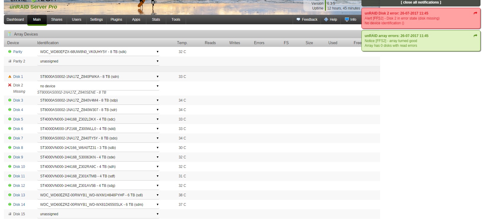

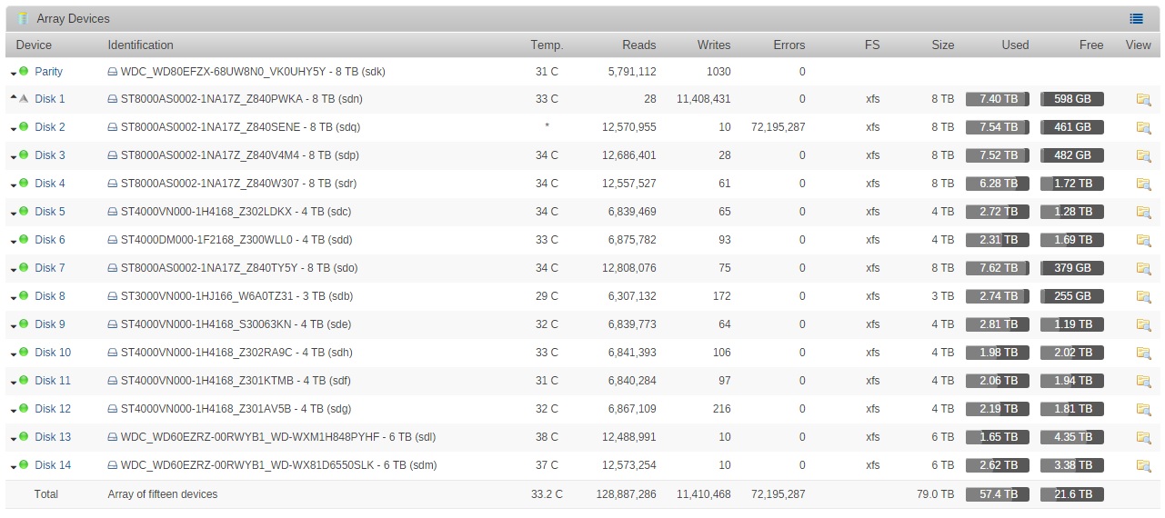

Had a rebuild of disk1 going over night.
Woke up to Disk 1 emulated (again) and Disk 2 has 72,000,000 errors.
Diags attached.
ffs2-diagnostics-20170726-1128.zip
I have enough ports on the MB and a spare (marvell.....) controller, I can run 100% of my unraid disks on non-Marvell ports, and a mostly unused scratch disk outside the array on a Marvell until my LSI arrives (Aug 2).
Can I attempt to rebuild Disk 1?  Is Disk 2 totally toast?  From the command line I am getting i/o errors, tried to 'ls /mnt/disk2" to see what all data I fear I am going to lose.
How bad is this?
Stopped the array to power down and swap hardware, now Disk 2 is missing and Disk 1 is emulated.  I assume this means I am going to lose data.

Reboot and disk2 should come online, but I'd wait for the LSI to attempt another rebuild (or do it if you can connect all disks without the SASLP)
Thanks Johnnie.  Disk 2 came back up and Disk 1 is rebuilding.  All array devices are on my existing LSI and Asmedia/Intel ports on the MB.  My spare scratch disk is on an old PCI Promise Tech SATA1 controller, but speed is not necessary on that drive.  Array is rebuilding Disk 1, fingers are crossed.
