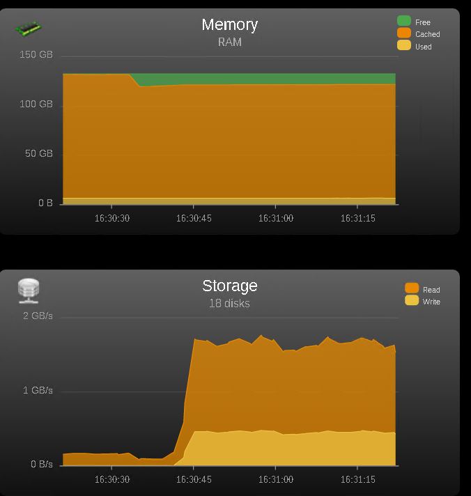

Thanks for all the great pointers in the right direction! With your help I think I'm able to explain the cycle I described in my first post was caused by the setting:
vm.dirty_expire_centisecs = 3000
This is triggering every 30 seconds, and the files on average were 9 -12GB that I'm transferring. Around the right size such that it would take trigger one or twice during a copy.
In the attached screenshot it shows copy speeds go from ~160MB/s (the section on storage chart that shows only read activity, cause it's reading the source disk straight into the cache) then when the cache flushes to target disk (write activity occurs on the chart, and lots of read activity due to using reconstruct write), that same file copy speed goes down to ~30MB/s.
I suspect that this is because the when the cache flushes to the target disk it not available and forces the copy that's still in process to write directly to the target disk at the same time. The cache flush and the file copy in progress are then competing for writes at the same time and that's why I'm seeing ~30MB/s during that time. Is that theory anywhere close to being correct?
I've been tinkering with the other settings mentioned to find the optimal settings but so far only getting ~90MB/s sustained... I recall in my prior server that 8TB WD Red's would reconstruct write at ~130MB/s from disk to disk.
