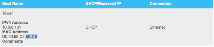

Looking at your syslog, you have two ethernet ports on your MB.  The log is showing that one one is connected (eth0) and it has an MAC address of   d0:50:99:c2:8b:cb
(Your second interface has an MAC address of  d0:50:99:c2:8b:cc      )
Look at your router and see if that is the MAC address that is associated with the IP address of   10.0.0.131

I checked the Modems remembered devices and the MAC address of the port associated with 10.0.0.131 is d0:50:99:c2:8b:cb.
Inside the Modems WebUI, under connected devices, there is the option to edit to the device to have it assigned a DHCP address, or give it a reserved address. I've tried both of these options, though, to no avail. I attached a screencap.
Outside of that, I'll have to check the rest when I get home from work.
Would it be worth swapping to eth1 and trying that?

You can try eth1 port but the diagnostics file says that eth0 is connected to something at 1000Gb/s so things should be working as is. (eth1 was not connected at that point.)    UNLESS, one of the two ports (computer or switch) or the cable connecting them is defective in some manner.  (PS---  I have had bad ports on switches before...)
The reason for the request for the MB and CPU specs is for other folks who are reading this thread who might have some experience with these and could shed some insight into what is happening.
