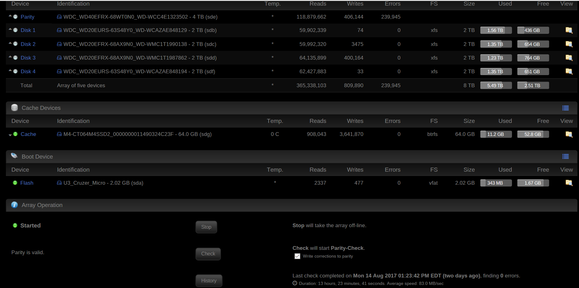

Setup: 1x4TB WD Red (parity), 2x2TB WD Green, 2x2TB WD Red, 64 GB SSD Cache, 2GB Flash.
On the Main tab, under the "Array Devices," unRAID is saying that there are 239,435 errors for the parity disk. However, under the Parity History, the last check completed with 0 errors (run on 14AUG) - please see attached image.  Is this something to worry about?  I tried searching the forums, but could only really find info about actual parity errors that come up during a check.

As I understand it, those are read errors on the disk itself, not parity errors - the errors just happen to be reading the parity disk.
HOWEVER - wait until one of the experts peruses the diagnostics file and chimes in with a more authoritative answer before doing anything. In the mean time, I would suggest that you suspend any write activity to your array. If you're simply streaming media, you should be OK until then.

Yes, and they've been happening for a month at least, do you have system notifications enable?
Start by running an extended SMART test on the parity disk.

No, read errors on unRAID can be caused also by a bad cable/connection, controller, power, etc, read failure on a SMART test on the other hand it's the disk for sure, when it's a few bad sectors some more adventurous folks like to try and preclear the disk, it may last some more time, but in this case the disk failed on some many different sectors that IMO it would be a waste of time and big risk, any read failure during e.g. a rebuild, will result in a corrupt rebuild.
