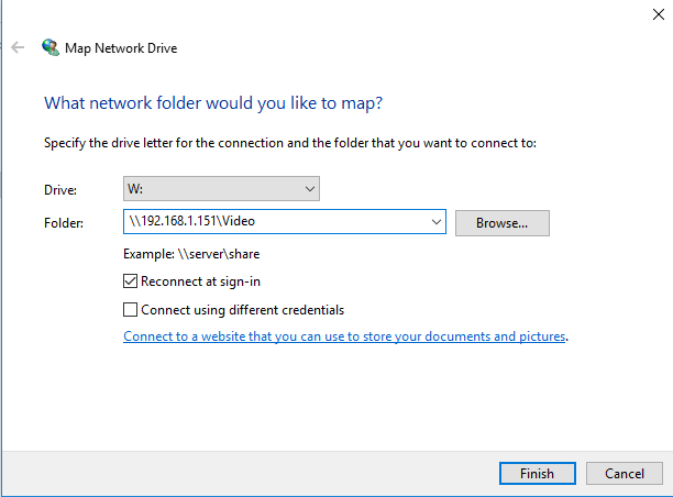

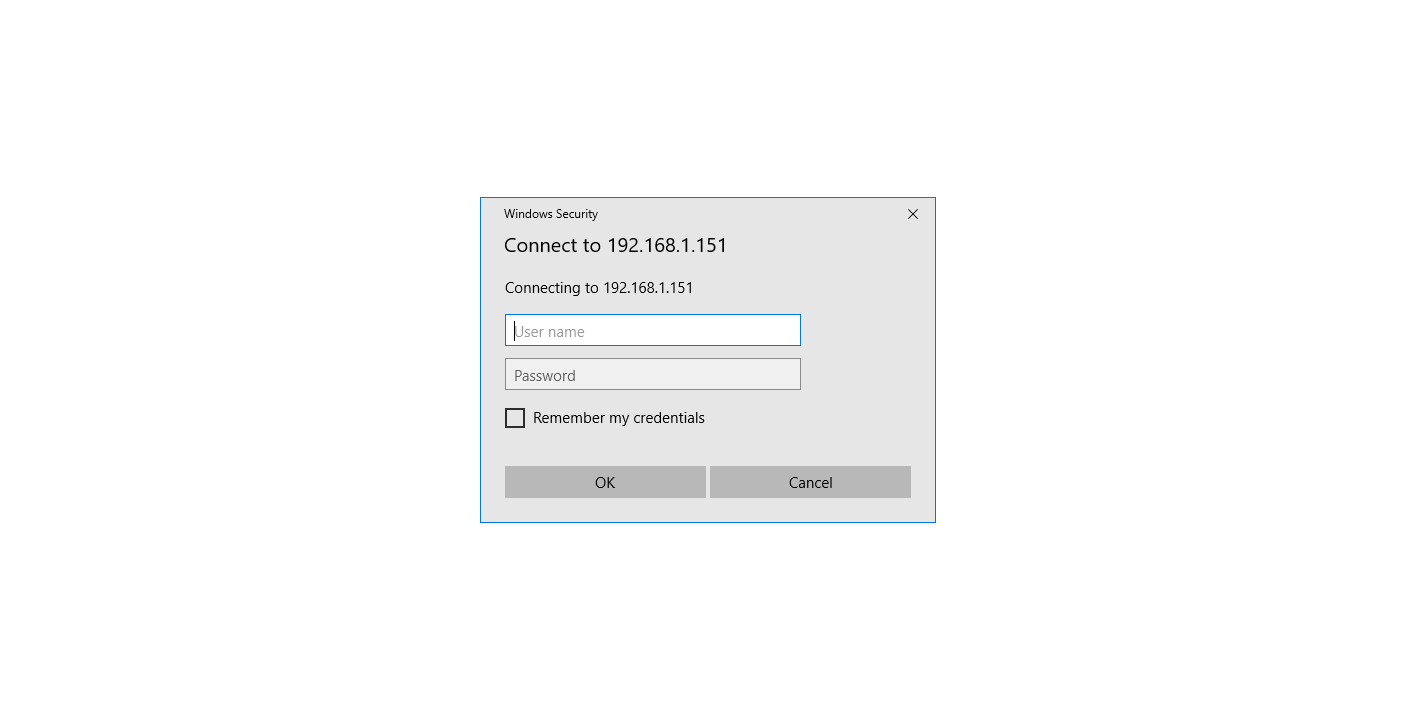

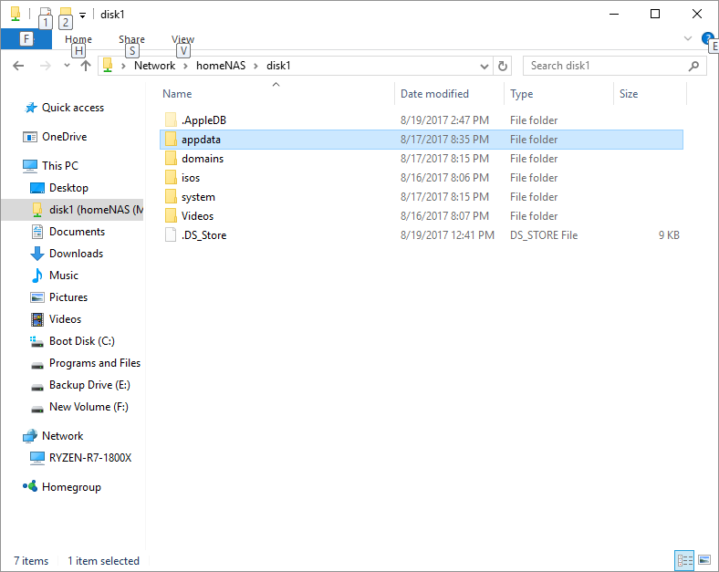

August 19, 20179 yr Okay so your PC you can ping the server so it can see it on the network. Thats good. Now try mapping a network drive to your Video share. Goto this pc, click computer then map network drive. Then enter this into whwere it says folder \\192.168.1.151\Video like this Edited August 19, 20179 yr by gridrunner
August 19, 20179 yr Author 47 minutes ago, gridrunner said: Okay so your PC you can ping the server so it can see it on the network. Thats good. Now try mapping a network drive to your Video share. Goto this pc, click computer then map network drive. Then enter this into whwere it says folder \\192.168.1.151\Video like this Ok now we're getting somewhere greatly appreciate your help, so I tried what you suggested and got the sign on screen but it would not take my sign on for root or user name but I continued with the following and I think you solved it for me what ya think will this show changes as they occur?
