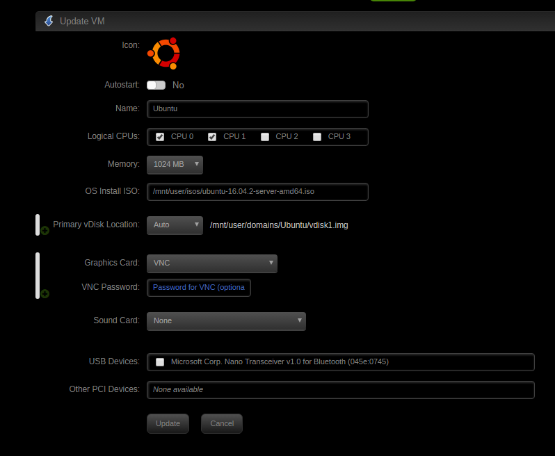

Hi I'm new the unRAID and I have this very same issue with looping through the installation, again and again
Can you tell me where I could change to seabios instead of ovmf
This is the setup options I see
You can't on the update screen, you have to change it on initial creation. Make sure you toggle advanced view.
Thanks @jonathanm yes just realized that, and I'm creating new one,
Thanks again
