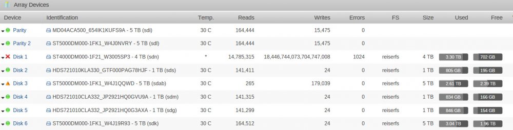

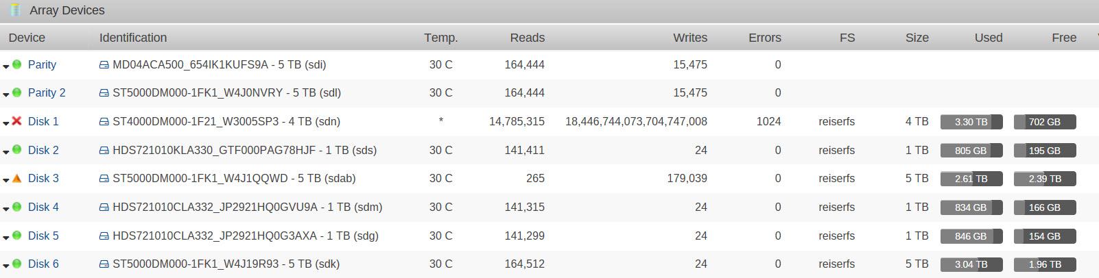

So, I started the rebuild, looked like it was going great...until I noticed one drive was building fine, then the second drive seemed to be showing an issue of a few writes too many. I stopped the rebuild, pulled out the drive, ran a smart check and a short smart check on it with success for both...Any idea why this would happen? Is this a possible cabling error that would show up after several months of working fine? The controller uses SFF-8087's to put multiple drives on one port, so I would probably lean away from the controller having issues. I am preclearing a drive just in case right now. Should this be my next direction? Does this diagnostics tell why?

Disk3 dropped offline, could be cable/backplane issue or a disk problem, if SMART is fine swap cables with another disk and try again.

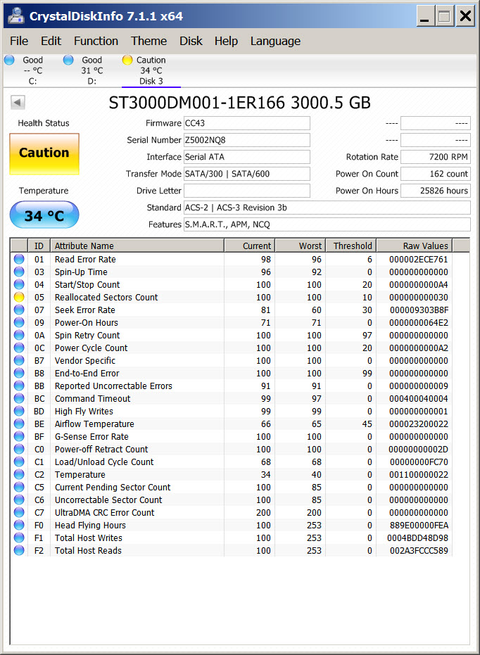

When i pulled the smart stats from drive 3 on another system, it showed some bad numbers, but still said it passed, I tried Crystal (attached and it showed at least some warning)...The drive did make a strange noise, so I'm leaning towards a creepy bad drive. I have a fresh 5TB drive that's been cleared that i'm going to swap in and do a rebuild.

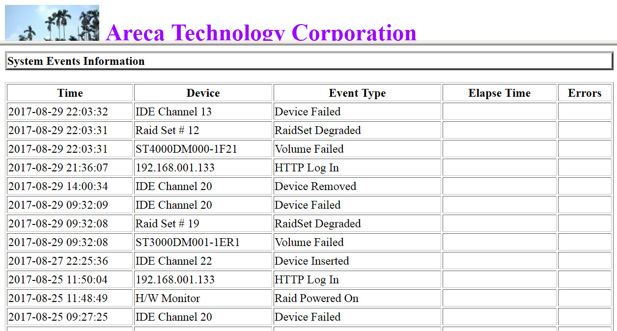

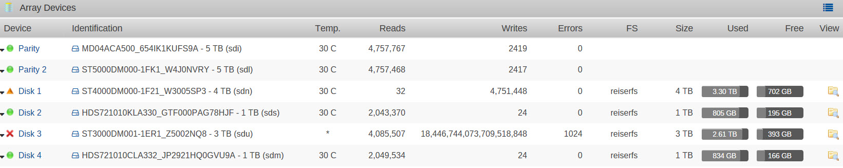

WTF!....ok, so I installed the new 5TB pre-cleared drive, and passively started watching the rebuild to see if the new drive or the old drive go to pluto...I then witnessed the "writes" column of drive 1 go from about the equal size of the new 5TB drive, to the pluto (18 x 10 to the 18th!) instantly!

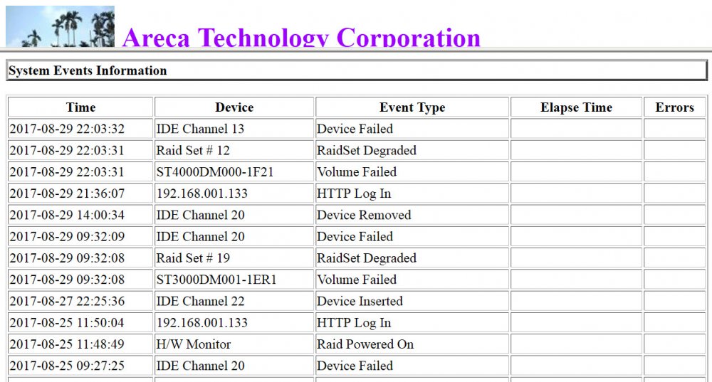

The controller is dumping the drive when this error occurs, so I would guess that it isn't an issue with a driver or unraid itself. The two drives are on different port of the controller card (and a different set of SFF-8087's). What's fishy is that the two drives are jumping to almost the same massive number + the number of actual writes it had when it went to pluto...This time, the areca isn't even reporting any read (or write) errors and just saying that the device failed (attached)!

3 hours ago, bsim said:
Why the gigantic number of writes reported to unraid?
These gigantic write numbers are normal when a device drops offline, either when it's a bad device or a controller dropping disks, so these are normal in theses situations, you just need to find out why they're dropping.
