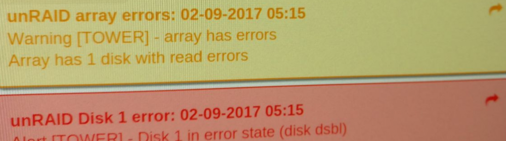

This is the error I get on unRAID
Rebooting the machine has resulted in that drive no longer showing up (slot 1 will no longer be assigned, and the drive cannot be assigned to slot 1 again since it doesn't show up).
I've tried multiple reboots and it simply stops showing up after I get that error.
So I have assumed that meant the drive had died.

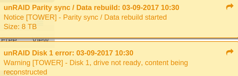

powered down, swapped sata cable (swapped ports with another drive too), unplugged and plugged the power cable, powered back up. the disk shows up as assigned now.
I stopped the array, assigned it back to slot 1, started the array again and we'll see if it behaves better this time around.
I imagine you don't need logs now since it has been assigned again. But let me know just in case. I'm surprised it's having to do the parity sync/data rebuild, since it still says 6TB used on the drive. So all of the data should be there
