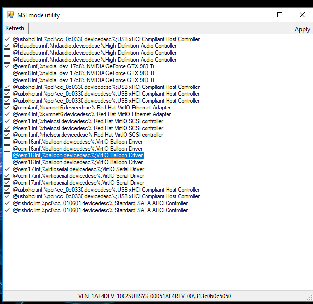

The MSI tools reports me this but I am not sure what to select, and what it does
Edited by Thomas van Dalen
16 hours ago, Thomas van Dalen said:
While you were writing this i finally got my first usb controller working in vm, full pass trough. Swap usb does work now and the sound stutter is gone at boot. Will test the delay and gaming later on this week. Anyway thank you! you were point me in the correct direction
Anywhere you see a tick the msi interupts are enabled.
So tick anything that mentions your sound or graphics card.
You will notice your 980ti has 2 boxes not ticked tick those and the 2 for the high definition audio device then click apply.
leave everything else as it already is.

I didnt tick it and audio seems ok now, will monitor the youtube audio sync this week
