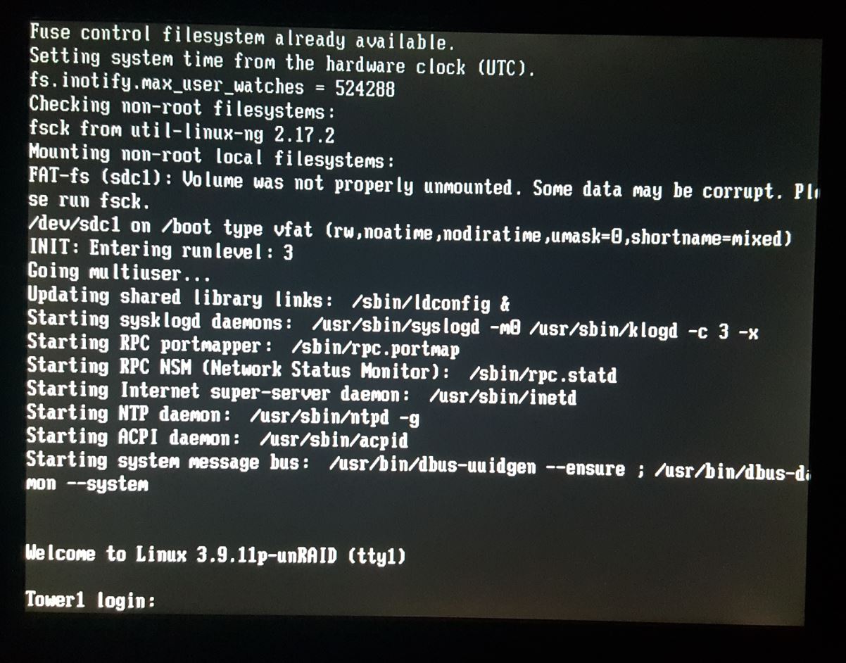

September 9, 20179 yr Hi Everyone, Have been running unRaid now for over 10 years, I have my first problem. After a 4hr house power supply failure 1 of my 2x 40Tb towers is not running. Boots properly I can see it get to Tower Login. But I am not able to access over ip to start the array. Can not reach this address is the message. I am running 5.1 on this Tower. Running 5.0 on the working Tower2 I do see an error message on the screen, which I have attached. Appreciate any help or advice on how to fix as I have never had to get under the hood ever before.. Much appreciated Steve

September 10, 20179 yr Call trace after call trace. Unfortunately, I don't know what they're relating to. You could try copying the bzimage and bzroot files from the working flash to the one thats giving you problems and try again. Barring that, I would try another flash drive, set it up as 6.3.5 trial and see if that boots up.

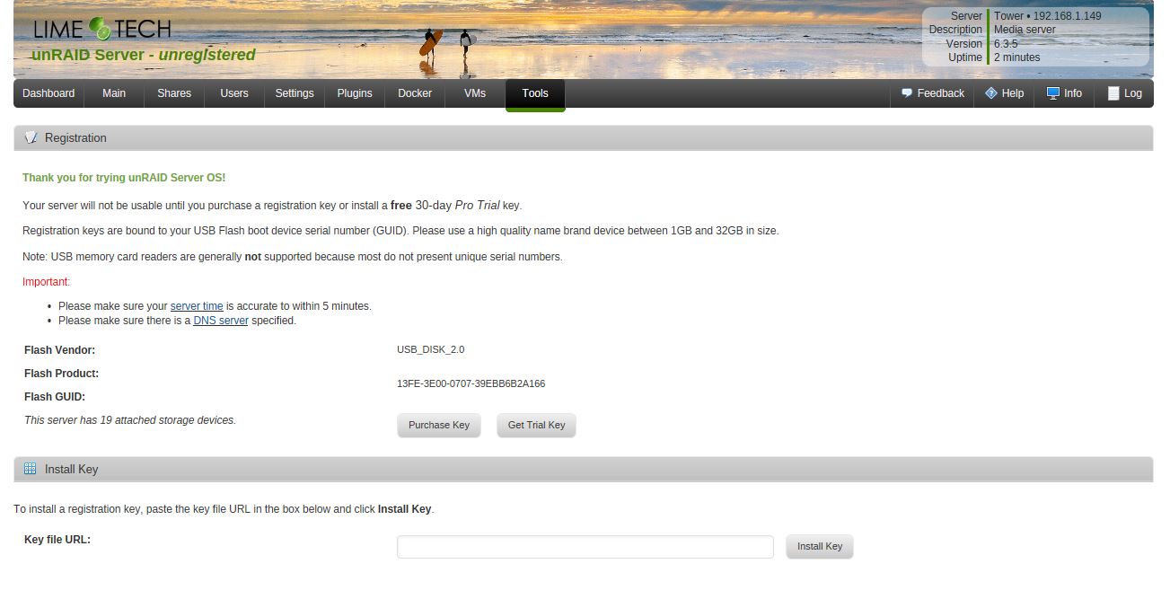

September 10, 20179 yr Author OK, got away for 5 mins, I can run 6.3.5 and was able to see through the ip address the interface. This is on a new usb stick. see photo. So what is the best steps to take now?? Upgrade??

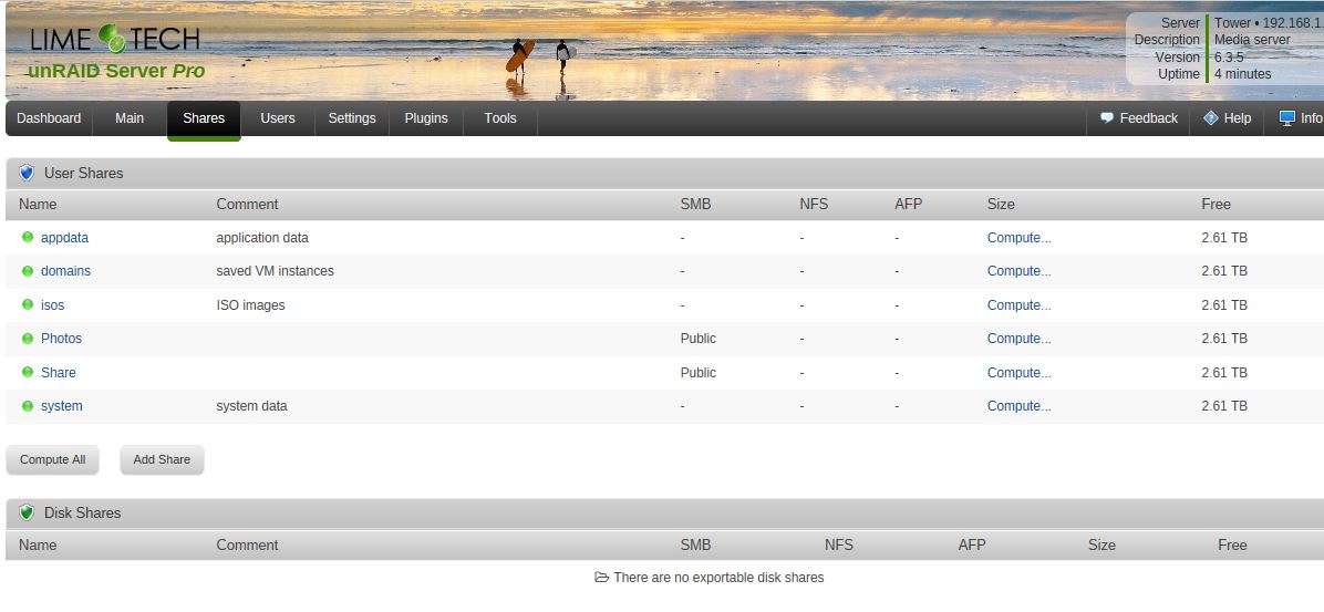

October 5, 20179 yr Author Hi Guy's, Wanted to drop in to let you know all is back up and running. No data loss which is a huge relief. Much appreciated your help and patience. I do have one last question as I can not navigate to the individual disks. I can get to the Share folder and see the combined data of all the disks. In settings I looked at everything. Enable disk shares is set to auto, Enable user shares is set to Yes, Included disks is set to All. After changing my IP address, I did not turn the Docker back ON or the VM Manager. Do I need to??
October 5, 20179 yr Enable disk shares is set to autoChange to yes, but you need to be aware of the user share copy bug.
October 5, 20179 yr Author I self answered again, Sorry. OK, I finished watching the Initial Setup Video, and saw set to Yes, Seems changing The Auto setting to Yes fixed it. Thanks for your help.
October 5, 20179 yr Author Just now, johnnie.black said: Change to yes, but you need to be aware of the user share copy bug. Please point me in the direction about this bug. Much appreciated
October 5, 20179 yr https://forums.lime-technology.com/topic/32836-user-share-copy-bug/ Basically copy only from the same type of share, i.e., from disk share to disk share or user share to user share.
