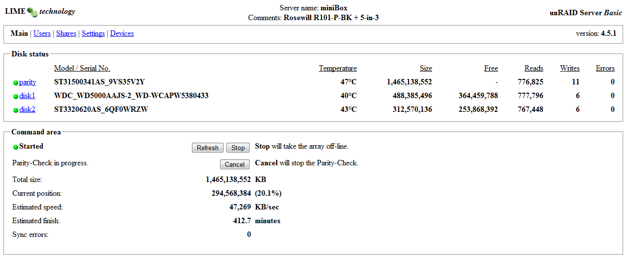

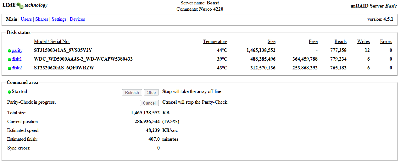

I'm pleasantly surprised by the results of my heat test.  I placed my three drives in the worst possible configuration - parity in between the two other drives, left the two right-most slots empty - and ran another parity check.  The temperatures climbed pretty quickly as before, but the peak temps I saw were much lower, 47 C on the parity drive being the highest I saw.  This gives me hope that just a bit of work, such as controlling the airflow better, organizing the cables, etc., may give it just enough to stay in the adequate range.  Of course that may all go out the window when the cage is populated with 5 drives, who knows.
