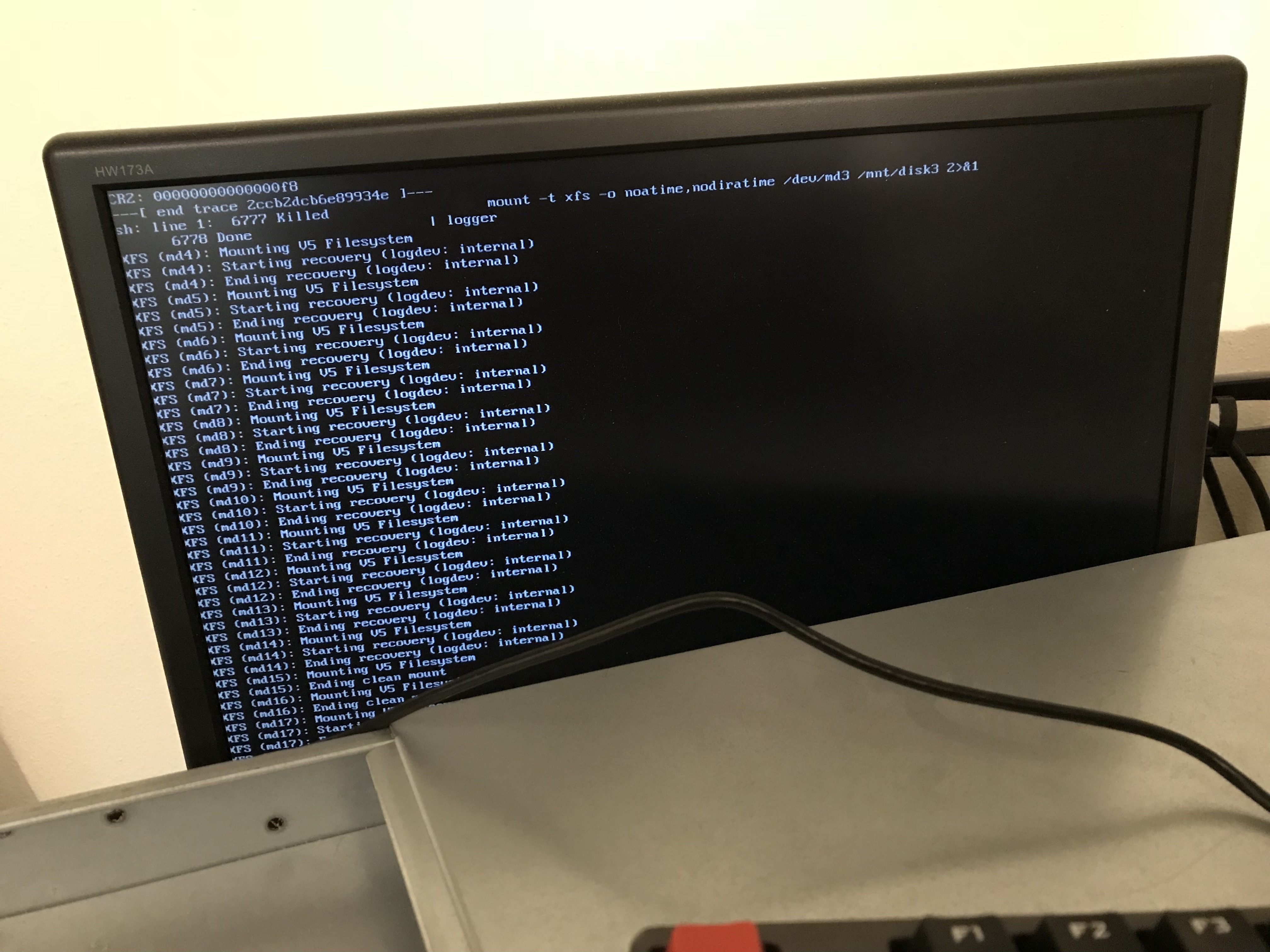

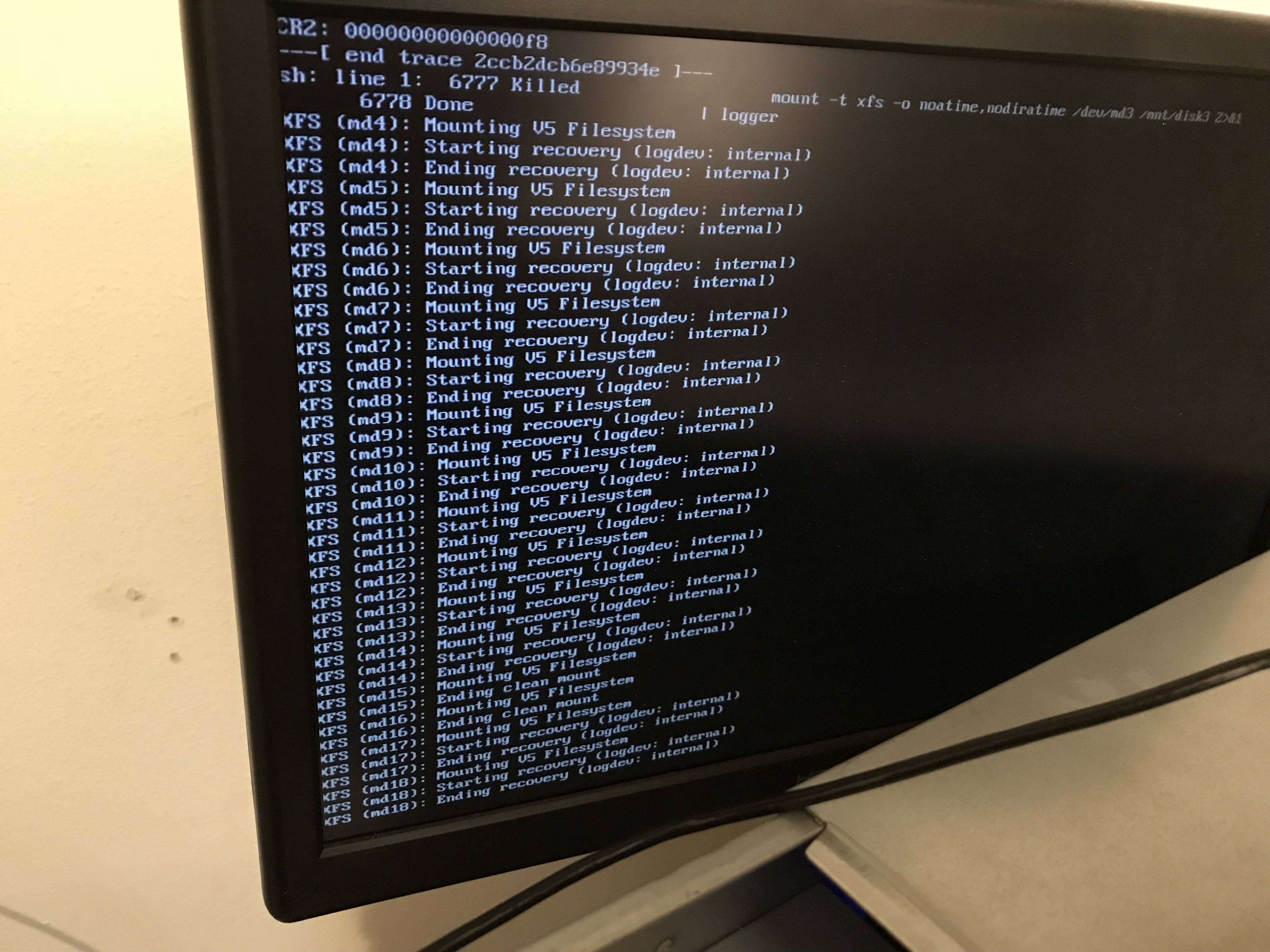

I feel like I'm chasing gremlins.  The first problem I noticed was when trying to update docker programs there would be an error and I could no longer open or update them.  Now I can only get the UI to load for safe mode.  Drives look ok on the dashboard.  Attached are log files and a bad picture of what  is displayed when I mount the drives.  Not sure if it is being picked up in the logs.

Based upon the pics though, it would appear that disk3 has corruption on it though, and you'll need to Check Disk Filesystem
