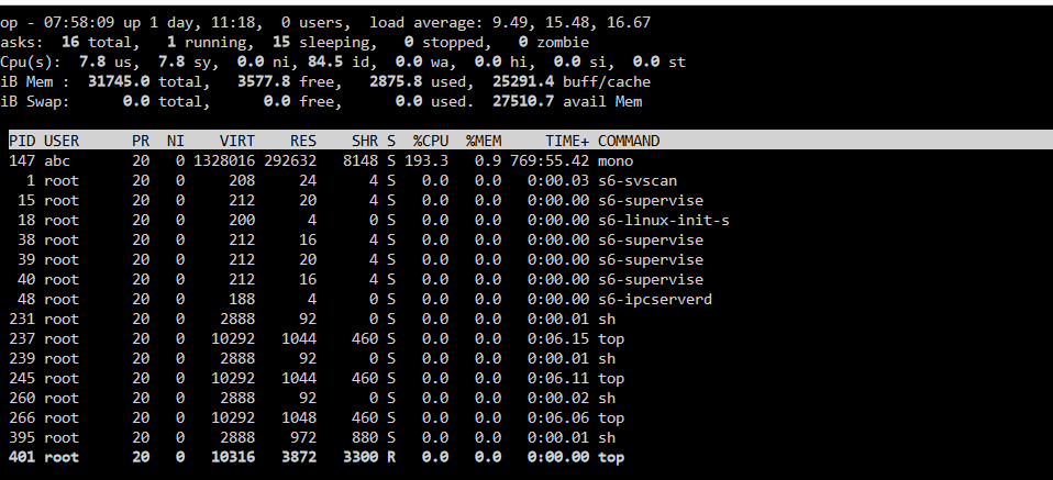

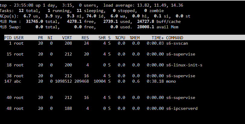

I noticed that when I run top in CLI, mono is running at 100%.  I've narrowed it down to Sonarr causing it, because when I stop sonarr, mono goes away.. or at least stops running at 100%.
I checked the logs in Sonarr and it doesn't seem to be doing anything... actually it's pretty idle(no downloads, no scanning..) when I checked, but no matter what Sonarr seems to be doing, it causes Mono to run at 100% from the second I start it up, and runs at 100% for days on end.

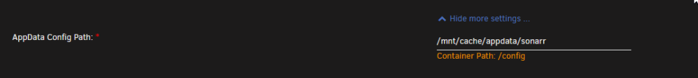

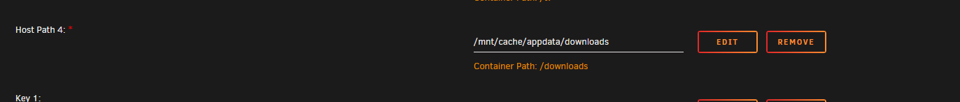

You can try setting the appdata path for sonarr to instead of /mnt/user/appdata to directly reference /mnt/cache/appdata (if appdata sits on a pool named "cache")
Hi I am having the same issue,
I have tried setting the path to the cache /mnt/cache_nvme/appdata rather than /mnt/user/appdata but still see the 100% usage on a single core, I am unable to find any info in the support thread either unfortunately.

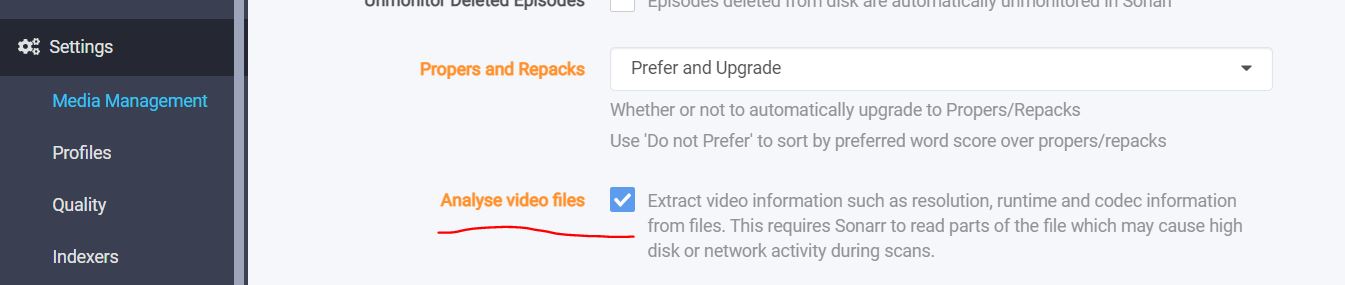

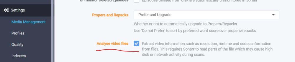

I managed to figure out that unticking the "analyse video file" stopped the 100% cpu.
Mono was a red herring, its just the process this uses.
Thank you for all you help. I don't have any cache setup at the moment, I do intend to do this at some point. But I have just done as @ravepants mentioned and unticked Analyse Video Files.
will monitor and report back.
Its already looking promising but this creams up over the hours and the fans kick in. So will let it rest for the day and see how it holds.

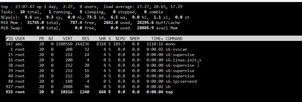

UPDATE----
Sadly no fix for me. After leaving it for 12 hrs the CPU has risen again. I placed Sonarr on the CPU 15 and 31 to monitor and its already hitting 85%. If I don't restart Sonarr now the fans will start blowing.
Back to the hunt to find solution.

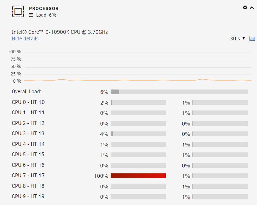

Think I have something that looks the same.
Two times I have confirmed that by shutting Sonarr docker down my CPU (all 8 cores) go from plus 90% to 0-20%.
Both times, after i boot Sonarr the issue seems to be gone.
I'll be more than happy to bring any info if it can help finding the issue
I have taken the good initiative of pinning the CPU for Sonarr, as this at least isn't taking all of my 8(16) cores :)
Also I am using "cache"
@Squidwas right (again) - at least for my case
It helps a bit if i use my eyes and look at the right setting.
CPU is doing just fine now
