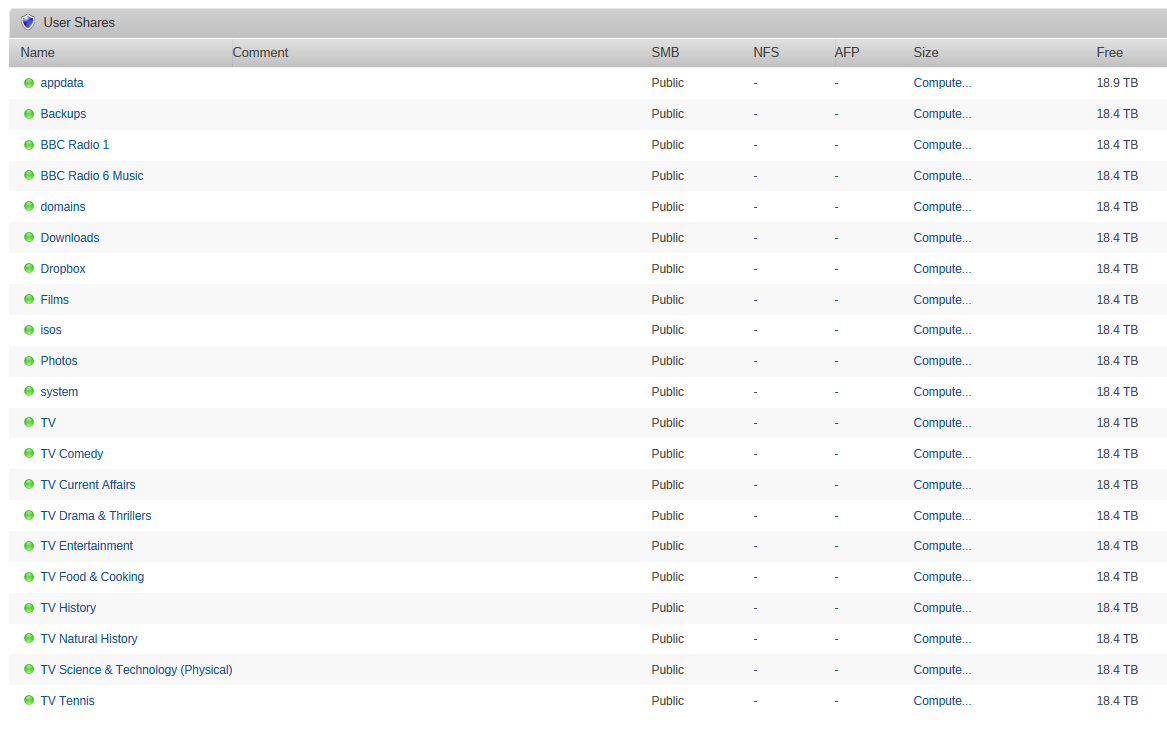

Ok I've copied over the plugins folder and now get a warning
"Fix Common Problems: 12-10-2017 14:29
Warnings have been found with your server.
Investigate at Settings / User Utilities / Fix Common Problems"
Warnings Found Suggested Fix
Share appdata is an implied array-only share, but files / folders exist on the cache Set Use Cache appropriately, then rerun this analysis

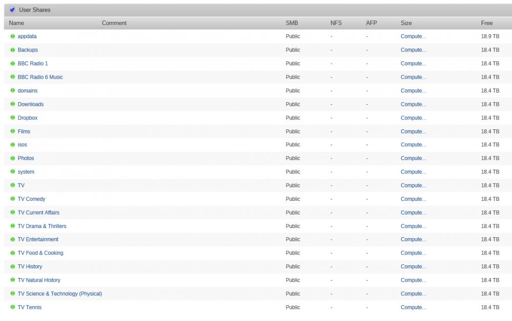

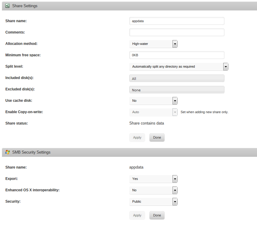

I'm not sure what I need to do. I've attached two screenshots, the first one is all of my User shares and the second one is of appdata settings.

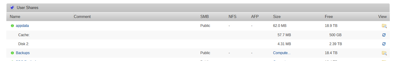

Usually the appdata share is set to cache-prefer or cache-only. What do you get when you click Compute... for appdata on the User Shares page?
I've set it to "prefer", I've a sneaky feeling that's what it was previously.
As for the sizes, I've attached the updated screenshot.

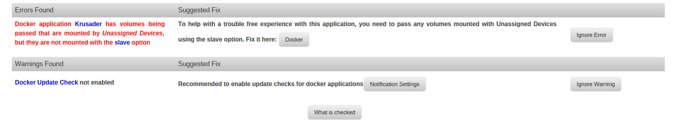

Running the system check again I now get errors and warnings as per the first screenshot. I'm totally bewildered I don't remember having to do any of this when I originally installed them.

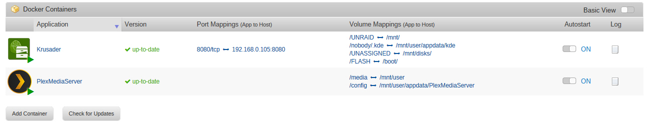

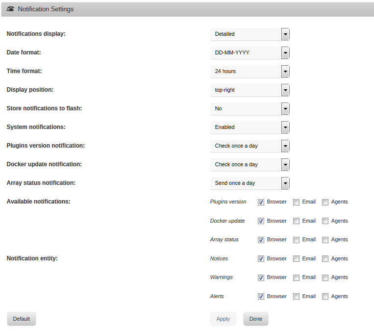

I've also attached screenshots of the current Docker containers screen and Docker Notification Settings. As you may have gathered I don't have a clue as to what to do with this lot, LOL.

If you have changed the appdata Share setting to Cache ‘Prefer’ then you need to run mover to get any files on the array relating to that share moved to the cache.
Hmm no change. :-(
2 minutes ago, soulman1949 said:
Hmm no change. :-(
Do you mean you ran mover and nothing changed?
Do you still have appdata files on disk2? That is the only thing running mover might have fixed. If you do still have appdata on disk2, try stopping your dockers and run mover again.
As for Krusader, you will have to edit the Krusader docker settings and change the UNASSIGNED volume to use slave mode. You will probably have to go to Advanced view.
Ah, that sorted it, thanks.
Sorry I don't understand what you mean. I tried to delete this and start over but ended up screwing the settings. I've tried to reinstall it but it's asking me to enter something in Host Path 1 and presumably Host Path 2.
