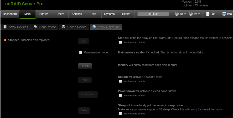

My problem started while I was moving my existing drives, one by one into a new 5 in 3 trayless cage, and running a parity verification in between each swap to make sure each drive worked properly, before I got 5 drives  jumbled together.  After the 3rd swap, I had an issue where the array wouldn't start( drive2 aka sdg was absent, resulting in the red square DISK_DISABLE_NP. So I shut down, and I replaced the cable.  Upon power up, got the blue dot and assigned the drive to same array slot.
I believe there's no real problem with any of the drives at this point.
Now, I want to restart the array, and run parity without corrections, just to make sure I don't have any other problems, before i go writing anything to what should be an error-free array, but my screen only shows Start as "bring array online and Rebuild parity",  But I definitely don't want to rebuild parity until I'm double sure I've got all the drives where they belong, and fully operaional.  My screen only offers me the options in the screenshot below..
so how can I safely just start the array and only verify parity without writing to the array?

Take a screenshot of current assignments then go to Utils -> New Config
Then reassign all disks and check "parity is already valid" before starting the array.

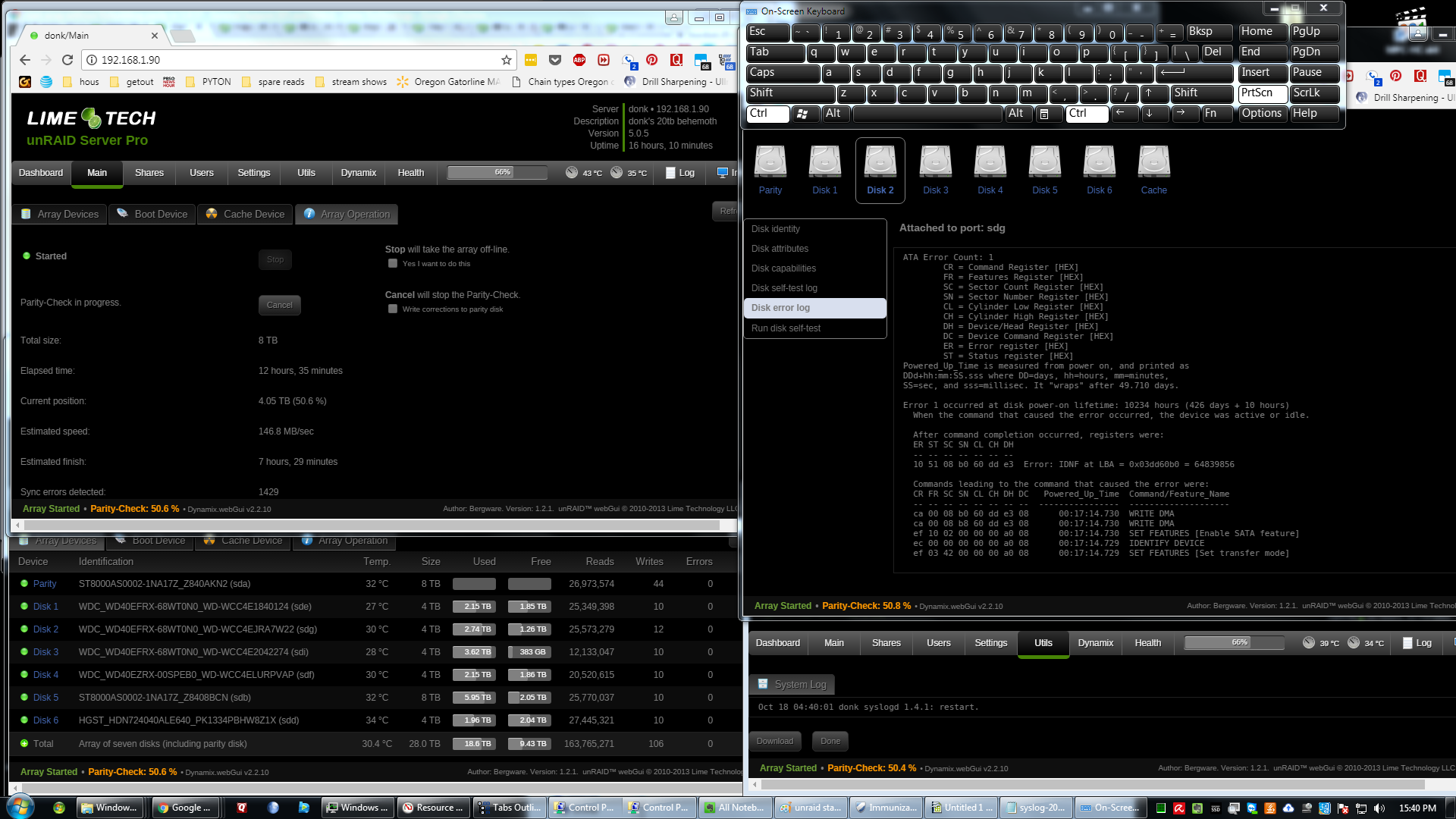

I did the above and as it started the parity verify , I immediately got 1007 errors, and 106 writes to the array as shown below.   These numbers stayed steady for about an hour, before I let the verifying continue while i slept.  Now at 49% with 1381 errors.
Another oddity, is that there is no syslog except, for one line showing the restart.  This is odd, because when I saw the initial errors, I check the syslog last night, and it showed that they happened in the first 1-2 secs of the scan. I check the flash/logs directory, and there is no files there for this restart of the server, based on timestamp of when i know i restarted it
also there was one disk error, which I believe  happened before this reboot, when the cabling was questionable.
This is my backup server, meaning I don't have a backup of it. So is there an easy way to tell which files on disk2 correspond to the parity errors? if not, how should i proceed?
Only if you have checksums, if not only way would be to compared them with the ones from the other server, note also that a few sync errors don't mean there is file corruption for sure, they can be related to filesystem housekeeping.
If you don't have checksums and it's not easy to compare the files with the other server best bet would be to correct the sync errors.
