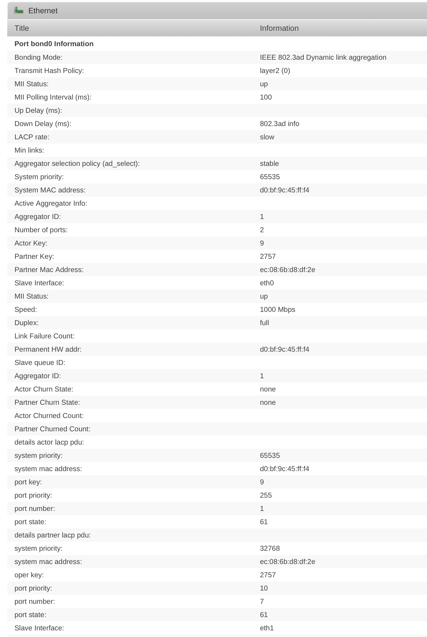

November 8, 20179 yr Author I have had that settings for a long time but when I check unraid it shows the (LACP rate: Slow) and I only copy files via network at 30-45mbps Edited November 8, 20179 yr by Lee B
November 8, 20179 yr Can you show me a screenshot of the “LACP rate:slow”?A single copy won’t be able to use more than a single link. That being said, what’s your UnRaid config look like? There may be a disk bottleneck going onSent from my iPhone using Tapatalk

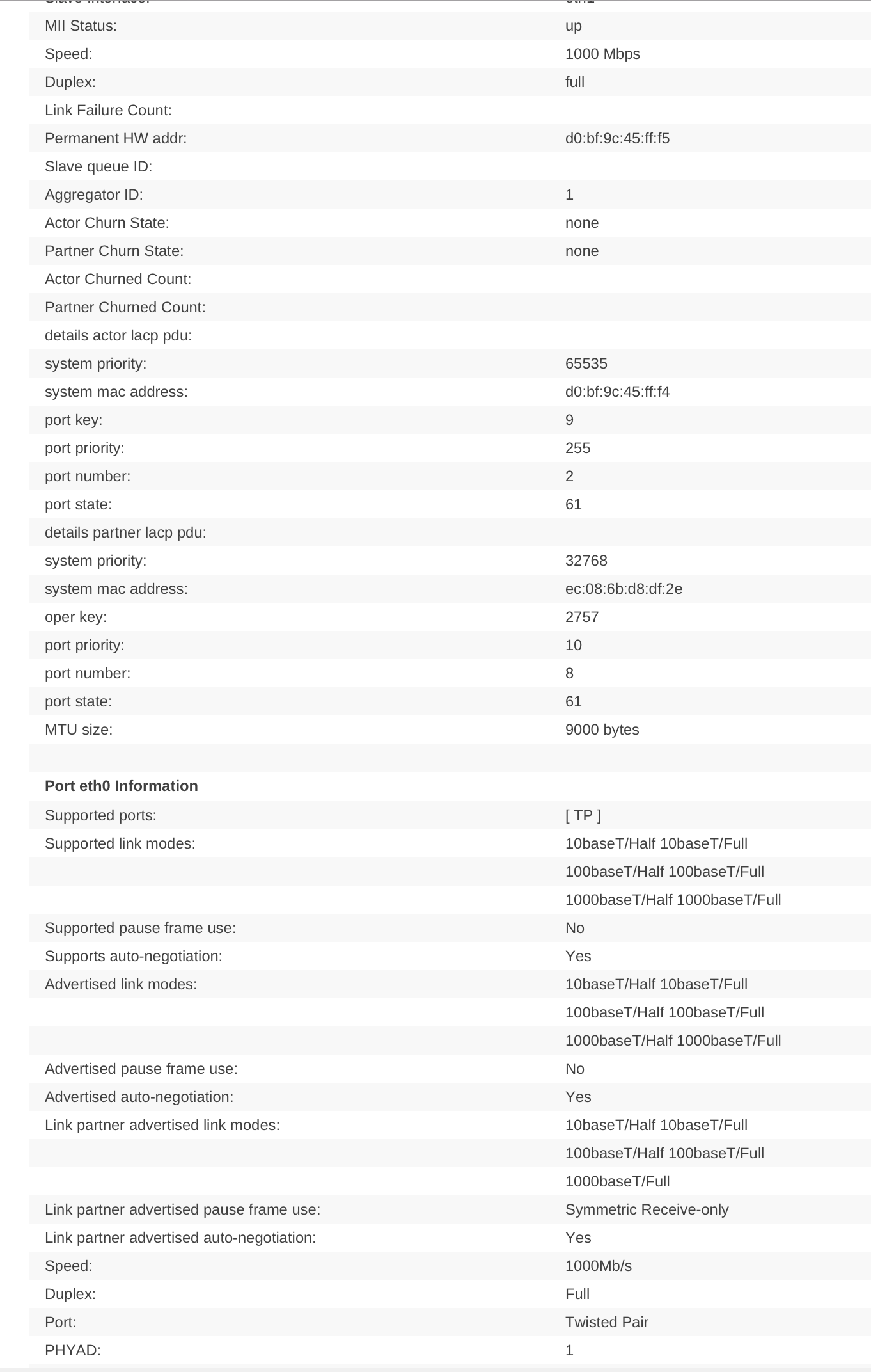

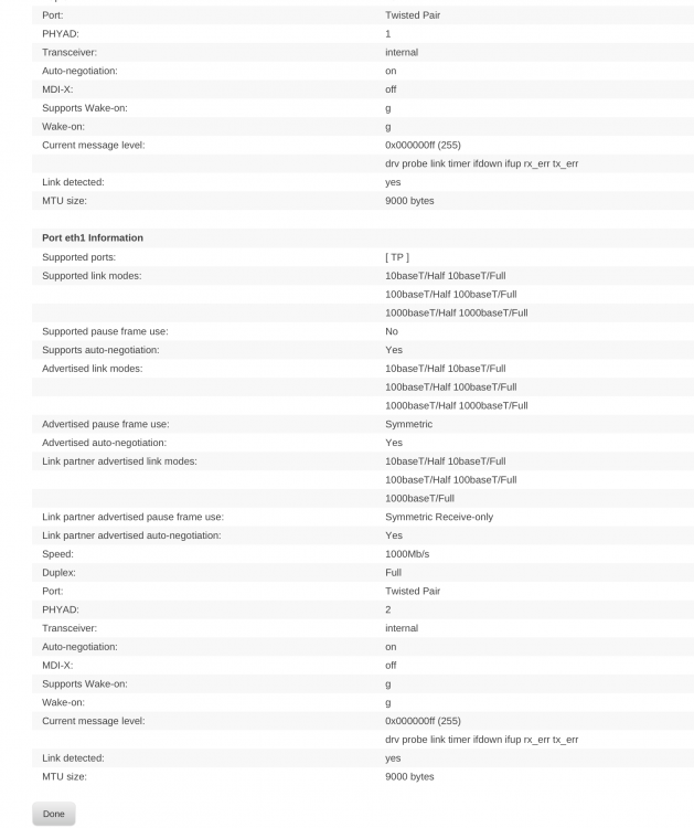

November 9, 20179 yr Author 1 of my drives says its SATA Version is: SATA 3.1, 6.0 Gb/s but -> (current: 3.0 Gb/s) any idea why this would be? Attached in of the network settings
November 9, 20179 yr Possibly a bad cable?Can you please post diagnostics to the thread for reviewCheersSent from my iPhone using Tapatalk
November 10, 20179 yr Author 21 hours ago, miniwalks said: Possibly a bad cable? Can you please post diagnostics to the thread for review Cheers Sent from my iPhone using Tapatalk What diagnostics do you want? where do I do it?
November 10, 20179 yr 6 minutes ago, Lee B said: What diagnostics do you want? where do I do it? Tools>diagnostics Download the zip and attach it to your next post. Be sure to select “anonymize”.
