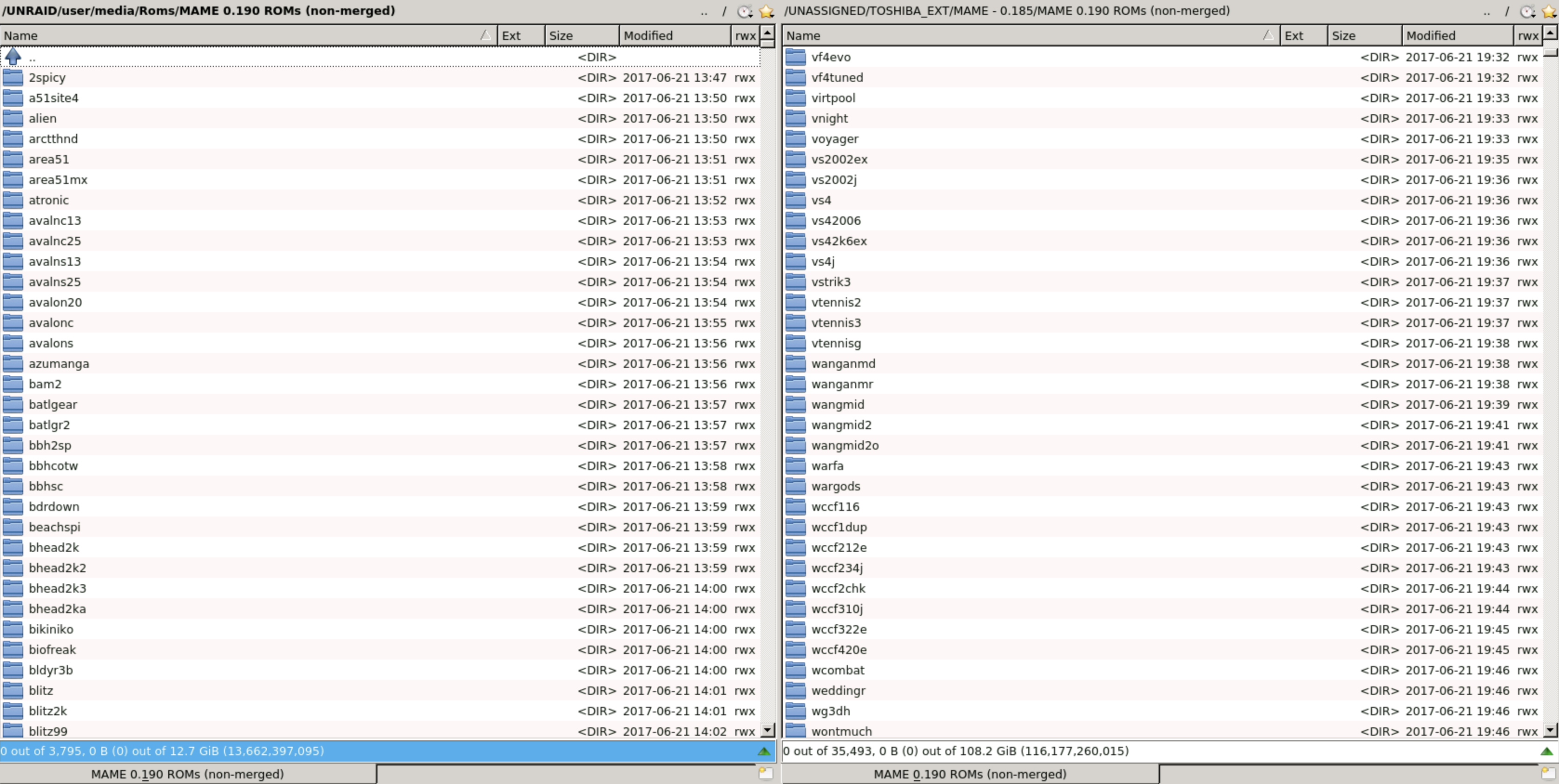

I have been trying to copy my MAME roms from my external USB hard drive to my array using Krusader.

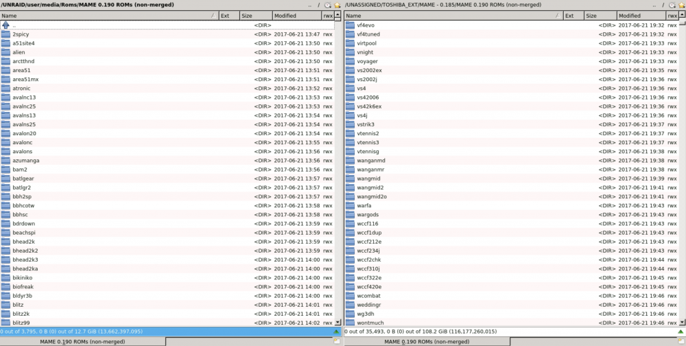

I'm trying to copy a folder with 35,493 files in it however, when I copy it to my array, it says its finished, however, the folder on the array only has 3795 files?  Please see attached screenshot showing this.

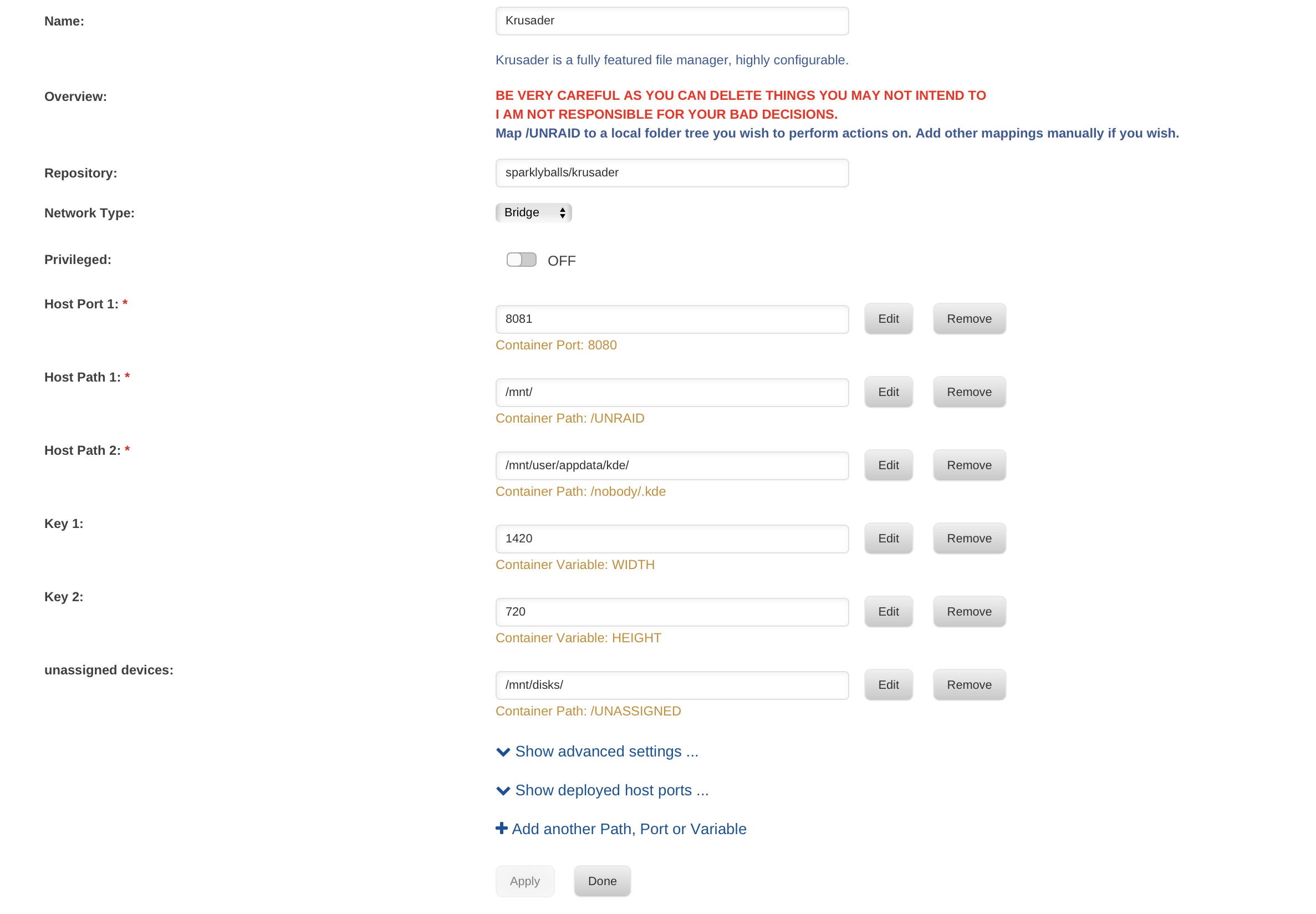

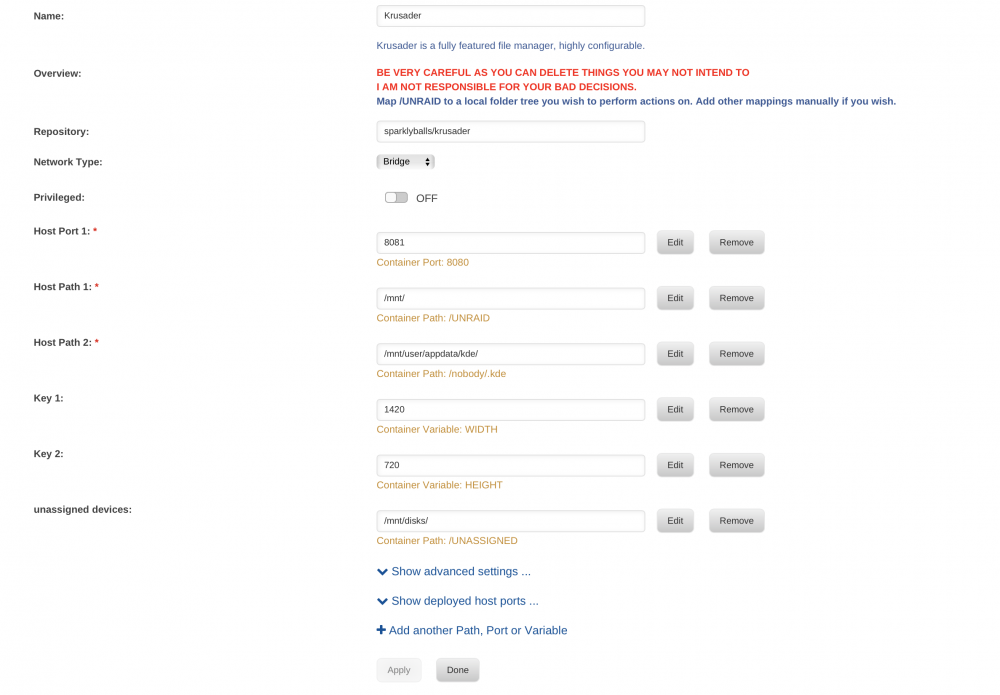

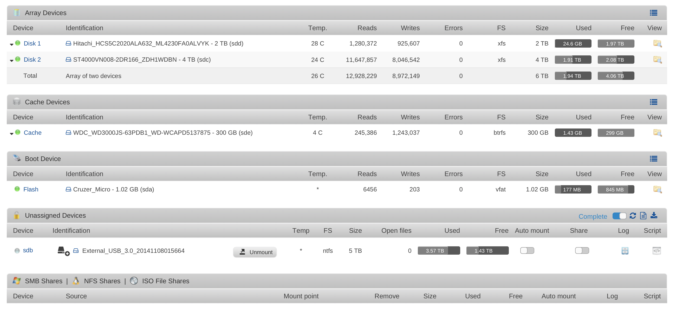

I've also attached a screenshot of my array setup, and my Krusader setup.
Any ideas where I'm going wrong, and where those missing files would be?

For very large number of files like that, you are better off using command line from the console.
Use cp or rsync commands with verbose option and save the output text in a file to help you review what files have been copied or not.
Also dealing with ntfs partition can be quite unpredictable in my experience but do the above first.

i agree use CLI or just do a screen's worth at a time, which will take some time.
