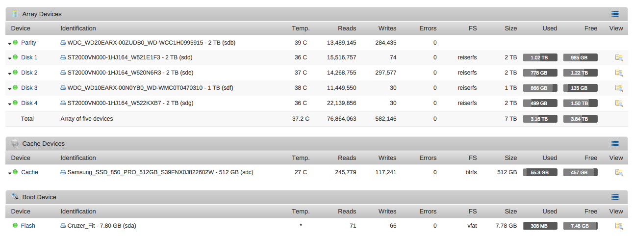

What is your file system? ReiserFS?
Yes, reiserfs (please see the screenshot)
There are others here more familiar with ResierFS and it's repair commands, although I am not sure that is going to help you. You should know, that ReiserFS is a dead file system and is no longer being developed. You should consider migrating to XFS.
