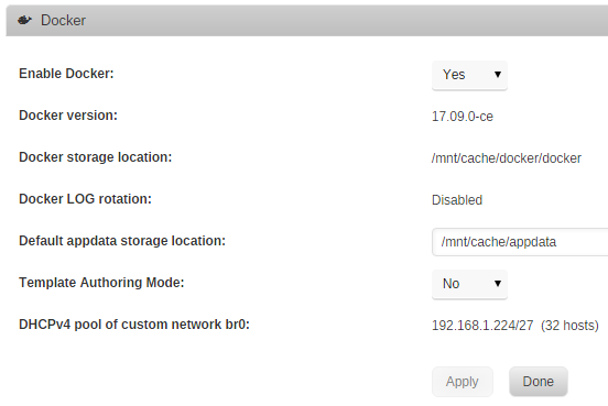

I moved my containers to their own IPs last night binding them to eth0 as I didn't have bridging setup.  All worked well except for kodi-headless as the sources are SMB which doesn't seem to work.  I assumed this is because the new setup stops any access from a container to the host server.
After a bit of reading I enabled br0 in the unRAID network settings.  All good.  Went to the docker settings page and input the range of IPs I wanted for the Dockers and it all started fine.
