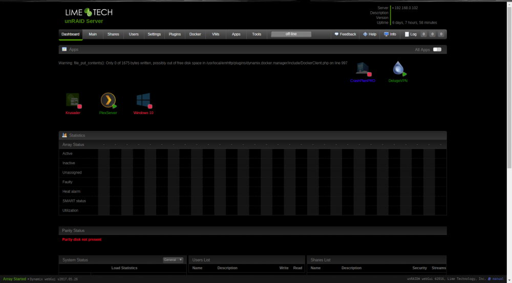

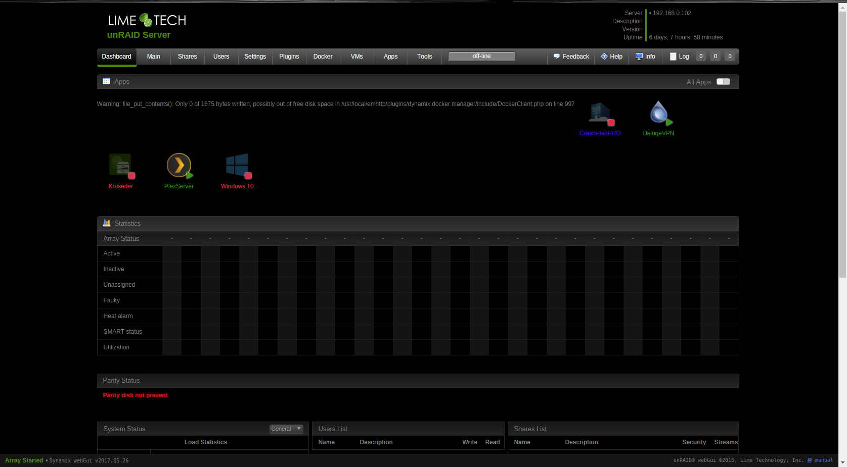

I've been using unRAID for for a few weeks and have not had a problem. Today I log in and the array is not started or accessible and this message is across the top:
Warning: file_put_contents(): Only 0 of 1675 bytes written, possibly out of free disk space in /usr/local/emhttp/plugins/dynamix.docker.manager/include/DockerClient.php on line 997
I tried accessing logs but it eventually times out.
Is my USB bad? What should I do?

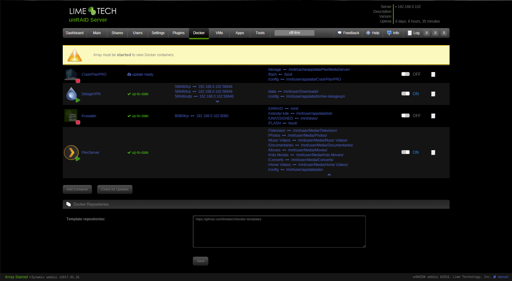

The root file system is full.   I would expect it to be more like 5% used or less.    That suggests you have a docker or something similar that is configured incorrectly and is thus writing files to RAM rather than a physical drive.
Does this screenshot help?
