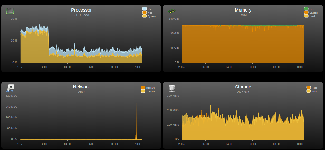

Any recommendations on how I could speed them up?  12 hours in, and I'm only 7 TB into the copy...  I won't probably interupt this copy, but have to do it again on the other server which has 24x 2TB drives. (which I can load in the server all at once)
CPU / Memory and of course Network IO are flat idle on this server.
Here's a 24 hour Graph attached... You'll notice 26 Disks because of the 10 SSD's installed for cache (but not in use yet)

Do you mean they all are copying to the same user share? If yes that's pretty good, only way to get more would be to copy directly to different disks bypassing the user share.
Yes.... the "user" share, but different folders underneath, and all shares are sharing all drives...  So I guess I would expect a "striping" type performance which would be much higher, in the GB/Sec perhaps even.
unRAID doesn't stripe data for data disks.

True... Stripe - like in that for each file, a different drive could be selected...   especially since I'm using the "most-free" allocation, and all the drives were empty when I started.
I have 4x 12GB/sec capable LSI 9305 controllers in the box, I'm just surprised I'm not getting faster disk to disk copy speeds...

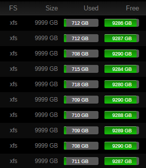

You may be able to get a little speed bump if you select most free for that share allocation method, some times, but not always, files should go to different disks, this can be only advantageous when running paritless, with parity it will result in overlap writes to parity making it even slower than normal.
Ahh, yes.. -- I am at Most free -- I've edited my prior post to include that.
Yes but like I said it will only work sometimes, when at the beginning of that transfer the current disk being used as target is no longer the one with the most free space.

That is consistent with what I'm seeing.... Not "exactly" the same free space, but depending on the freespace at the beginning of each file operation, its selecting a drive.
