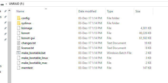

Ok I've attached the diagnostics zip file for you. One thing I want to note is that when I SSH in, I can see all of the boot and dev type folders but when I plug the USB into another machine it only looks like a fresh install without any of those files. I had to copy over the diagnostics file through SSH since it didn't show up when it was plugged into my other machine.
I also attached a picture of what I mean with the files on the USB. Maybe this can help diagnose things too.

This suggests that the USB stick may not be correctly mounting as /boot, so from the SSH session the files you are seeing are only in RAM.   Issuing a ‘df’ command from the ssh session will show if you have anything mounted as /boot.
