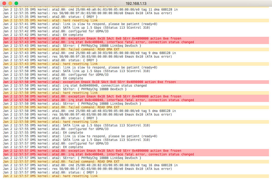

So my server has been running for over a year now without any issue.  Yesterday it started doing its monthly parity check and it was running extremely slow.  Said it was going to take 62 days to complete the check and only running at 750 Kbs.  In the past this check has only taken ~9 hours.  When looking at the logs here are the errors I am getting during the parity check. Are one of my disk going bad or is my controller card going  bad?  I am using the SUPERMICRO AOC-SASLP-MV8 card for my drives.  I have had 0 issues until yesterday.  thanks
ATA1 and 2 are on the onboard controller, try replacing cables or using a different ports.

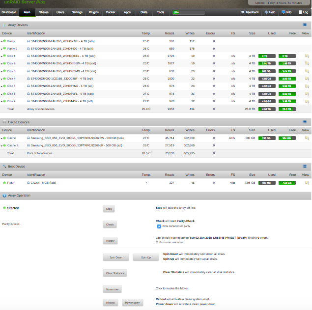

Also, after you get back to being stable, I'd consider removing 3 or 4 of those empty drives. No point in running up hours on drives you aren't using. Keep in mind that even empty drives are needed to do a recovery if a drive fails, so you are  increasing your failure points without really needing to at this point.
You would be better served keeping those drives ready on the shelf to replace a failed drive, or adding them back one at a time when you actually are ready to use the space.
All this assumes you have good backups already in place, if not, it's criminal to have those empty drives in the array instead of using them for offline backup.
that did it.  I removed all ports off Motherboard and using the card only.  I also removed 3 of the drive from the array and disconnected power from them.  The Parity is being synced right now @ 126.5 MB/sec.  Will finish in a little over 9 hours.   Thank you so much for the help
