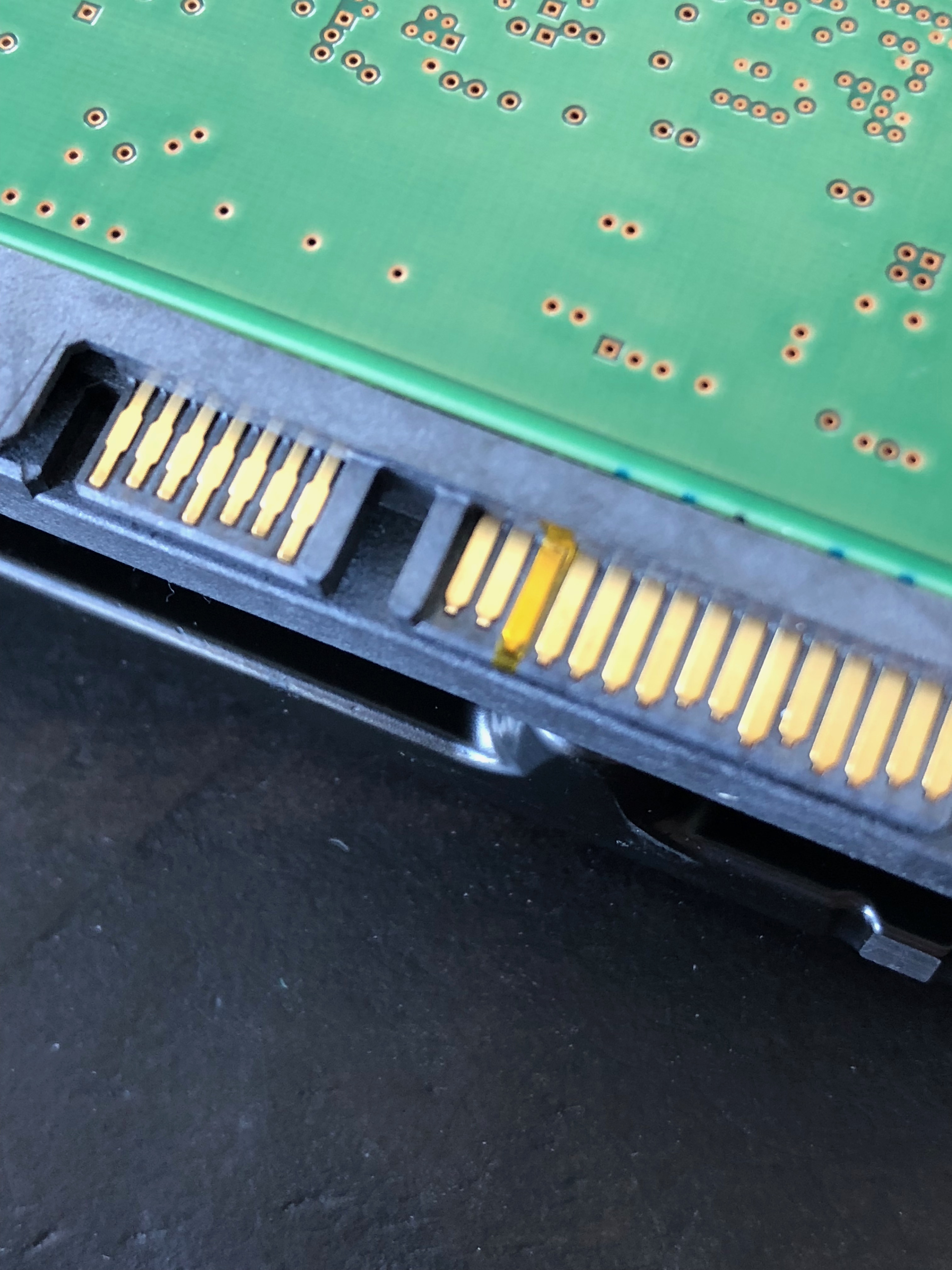

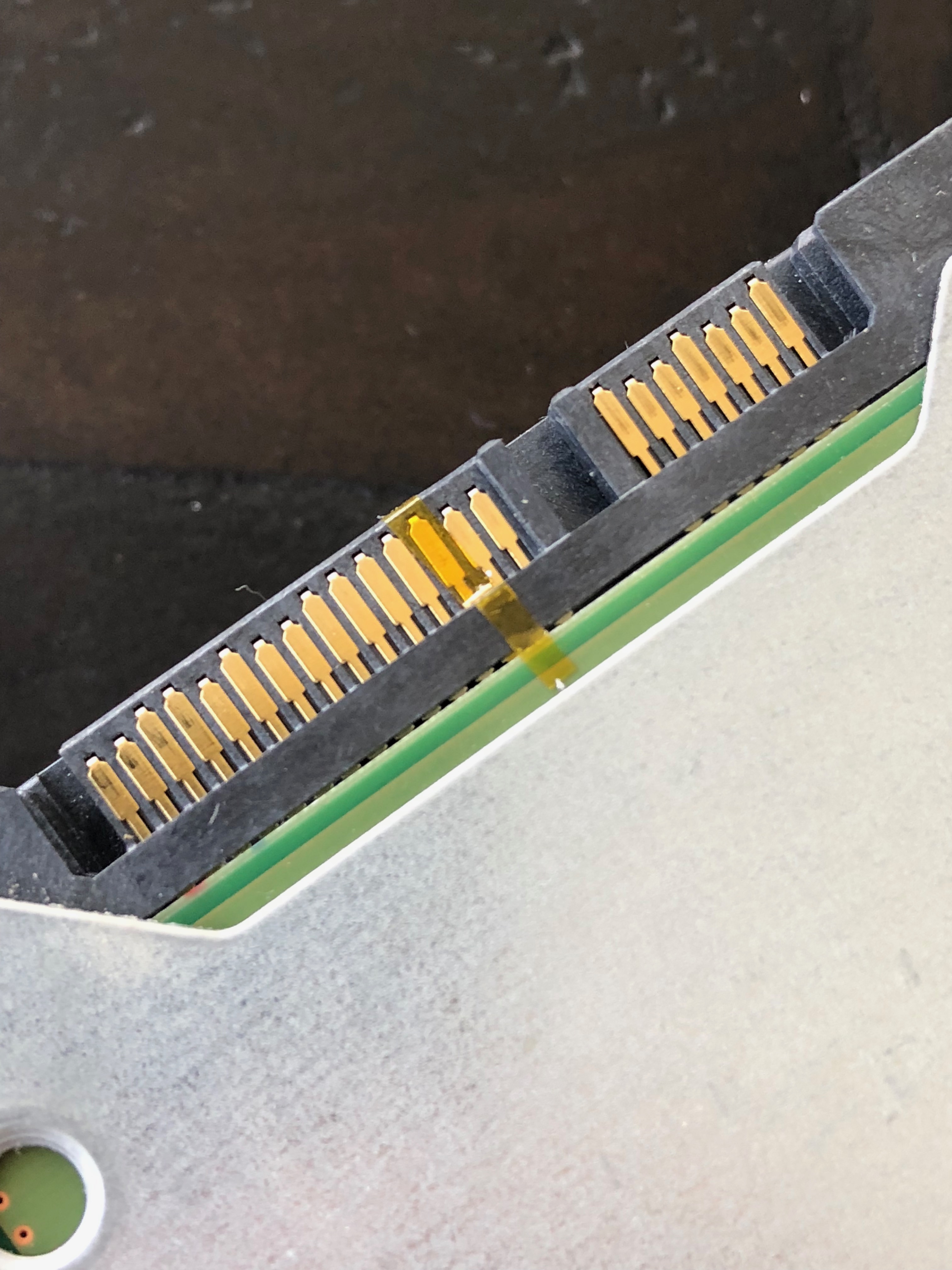

Ok. well if you have a Norco 4224 older model - not sure when they updated them...but when installing one of these power disable drives - they do not spin up.  Now I need to find a hack?  an adapter?  or see if Norco can sell me an updated backplane?
Anyone here can point me in the right direction?
This is the easiest and best hack.
On 1/16/2018 at 4:38 AM, jesseasi said:
put tape over pins.
Use Kapton tape, it's extremely thin, great adhesive, it's specifically meant to insulate connections. In short, it's meant for this type of application.
Well that was super easy.  I bought some Tapcon tape - arrived today - took me 10 minutes with some reading glasses and tweezers to cut and apply the tape.  Plug it in and spun right up!
