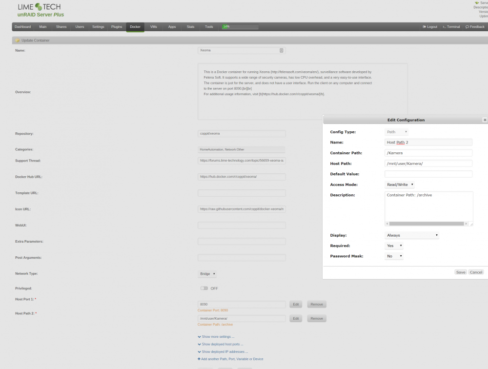

It seems like no one can help me here, so i wrote to support from xeoma, but they ask now: "Could you specify how exactly this drive is mounted in your system? Can you send us the exact commands you used?"
-> I use the user share (add share "kamera", cache: only)
What should i respond to them?

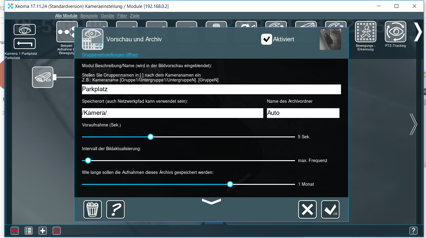

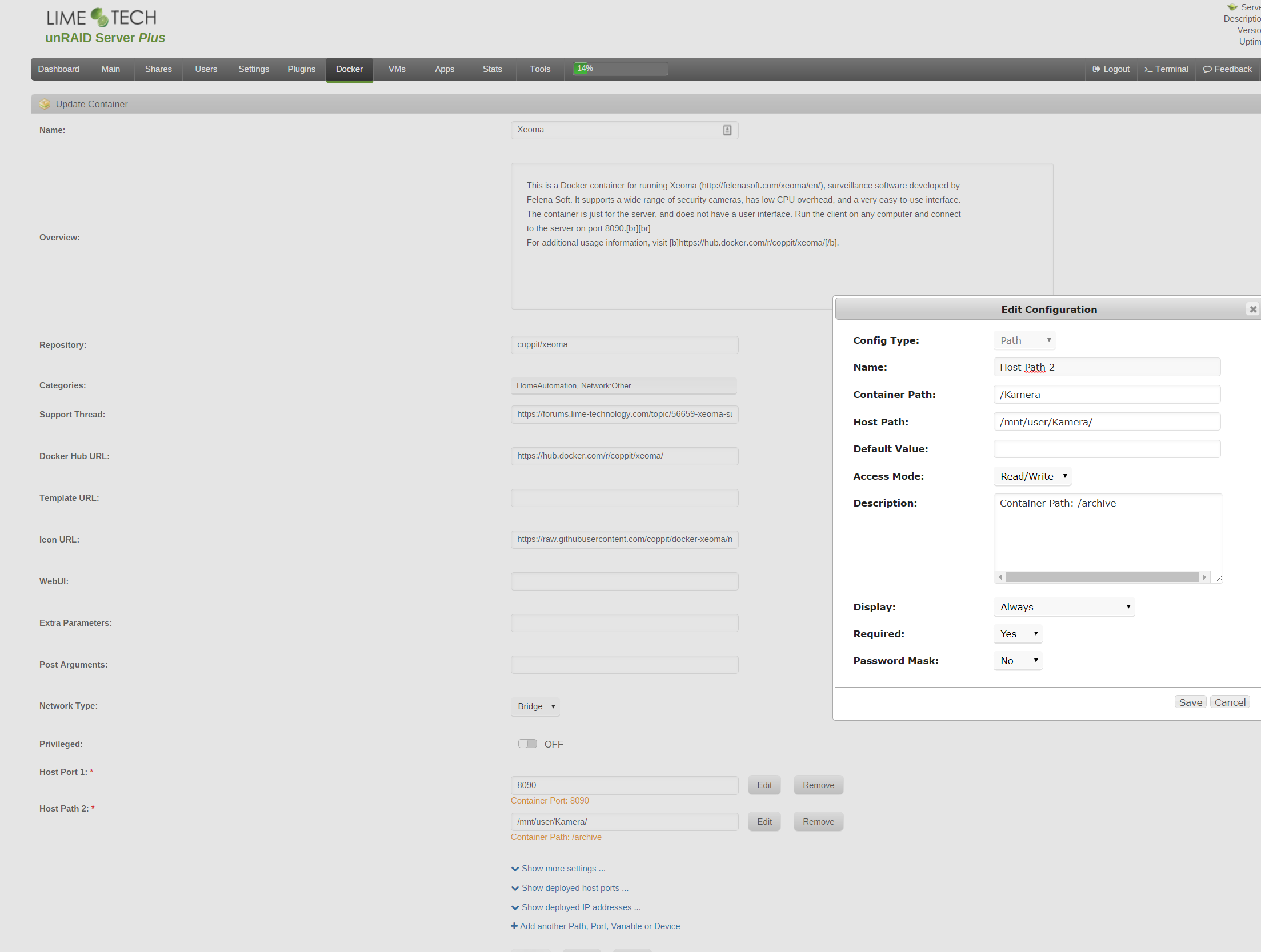

Is this correct?
Edited by nuhll
First is camera name,
then "root" for camera files, right is the name of the directory.
And its working, its creating files...
Edited by nuhll
