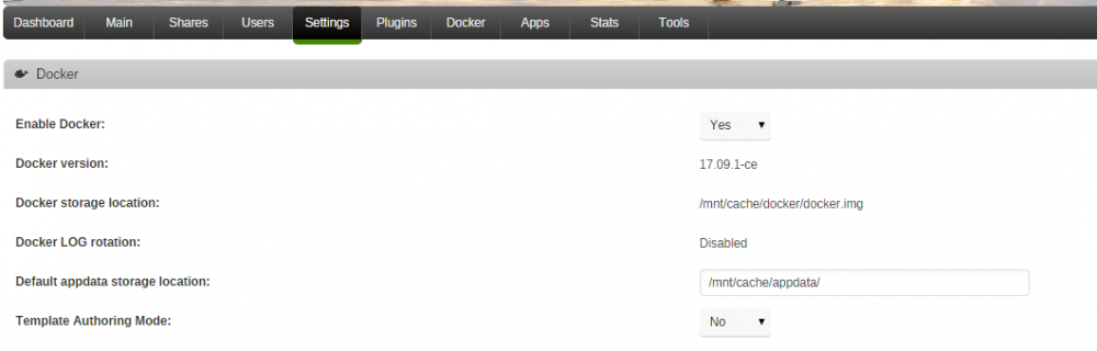

I manually set the paths to \mnt\cache for both appadata & docker
