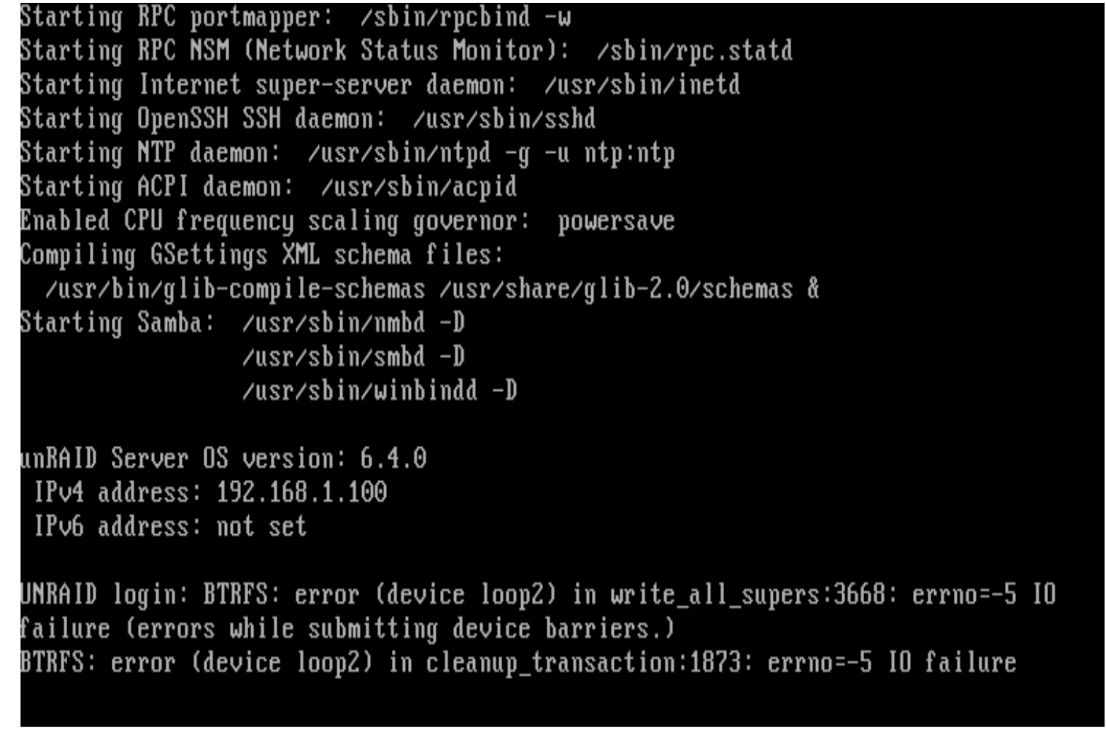

Nightly hard crash- what does this screen mean?
I was having issues with rebooting VMs, where the whole server would become unresponsive, no shares, no gui, no ssh. Never identified the real reason, but it went away with 6.4
Now I am getting a nightly crash that I can't pinpoint. It's just gone by every morning. During the last round of this I replaced/reseated all sata cables.

Screenshot indicates an I/O error on the loop2 device, that's either the docker image or the libvirt.img, but the problem might be the device where it's stored, e.g., if it's on the cache device and it drops offline those errors are expected.
Ok. I have dual cache drives. Anyway to know which I should pull to see if it stabilizes?
Check the output of:
btrfs dev stats /mnt/cache
Any non zero values means there's a problem.

Nothing jumps out, since loop2 was most likely the docker image and it's easy to do I would recommend deleting and recreating it:
Another thing to do would be to shutdown all VMs/docker and turn them on one by one and let it run some time to try and find if it's one of them causing the issues.

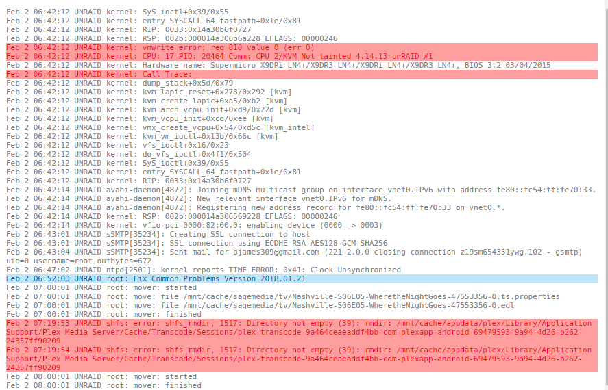

Didn't have time to do anything until yesterday evening, when all I did was reinstall the Dropbox docker. Woke up this morning and unraid was unresponsive.  The 0356 diags are the last before the crash from FCP troubleshooting, hopefully they contain something useful.  The 0927 are post reboot, after which a machine check event was detected, which I dont see very often.  mcelog is installed via nerdpack, so hopefully the diags explain the mce. Parity check running now.
The Win7 VM has its own Windows Task Scheduler task scheduled to reboot it every night at 4am.  that task shows as completed successfully this morning at 4, and the last troubleshooting log occurred at 3:56AM.  There is an entry in the libvirt log about the VM domain being tainted.  I have had issues for months with VM reboots that I thought went away with 6.4 but something to think about.  This was occurring with multiple VMs.

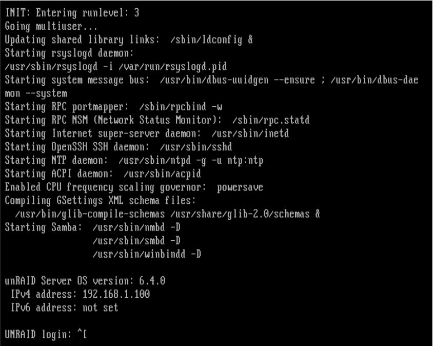

ANother mystery freeze last night. Nothing interesting on the monitor, but it wouldn't respond to keyboard.  Here is another post reboot diag file.  Is there anything at all in this one or the ones i posted last friday one message up?

Nothing I can see.
It's a hardware error, not sure RAM or CPU but it's not normal and it can explain your issues.

The first error happens to some users and it's considered harmless if the VM is working normally, the second one is just about some temp files that were since deleted, not an issue.

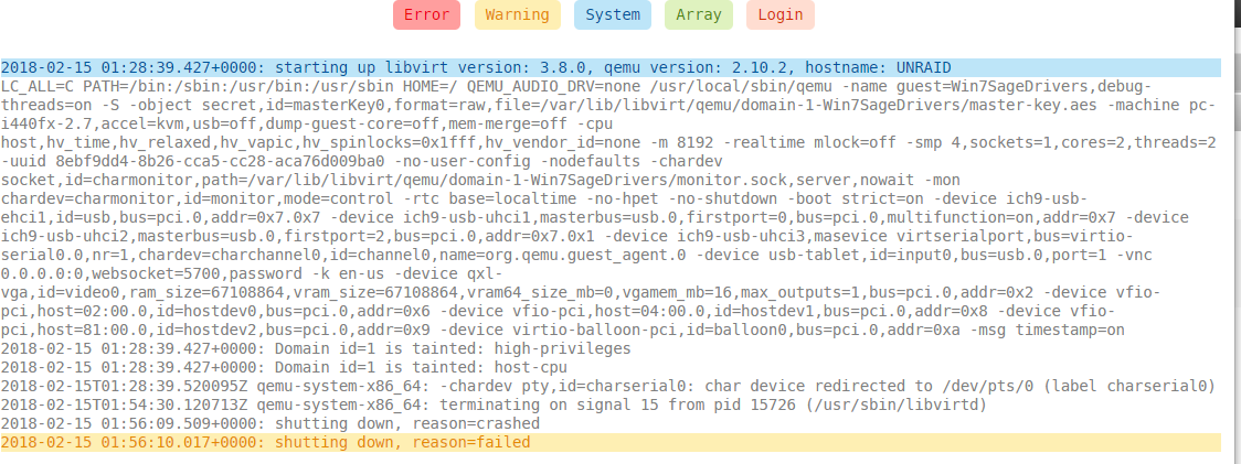

i saw this in the VM log after attempting to reboot it. mean anything? This was a hang again where the VM tab wouldn't fully load, able to recover by turning VMs off and On in VM settings, didn;t have to hard restart the server. Diags also attached
