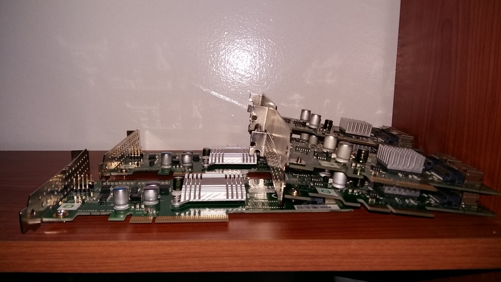

Great, a few more days should confirm if the disk is really good or not, in any case I would recommend replacing the SAS2LP, I know it can be difficult to justify when it appears they mostly work OK, but they are a know problem and IMO it's just a matter of time until they cause problems, other than some sporadic use on my test server I have all my SASLP/SAS2LP gathering dust, and they were quite expensive since I bought them all new, but they are a ticking time bomb.
Damn. I only have one drive on it so far. What do you use now?
Sent from my Nexus 5 using Tapatalk
Now I only use the onboard Intel controller, LSI HBAs and SAS expanders when needed.
