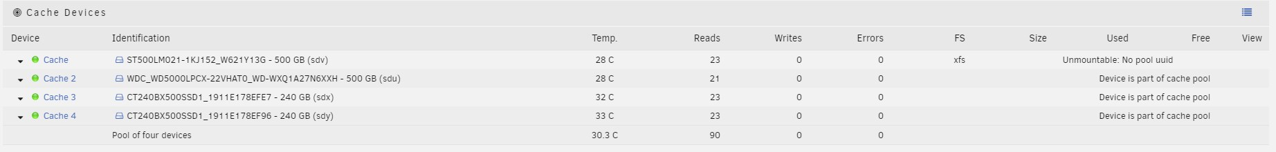

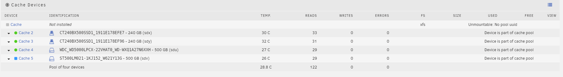

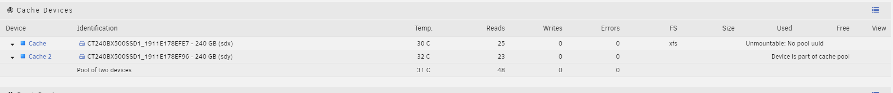

hey all i'm adding extra disks to my cache and i'm getting this error. i have tried to set the single drive to either auto or xfs but as soon as i add more the 1st one i get the uuid error. no matter what config and with what disks i get this problem.. i can even go back to a single drive and it will be fine no more uuid error
image.thumb.png.5b1bed871ef6965c1d212891196e0ca0.pngimage.thumb.png.539c1a801c078a5992ddcdebda4a2732.png
Please post the diagnostics: Tools -> Diagnostics

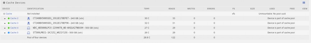

if i choose 5 and leave the 1st slot empty i get this

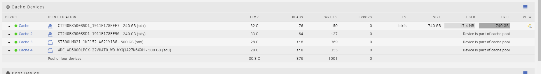

got it to work... had to use btrfs but sucks that i cant separate the 500gb disks into their own pool.
Any pool requires btrfs, you can have multiple pools with some limitations and the help of UD, until Unraid supports them.

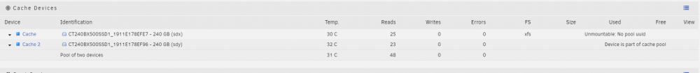

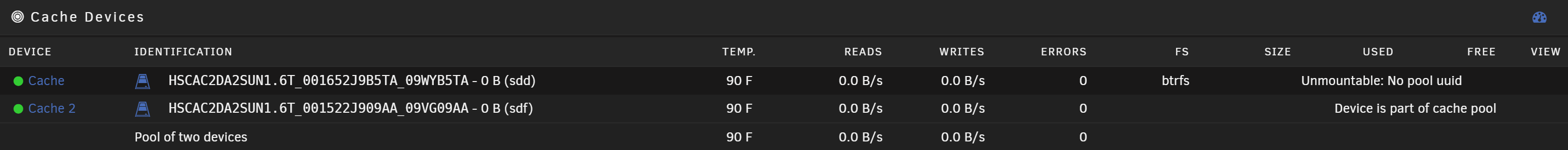

Hello, I am having the same issue with Cache drive unmountable: No pool uuid. This is a new server with 2 cache drives. I have tried going down to 1 cache drive and making sure it is on auto for the file system.
jupiter-diagnostics-20191230-1156.zip
Constant issues with both cache devices:
Dec 30 10:58:35 Jupiter kernel: sd 9:0:3:0: [sdf] tag#8755 Sense Key : 0x1 [current]
Dec 30 10:58:35 Jupiter kernel: sd 9:0:3:0: [sdf] tag#8755 ASC=0x1c ASCQ=0x2
Dec 30 10:58:35 Jupiter kernel: sd 9:0:1:0: [sdd] tag#9481 Sense Key : 0x1 [current]
Dec 30 10:58:35 Jupiter kernel: sd 9:0:1:0: [sdd] tag#9481 ASC=0x1c ASCQ=0x2
Dec 30 10:58:36 Jupiter emhttpd: Starting services...
Dec 30 10:58:36 Jupiter emhttpd: shcmd (12): /etc/rc.d/rc.samba restart
Dec 30 10:58:36 Jupiter kernel: sd 9:0:1:0: [sdd] tag#440 Sense Key : 0x1 [current]
Dec 30 10:58:36 Jupiter kernel: sd 9:0:1:0: [sdd] tag#440 ASC=0x1c ASCQ=0x2
Dec 30 10:58:36 Jupiter kernel: sd 9:0:1:0: [sdd] tag#2735 Sense Key : 0x1 [current]
Dec 30 10:58:36 Jupiter kernel: sd 9:0:1:0: [sdd] tag#2735 ASC=0x1c ASCQ=0x2
Dec 30 10:58:36 Jupiter kernel: sd 9:0:1:0: [sdd] tag#9881 Sense Key : 0x1 [current]
Dec 30 10:58:36 Jupiter kernel: sd 9:0:1:0: [sdd] tag#9881 ASC=0x1c ASCQ=0x2
Dec 30 10:58:37 Jupiter kernel: sd 9:0:1:0: [sdd] tag#681 Sense Key : 0x1 [current]
Dec 30 10:58:37 Jupiter kernel: sd 9:0:1:0: [sdd] tag#681 ASC=0x1c ASCQ=0x2
Dec 30 10:58:37 Jupiter kernel: sd 9:0:3:0: [sdf] tag#2356 Sense Key : 0x1 [current]
Dec 30 10:58:37 Jupiter kernel: sd 9:0:3:0: [sdf] tag#2356 ASC=0x1c ASCQ=0x2
Dec 30 10:58:37 Jupiter kernel: sd 9:0:3:0: [sdf] tag#5899 Sense Key : 0x1 [current]
Dec 30 10:58:37 Jupiter kernel: sd 9:0:3:0: [sdf] tag#5899 ASC=0x1c ASCQ=0x2
Dec 30 10:58:37 Jupiter kernel: sd 9:0:3:0: [sdf] tag#8823 Sense Key : 0x1 [current]
Dec 30 10:58:37 Jupiter kernel: sd 9:0:3:0: [sdf] tag#8823 ASC=0x1c ASCQ=0x2
Dec 30 10:58:37 Jupiter kernel: sd 9:0:3:0: [sdf] tag#1173 Sense Key : 0x1 [current]
Dec 30 10:58:37 Jupiter kernel: sd 9:0:3:0: [sdf] tag#1173 ASC=0x1c ASCQ=0x2
Likely because of this:
Physical block size:  4096 bytes
Formatted with type 1 protection
I believe this protection can be removed, but you'll need to Google it, unless someone else here has experience with this.
I can't find much on removing the type 1 protection. I'll continue to look into that this afternoon. Thanks for pointing me in that direction.
I formatted both sdd in the chache pool. It doesn't sat "Formatted with type 1 protection" anymore but still no changes. Are the drives failing? They pass the test with no errors.

I was able to figure it out. Turns out that I needed to move one of the ssd to a different slot. Thanks for the help

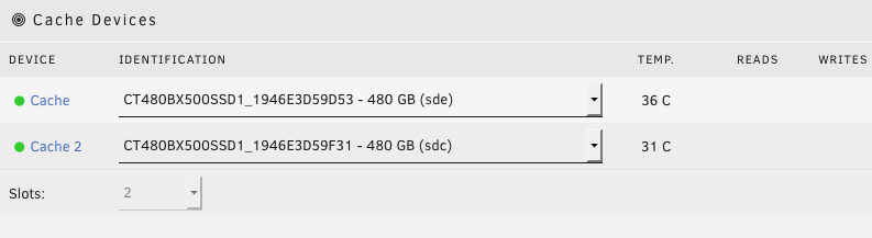

Same "Cache drive unmountable: No pool uuid" issue when I tried to add a second cache disk.  Original was formatted XFS.  Error occurred when I started the array after choosing two slots and added the second drive.
Now I notice the option to format as XFS is gone and only BTRFS is available.  Also I can't change slots back to 1 and just go back to the old configuration.  Is there a way to revert back?
Does this mean I cannot have XFS formatted cache drives and must have BTRFS if I want cache protection?
While googling I saw others had mentioned issues with BTRFS and recommended XFS.  Looks like that's where my screwup was?

Yes, if you have more than 1 drive in the cache the only supported format is BTRFS.

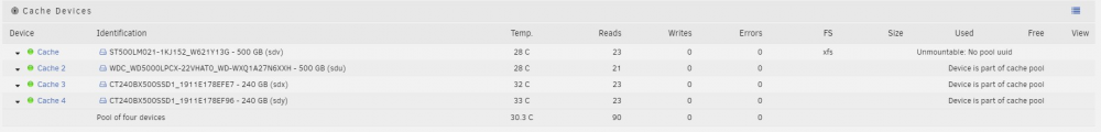

Hello everyone;

I following the video from space invaders on how to encrpt an unassigned drive by stopping the array - remove the cache drive (pool of 2) and add the UD into the cache slot then select XFS Encrypt and start the array, etc..
I placed the 2 cache drives back in their spots and changed the file system back to btrfs and when i started i array i now get an error
Unmountable: No pool uuid
Device is part of a cache pool
I have also attached my diag logs.
Thank you!
Edited by iptvcld
Remove zio
I can't tell you what happened because whatever it was it happened before this boot but no btrfs filesystem are being detected which suggest cache devices were wiped.
And this is the case for both cache drives? This is not good at all.
Yes, they both should have the same filesystem, and neither has one, like the superblock was wiped.
