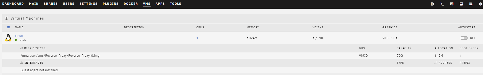

November 7, 20224 yr Hello so everything works except for the network settings is this an issue with the conversion? I'm running a linux system specifically Ubuntu. duxx1-diagnostics-20221106-2357.zip
November 7, 20224 yr 7 hours ago, Mattyice said: everything works except for the network settings Is the issue that you don't have internet inside the vm or the message guest agent not installed? If it's the latter, just install qemu guest agent into your linux vm. Package name could differ for different linux distribution, for example it can be qemu-guest-agent. After installation enable it, for example: systemctl enable qemu-guest-agent systemctl start qemu-guest-agent Then check if it's running correctly, for example: systemctl status qemu-guest-agent If you don't have internet change network type from e1000 to virtio or virtio-net or e1000-82545em Edited November 7, 20224 yr by ghost82
November 7, 20224 yr 4 hours ago, ghost82 said: Is the issue that you don't have internet inside the vm or the message guest agent not installed? If it's the latter, just install qemu guest agent into your linux vm. Package name could differ for different linux distribution, for example it can be qemu-guest-agent. After installation enable it, for example: systemctl enable qemu-guest-agent systemctl start qemu-guest-agent Then check if it's running correctly, for example: systemctl status qemu-guest-agent If you don't have internet change network type from e1000 to virtio or virtio-net or e1000-82545em Correct I don't have internet in the VM at all so I can't install anything.
November 7, 20224 yr I've done what you recommended and I'm unable to enable qemu-guest-agent as it has to be installed and even chaging the VM network types nothing works.

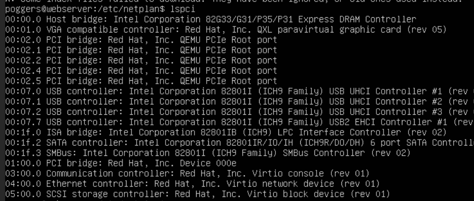

November 8, 20224 yr Check in the guest vm if the virtual network adapter is there, open a terminal and type: lspci then press enter. It should list the adapter at 02:01.0 if you didn't change your xml.
November 8, 20224 yr If it's not changed from the xml in your diagnostics, I cannot explain, the address is there, and also it was e1000 and now it's virtio. Anyway, 04:00.0 or 02:01.0, e1000 or virtio, doesn't make any difference, you have the virtio network inside the vm, the issue is inside the vm, not related to qemu or libvirt, maybe you just need to configure the connection inside the vm (networkmanager?) Edited November 8, 20224 yr by ghost82
