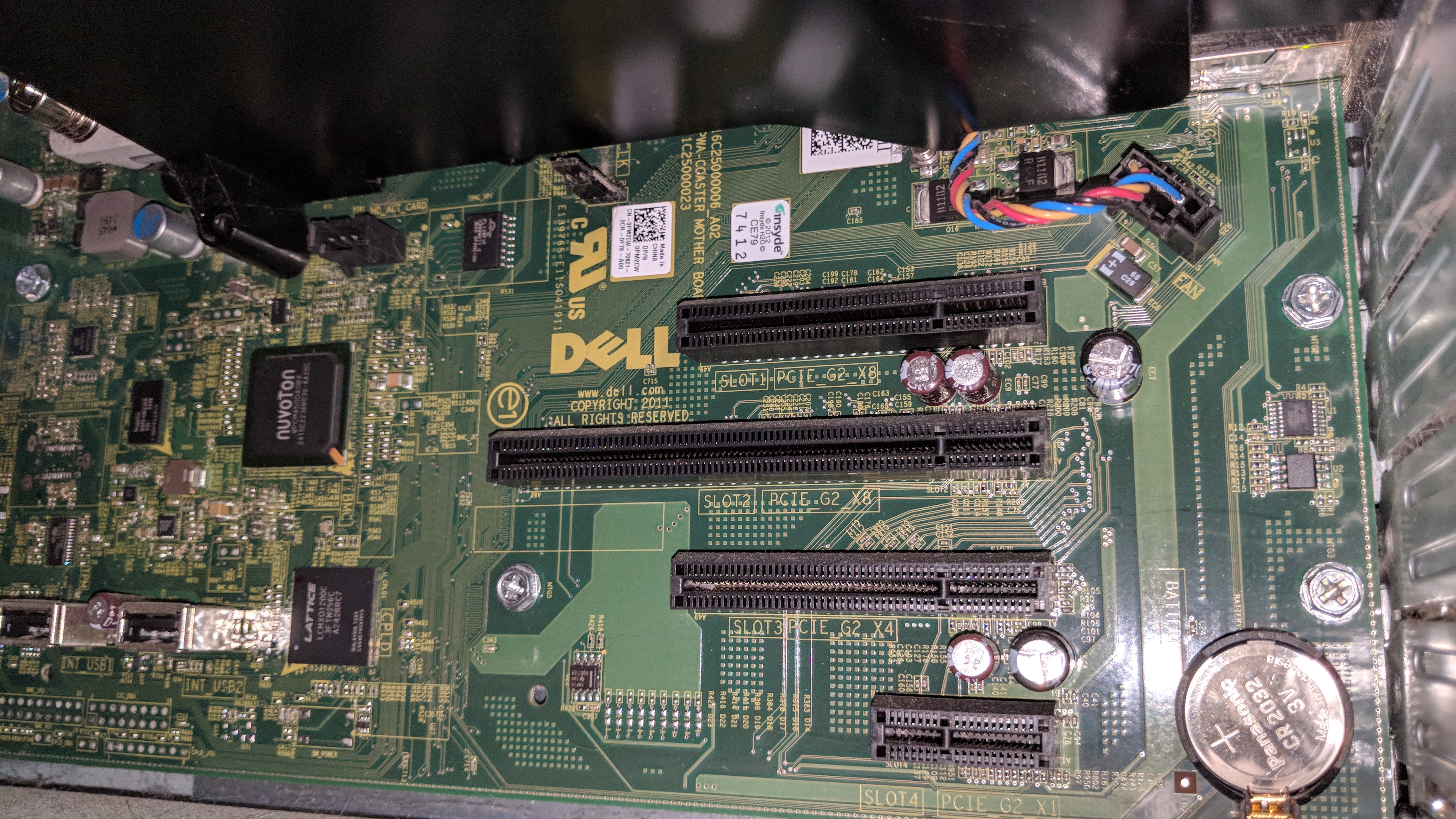

Also, here's the inside of the Dell, so hoping it'll go into the bottom slot?
