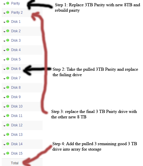

So i have a 3 TB drive dying:
187  Reported uncorrect 0x0032 098 098 000 Old age Always Never 2
197 Current pending sector 0x0012 100 099 000 Old age Always Never 136
198 Offline uncorrectable 0x0010 100 099 000 Old age Offline Never 136
My current server has two 3 TB Parity drives, however due to price point and the ability to upgrade later i bought two 8 TB drives to fix the problem. My logic is to take one of the 8 TB drives and replace one of the good 3 TB parity drives. RESYNC. Then take the pulled 3TB old parity drive and replace the failing 3 TB drive and RESYNC. Finally take the last 3 TB pairty drive and replace it with the other 8 TB Drive. and RESYNC.
Is this the best method / way to do this??? This is going to take 3-5 days due to the multiple re-builds.
OR Would it be better to just go down to 1 pairty drive and use the other to replace the failing drive, once rebuilt, replace the remaining parity disk with both 8 TB drives?
Edited by pyrater
Either way works, you can also use the parity swap procedure.
Personally I wouldn't rebuild parity with a failing data drive.
I'd have to think through it a little more thoroughly, but my gut instinct is to use parity 2 to replace the bad drive, then add an 8TB as parity 2, let it build, check parity, then build parity 1 on the second 8TB.

There are errors on Disk 6 so ill do the parity swap procedure. Thanx for the suggestions guys.  Can i do both Parity disks at the same time? Or do i need to do ONE, then swap the other?  IE:

  9. Unassign the parity drive (BOTH!??)
  10. Assign the new drive in the parity slot (BOTH!??)
    You may see more error notifications! This is normal.
  11. Assign the old parity drive in the slot of the old data drive being replaced
    You should now have blue drive status indicators for both the parity drive and the drive being replaced.
  12. ASSIGN THE OTHER (OLD) PARITY DRIVE AS ADDITIONAL STORAGE??
