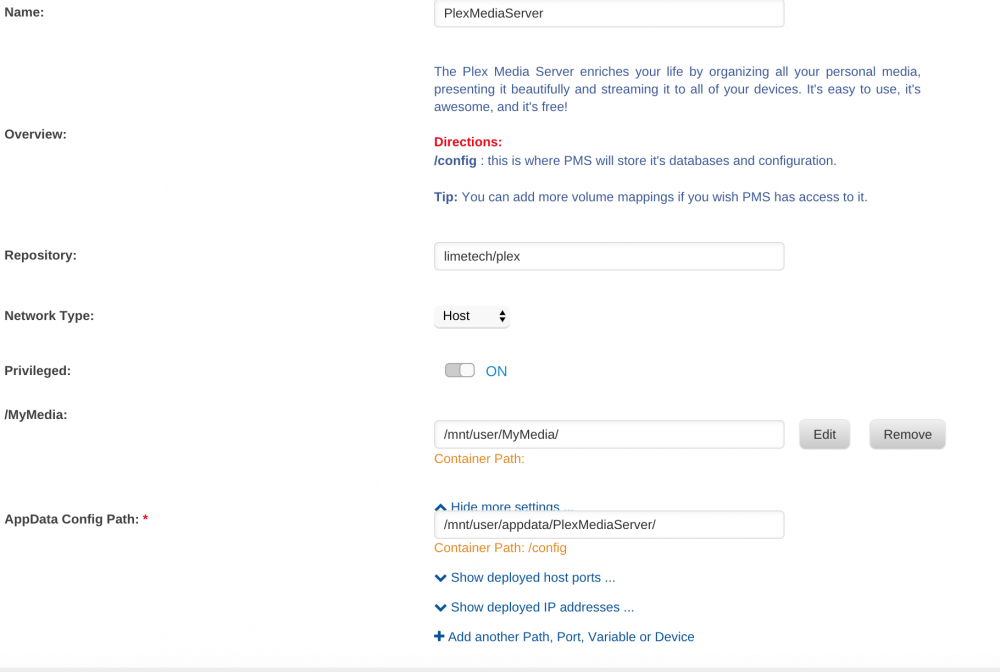

OK. In your MyMedia you are going to have a folder now called Library. That you accidentally created. Don't worry about that for now. You can delete it later.

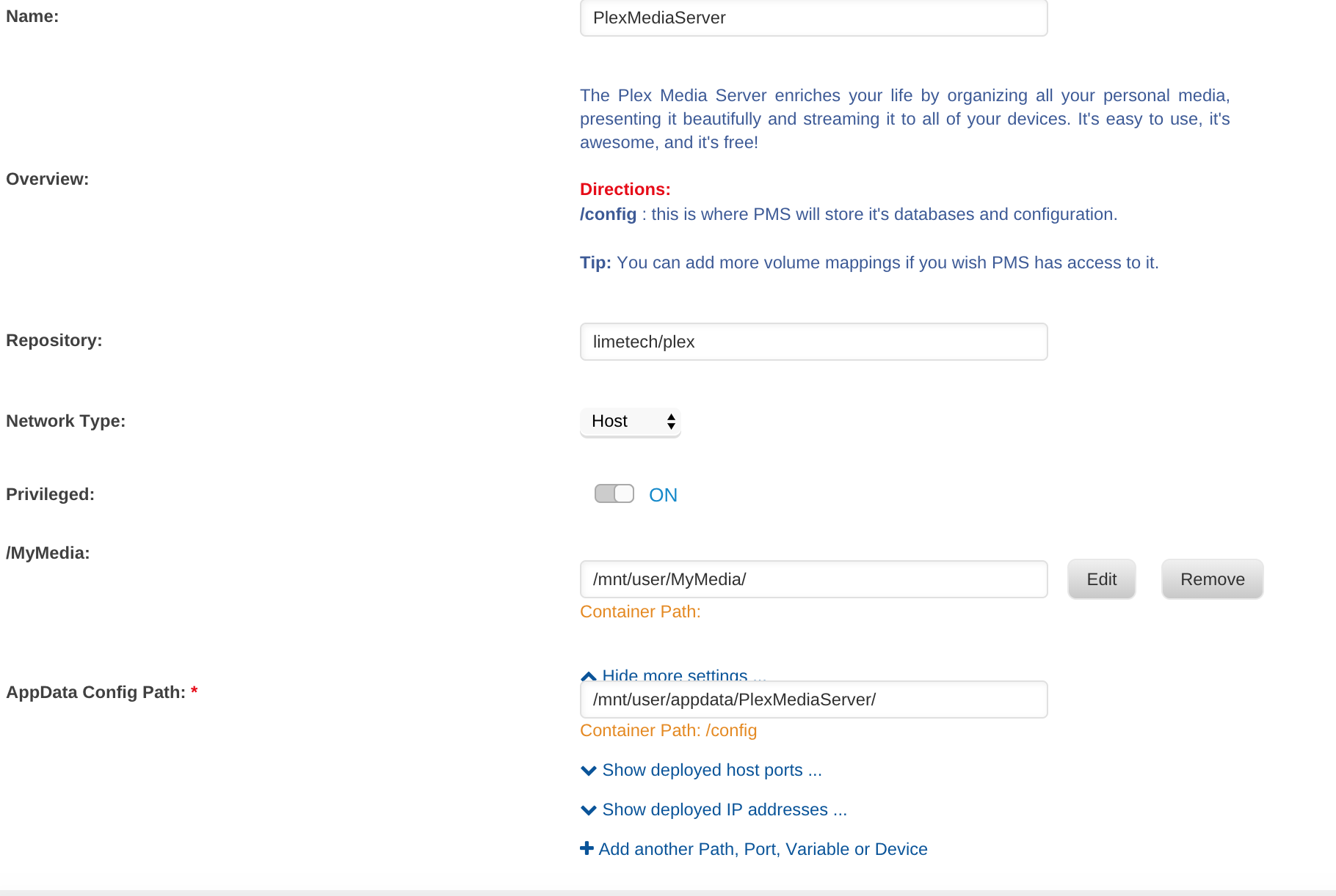

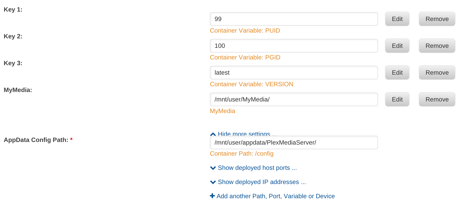

Here is a screenshot that shows my mappings. You only have one mapping, and it is wrong. You need to have at least 2 mappings. The first mapping is telling it where to store the plex library (config) and the 2nd mapping is telling it where my files are so I can tell plex where they are.
This is what I have so far.
That looks good. I really would consider using the linuxserver version of Plex though.
Could that be why I can't find my library in Plex?
In your most recent screenshot, you have mapped your MyMedia share (/mnt/user/MyMedia) to /MyMedia, so in plex you would find it at /MyMedia.
It might be best if you stop the plex docker, go into your appdata share and delete the plex folder and let it start over so you get a clean start.

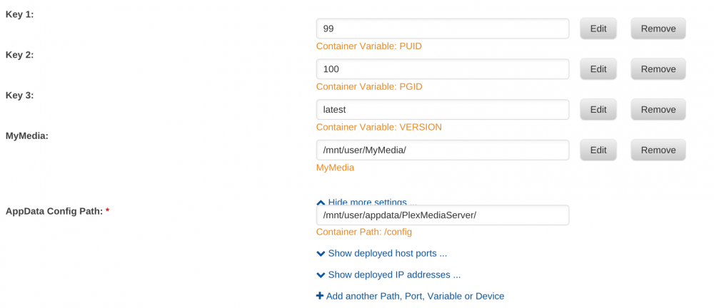

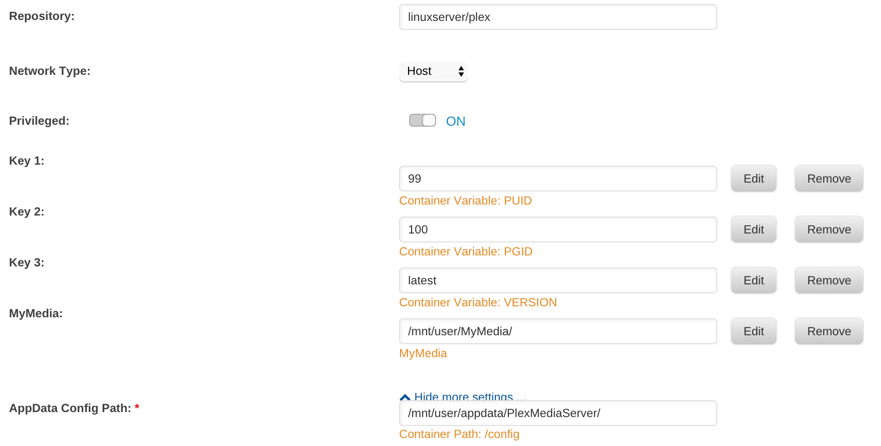

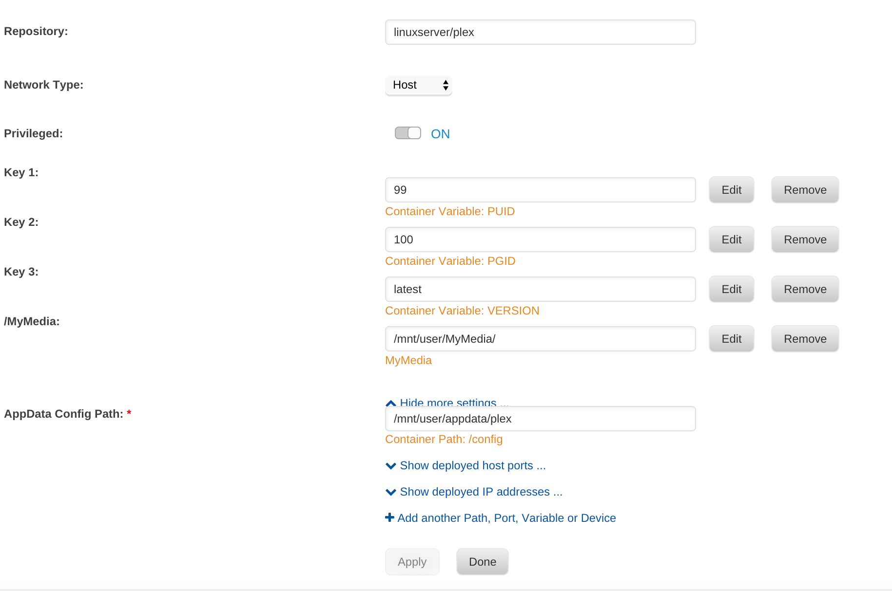

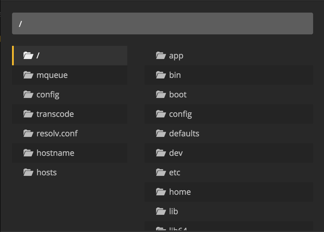

Ok I've done what you have said and deleted the shares that I have created and started fresh. Also switched to linuxserver Plex.   Plex is still not showing my library.  I'm using mac btw.

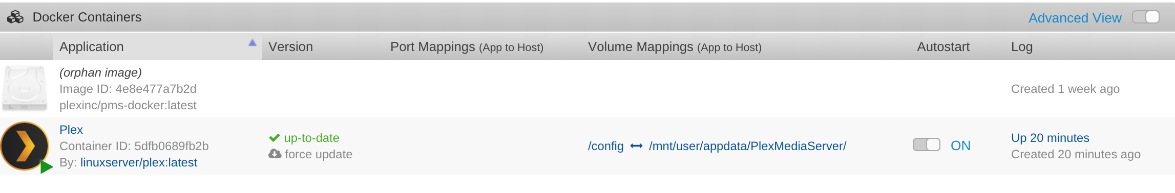

That 1st screenshot doesn't have a mapping for MyMedia, but that last screenshot does. Did you add that mapping after taking the 1st screenshot?
Go to that 1st screen and move the slider from Basic to Advanced.
That's how it is currently setup
sorry I didn't screenshot the whole thing

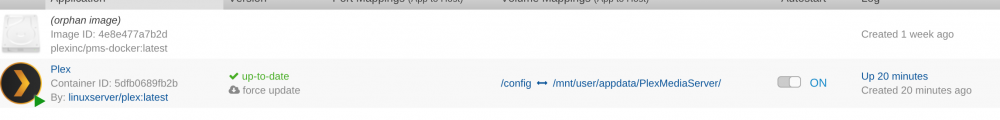

Delete the orphan image, then go back to the screen for configuring your mappings and make sure it is like you want it and apply.

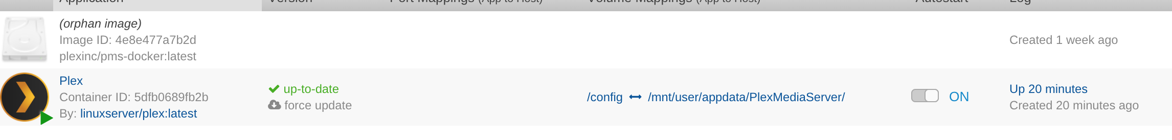

Did that.  Still doesn't show library in plex
Maybe I'm not looking in the right place?  I feel like I'm missing something.

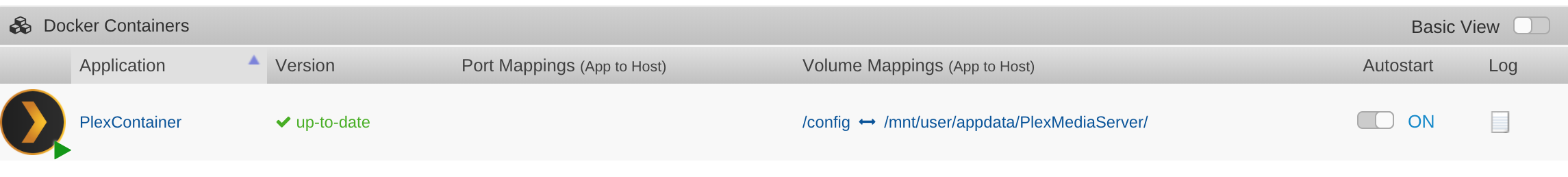

Before even trying to run the plex webUI to see if you can see your media, you need to get a mapping for your media in the container. The last screenshot you posted of the Docker Containers showed no Volume mapping for your media. Until you fix that plex has no way to see your media.
Are you sure you applied the mappings you showed in that other screenshot?
Maybe something is breaking the unRAID webUI on your setup. Do you have any adblockers installed? Do you have any incompatible plugins installed? What version unRAID are you running?
I have hit apply.
I'm using 6.4.1.
I have AdBlock turned off for tower.local.
I have Community Applications & Fix Common Problems plugins installed.
Is there supposed to be docker container for each volume mapping?   Because when I try to Add Container it just replicates the one I already have.

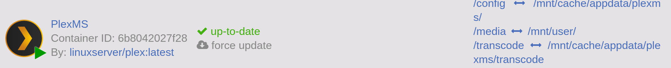

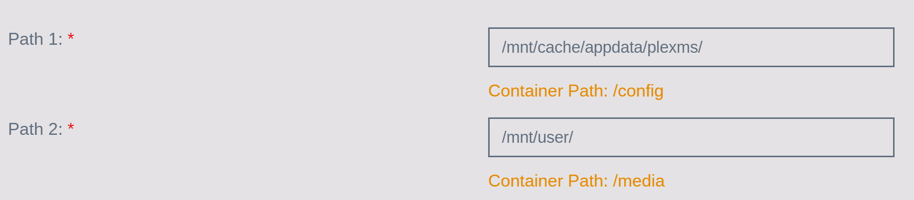

Here is an example of what you should see. Notice the multiple mappings. There should be one for /config and one for /media:
My volume mapping don't show like that...It's almost like its not recognizing that i've made any changes
