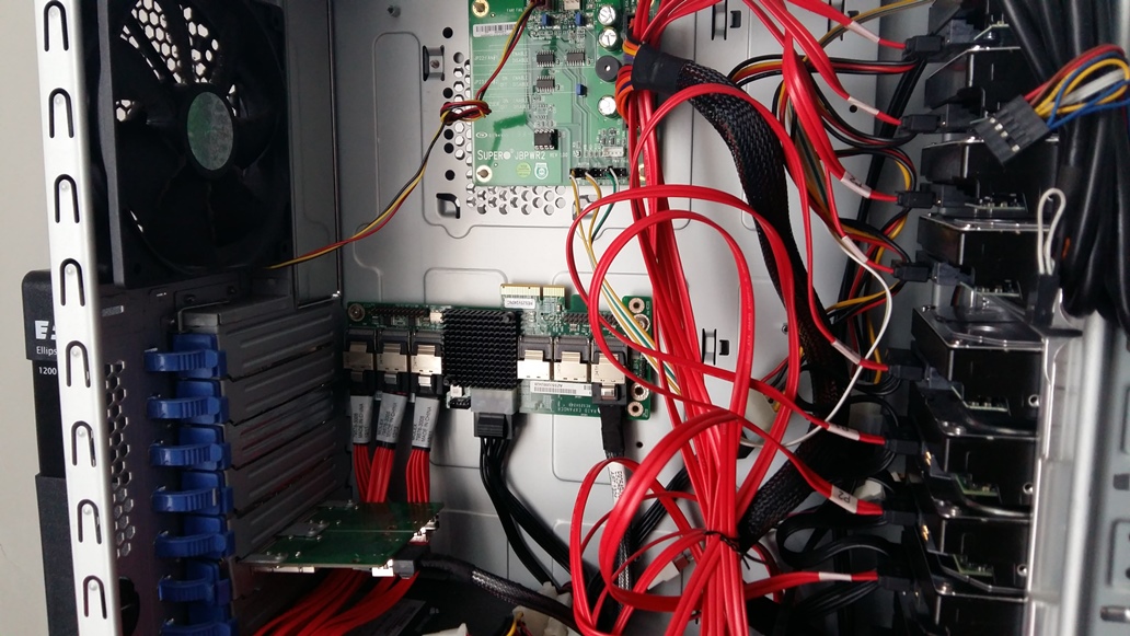

Another option to consider, use an atx case, you can even use something you already own, together with an expander and the cables you mention and build your own external case, similar to this:
Supermicro power board is optional, you can just clip the PSU plug.

in your photo; what is that pci card that is bolted to the case? And has all the sas cables?
thank you for sharing. This makes me more optimistic!
14 hours ago, johnnie.black said:
an expander
I’m curious how the expander works without a Motherboard.
i see there is power at top of card. Then through a minisas cable coming from unRAID machine, through a plug at back on drive case and that plugs into first slot of expander card. Then all other slots have cables that go to each hard drive. Is this correct? The expander does not need a mobo to do its thing?
Nope. It can use the motherboard for power if you want, and it's easier to use the slot for mounting vs. trying to rig up electrically isolated mechanically sound mounting elsewhere, but it works fine as long as you feed it power from somewhere.
47 minutes ago, hernandito said:
Cost-wise, it’s a wash between this solution and dedicated enclosure. The main advantage is more drives.
Depends on what you already have and if buying used, the expander cost me around $60, there's also an HP expander on ebay for about $25, though that one needs sto be powered by a board, or at least a PCIe riser.
