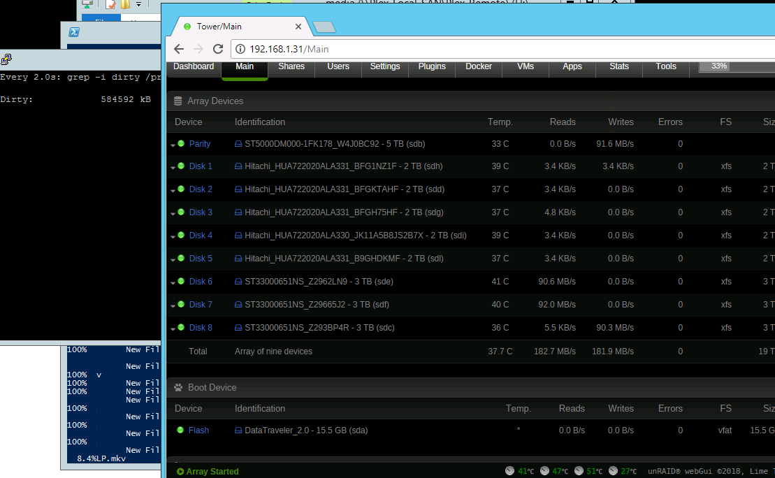

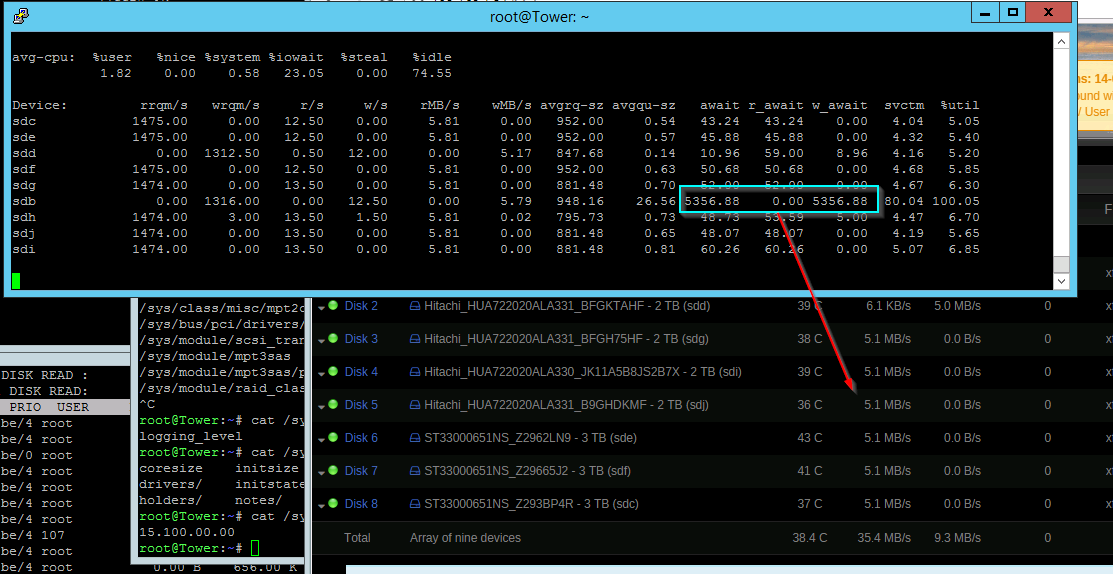

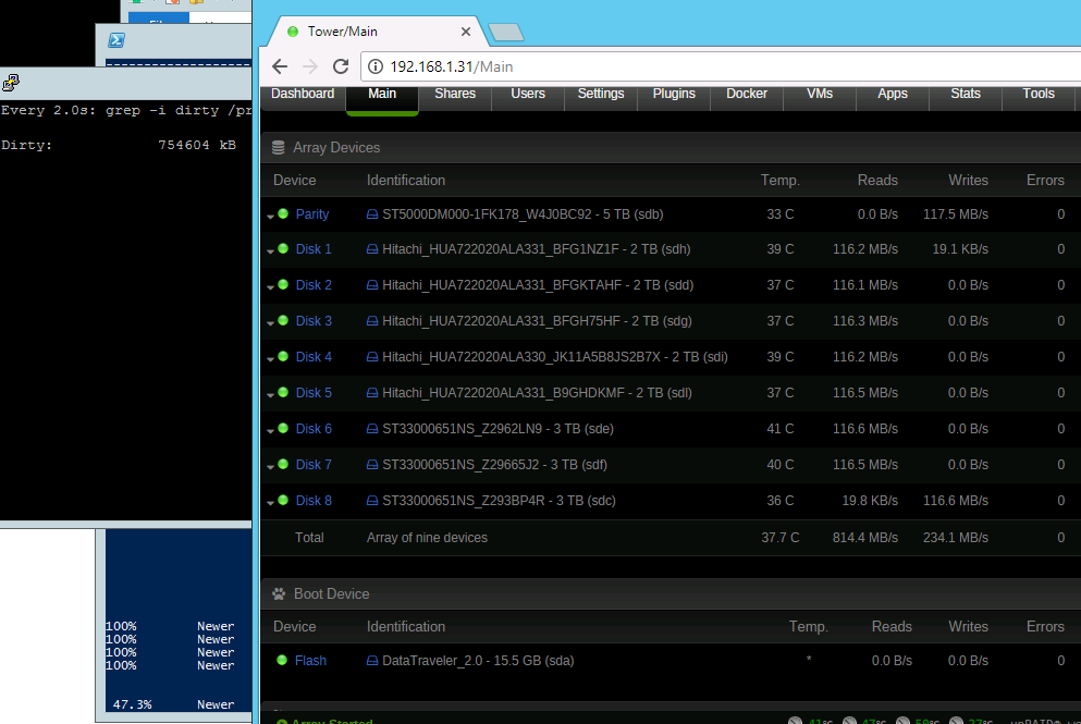

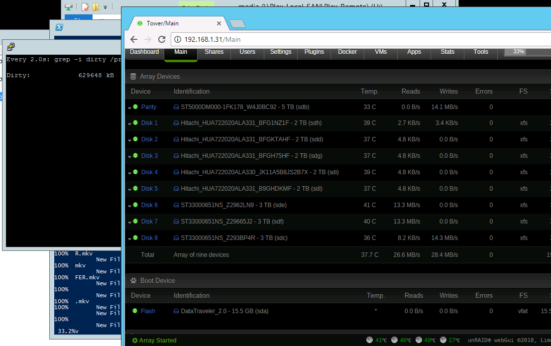

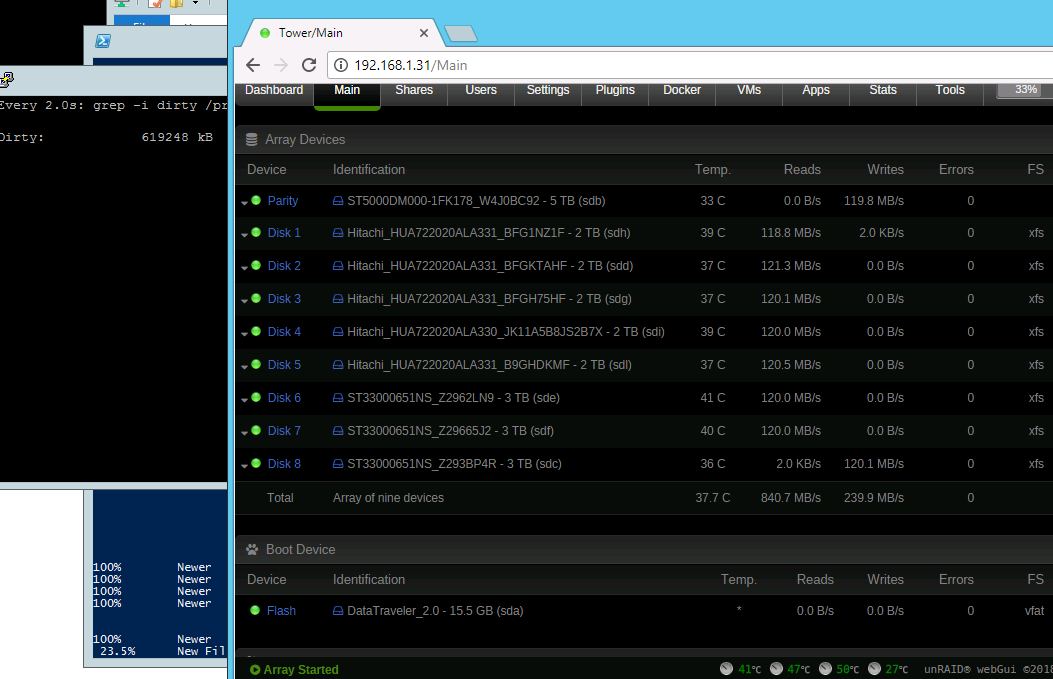

Please note: md_write_method is to reconstruct write. In my opinion it should be 100MB/s write and read from each drive, but when it has an issue - its between 2MB/s - 25 MB/s. Attached are a few screenshots of it starting to run fine, and then dropping way low. Also attached is my diagnostics report.
Also to note... I find it odd that when the issue happens, only 2 of the drives are reading to calculate parity during turbo write. Per my understanding, it should be reading all of the drives at once. If it makes a difference, these were added after the initial creation of the entire array. Also to note, in "iotop -oPa" -- unraidd has "IO>" at least 80-90% all the time. This might be an issue with adding the drives in after the initial array creation?

@trurl, I believe I've solved my own issue. My parity drive appears to be dumping can causing the whole issue. When it happens, await times for the drive skyrockets. I will be replacing it for a 3TB drive.

The drive is an SMR drive, with FW of CC46, shucked from a USB enclosure.. Others posted the information on how SMR drives work. After the cache (on the drive? is filled up, its a very slow write to dump it to disk. It appears that during this time is when the whole system halts in transfer. I am just getting into Unraid and the whole system/setup - so this was news for me.
