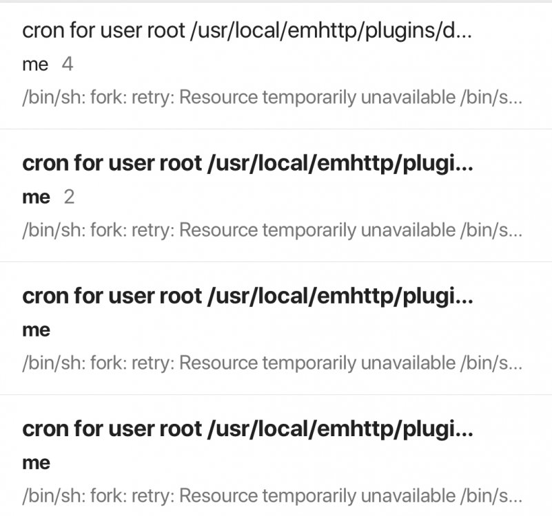

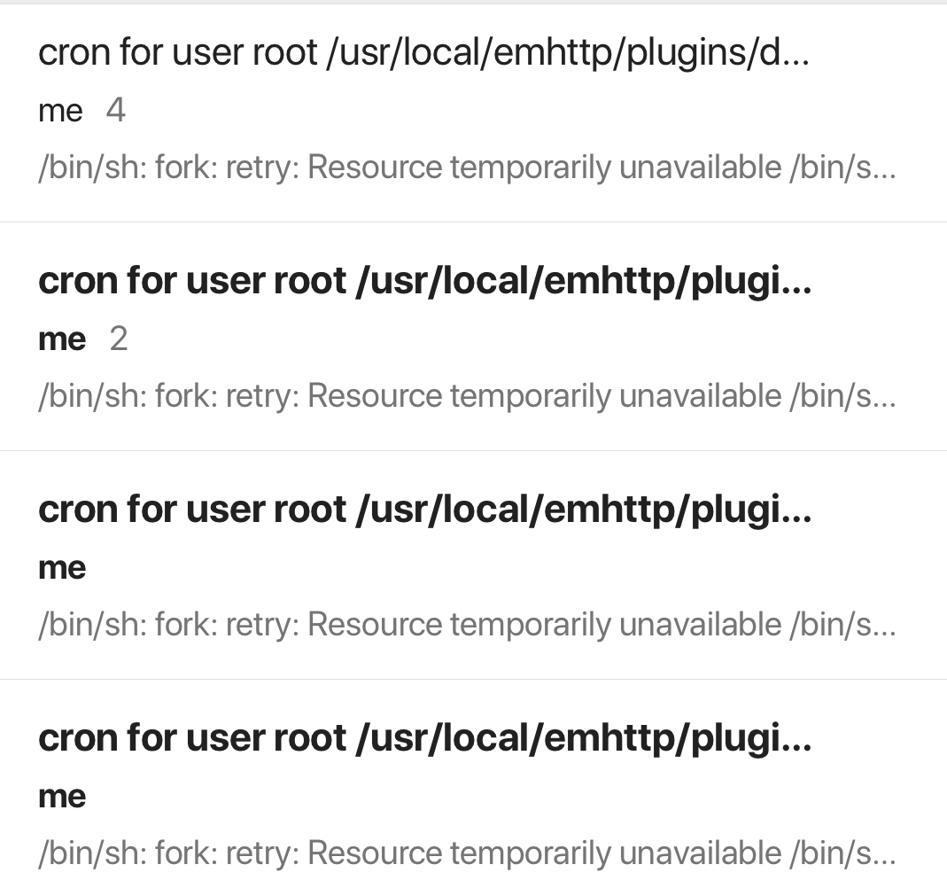

My server has been fine for the last year running 24/7 until today. Running the latest release 6.5.0. All server VMs went offline, when I load the web gui the plugins, dockers and VMs tabs won’t load. I restarted the server and started getting spammed with emails as seen in the attachment.

k.  What is the emails then.  The pic in the OP is cut-off and not much help

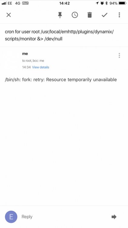

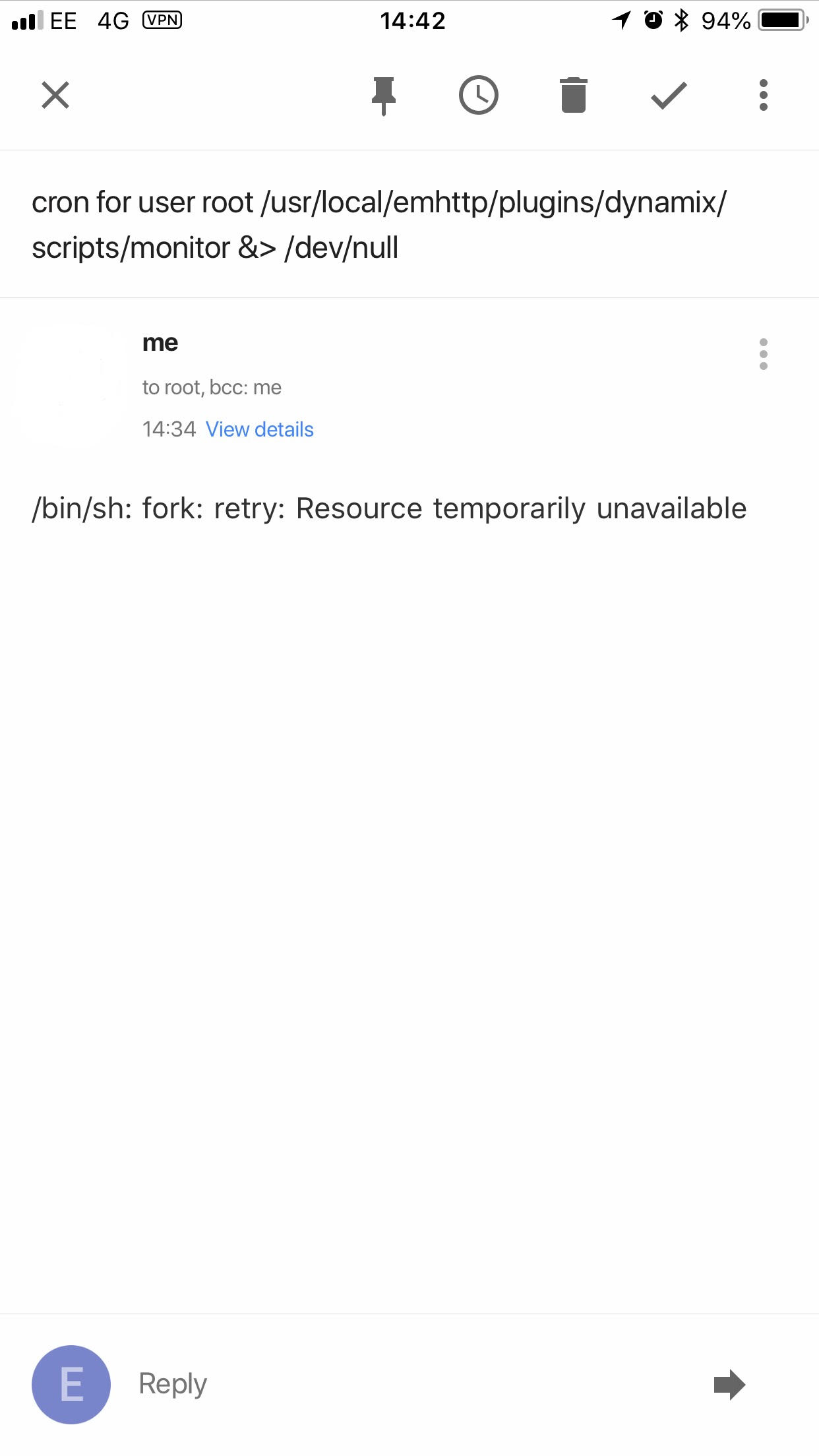

So after downgrading to 6.4.1 from 6.5.0 the server VMs no longer crashes and the gui stays accessible but I still receive the error emails (sorry for not attaching it in full the first time I have now below.) Also some sections of the gui remain non-functional such as the plugins page and diagnostics.

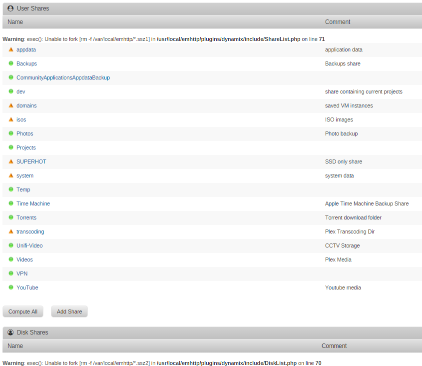

Under the shares tab it shows a couple errors too - I have attached a screenshot.
