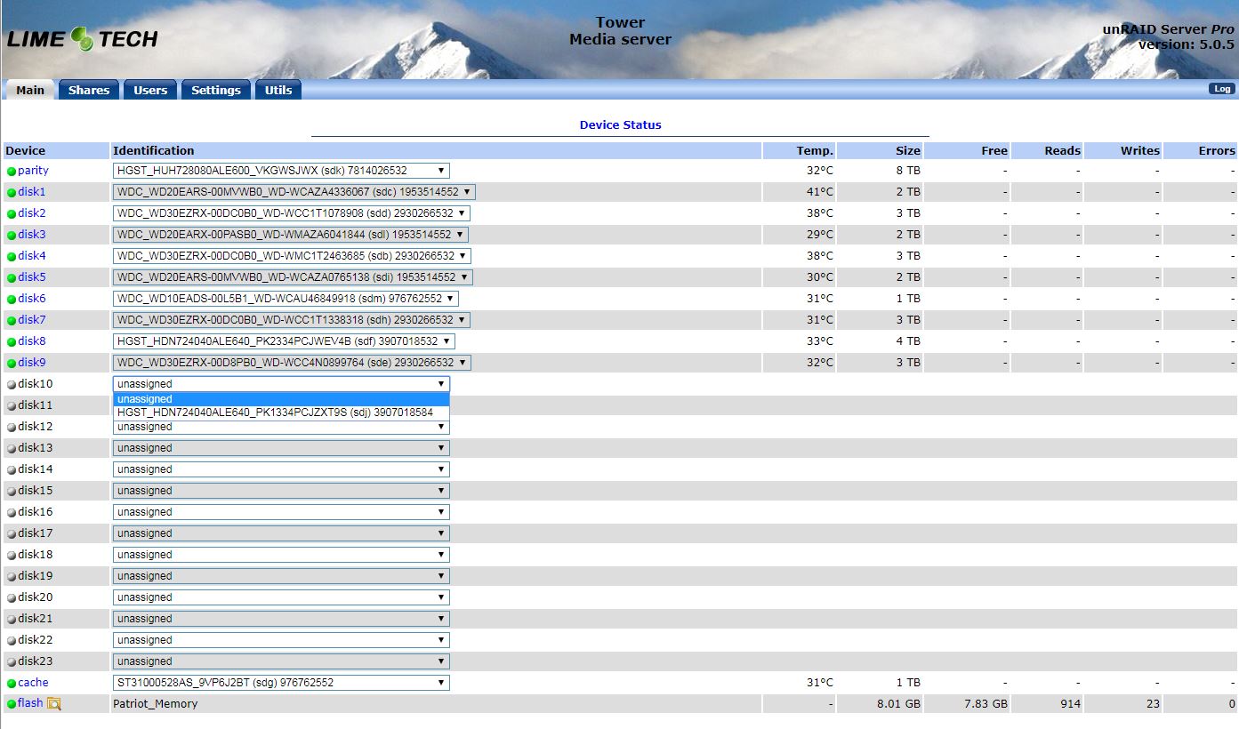

I recently replaced an HGST 4 TB parity disk with an HGST 8 TB.  I precleared the 8TB drive, installed and parity-synced.  I then re-installed the 4 TB disk to a different port.  I went to run the preclear script on the  4TB and it could not see it!  preclear -l reports "No un-assigned disk detected".  I stopped the array and clicked on the dropdown assignment menu and the 4 TB show up there (see screencap).  Anybody know what's wrong?

Yes, I plan to upgrade but not before I have step-by-step list to move to mysql docker for my Kodi install.  I just thought I would pre-clear this disk first.  This has always worked for me before and I would like to understand why it is failing now.  Should I use the "new Config" util in UnRaid 5.0.5 to reset the configuration?
Just checked devs.ini and it has:
[device0]
id="HGST_HDN724040ALE640_PK1334PCJZXT9S"
device="sdj"
size="3907018584"
This is the old 4 TB parity disk that I want to preclear.  It just looks like the preclear script is not reading this correctly for some reason.  ????
