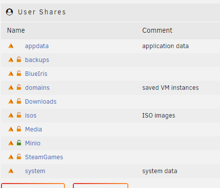

I am getting this error... and these are my shares.

If you have a /mnt/usr folder then it is nothing to do with User `shares (which all exist under /mnt/user).   You must have done something to get that folder created.   It is always worth doing a reboot to see if is still present - if so you have probably got something (e.g. a docker) misconfigured so that it is creating that location.

F you cannot easily reboot at the moment it might be worth checking any docker configurations.     Leaving out the ‘e’ in ‘user’ when configuring a path to point to a User Share could cause this symptom.
I think i know the issue. I moved something from /mnt/cache to /mnt/user. I messed up and put /mnt/usr and not /mnt/user. This was yesterday and I corrected right away.
I will delete the directory /mnt/usr.
I double checked that unifi is not using it anymore.
Thanks for your help!!!
