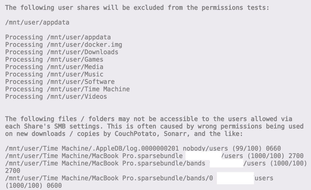

If you want to try to understand how the problem came about you'll need to provide some more information about the Movie A and Movie B folders and how they were created. It's possible to access a public share as a guest user or as a registered user and I suspect you've done both by accident and the permissions have got messed up that way.
If you just want to fix it then run the New Permissions tool - preferably the Docker Safe version, which is included in the Fix Common Problems plugin - on the Tools page.
so i have previously run Fix Common Problems and attached a screen cap of the results - i'm not terribly concerned by the time machine errors - and none of the other folders turn up any problems.
I no longer have a windows machine but back when I did - whenever I ran into a problem browsing via Mac finder, i could circumvent it by using my windows machine to edit directories / files.
