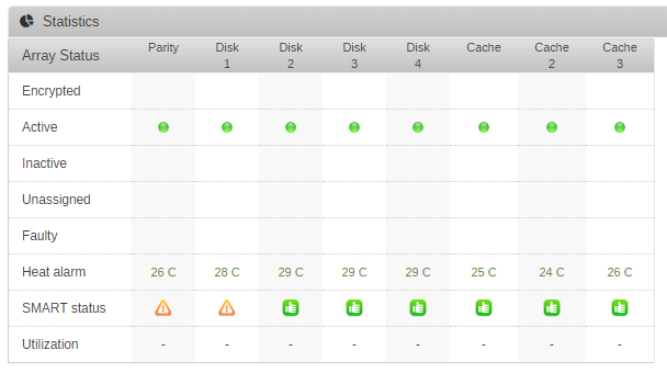

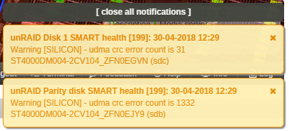

I have now updated from v6.4.0 to v6.5.1 and thus rebooted. Now I am getting new smart errors on my Parity disk and Disk1. and the message above has disappeared from Disk2. See screenshots below:

Also, here is something from the update notes about your CRC warnings
Starting wth 6.4.1, unRAID now monitors SMART attribute 199 (UDMA CRC errors) for you.  If you get an alert about this right after upgrading, you can just acknowledge it, as the error probably happened in the past.  If you get an alert down the road, it is likely due to a loose SATA cable. Reseat both ends, or replace if needed. (see this)
