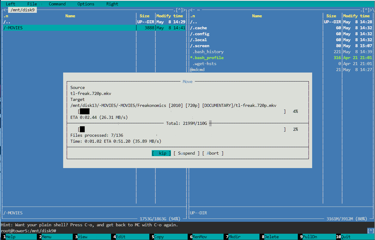

So, before removing some disks, I am copying their data to a larger installed disk. As you can see in the following image, I am trying to move all files form disk 9 to disk13. Both contain a '-MOVIES' directory at their root. I want the '-MOVIES' directory from disk9 to move to disk 13 (I dont mind any overwrites).
But, as you can see, somehow the '-MOVIES' directory is moved inside the disk13  '-MOVIES' directory .
What am I doing wrong?

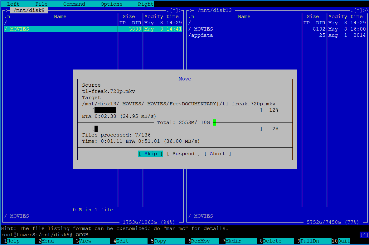

Post a screenshot when you press F6 to initiate the move operation but BEFORE you press enter to execute the move operation.
Your first picture already shows that. What is the output of

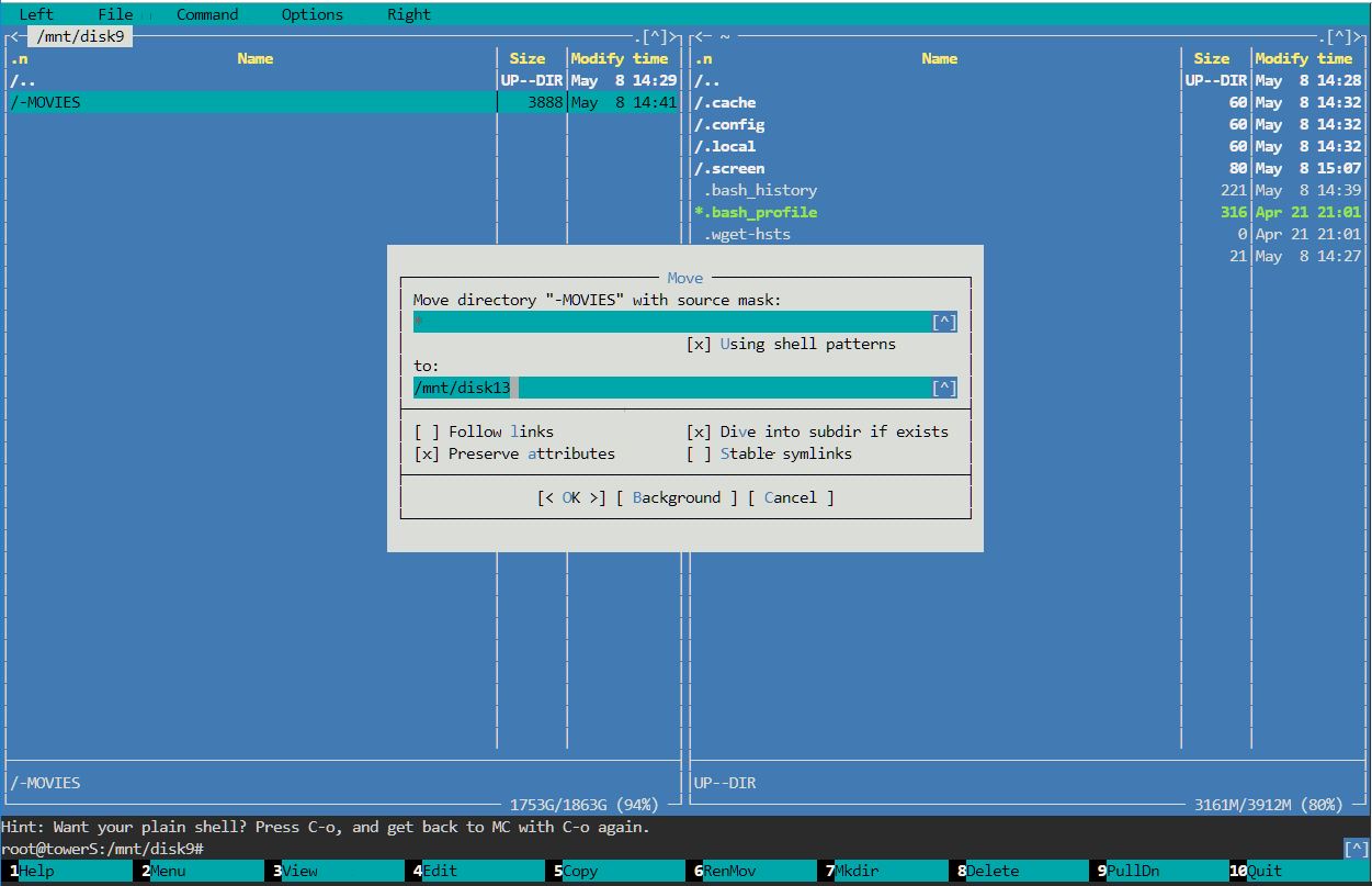

What happens if you uncheck the option "Dive into subdir if exists" (default setting is unchecked)
2 minutes ago, trurl said:
Are you sure you don't have a -Movies folder in the -Movies folder on the source?
100% sure
Wow, it works OK now. And it still copies subdirectories from the source.
I dont understand why, though, as this option supposedly dives into the SOURCE directoey...
I have never used this option, but it looks like it is for the TARGET directory (creates one level lower).
