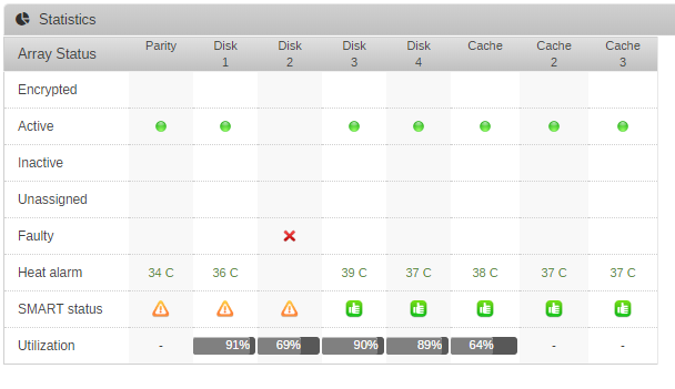

Those problems have been fixed but now Disk2 is acting up again. Unraid has marked it as Failed.
I have attached a diagnostics report because I can't make anything out of it. Is the drive actually dead, is it a bad cable/sata port? Should I actually replace the drive?

Looks more like a cable problem, replace both cables.
Without checking your diagnostics.
Check your smart status, both your parity, disk 1 and disk 2 has a warning in smart status
But disk 2 might just be a cable problem.

Parity and Disk1 are "UDMA CRC error count" errors.

Both have UDMA CRC errors, OP if these keep increasing it usually indicates a bad SATA cable.

They do increase by one every few days. Just ordered a bunch new SATA cables, will replace the one on Disk2 later today with one I still have and the ones on Parity and Disk1 when I get them.

@johnnie.black @Struck Replaced SATA cable, same port, same issue but now SMART on Disk2 can be read. So I've attached a new diagnostics file.
I can try swapping cables but I do not have any more ports left on the motherboard and PCIe expansion card.

Just moved it to a SATA II port (which I was trying to avoid) but still, the drive is 'disabled'. Again a diagnostics file if that helps.
silicon-diagnostics-20180509-2222.zip
Does this mean the drive is bad?

When a disk is disabled it always needs to be rebuilt, changing cable/port is to hopefully preventing it from getting disabled again in the future.
I can't find an option for rebuilding...
