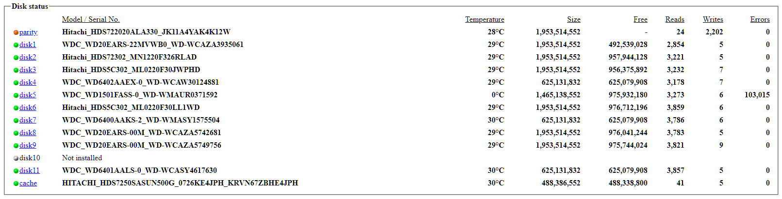

So....here's an interesting development. I'm guessing it's like the hitachi so should I just remove that along with the other two failing drives?
If the disk is really failing yes, it could be a cable/connection issue, SMART report might help figure out which.

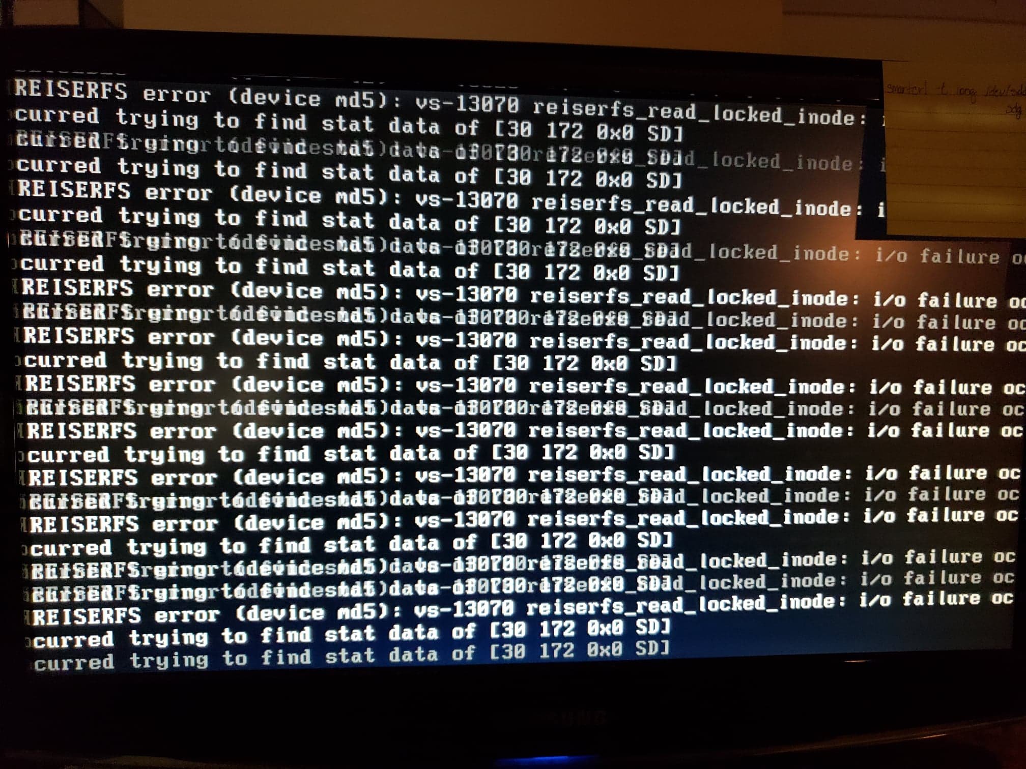

They array won't stop so I can shut it down. After waking up the monitor to do the smart report this is flashing on the screen:
REISERFS error (device md5): -vs13070 reiserfs_read_locked_inode: i/o failure occured trying to find stat data of {30 172 0x0 SD]
