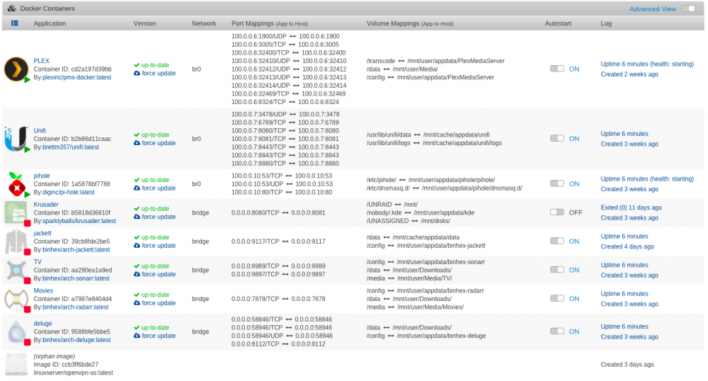

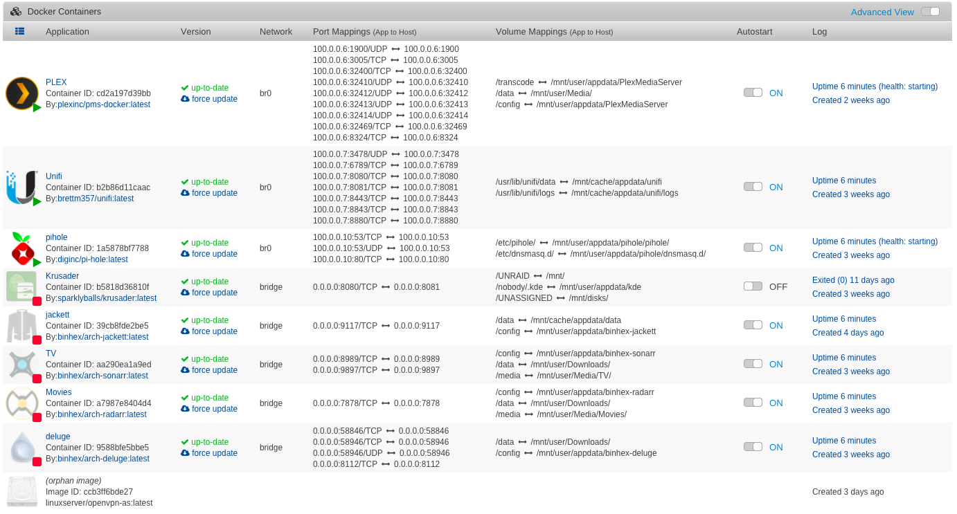

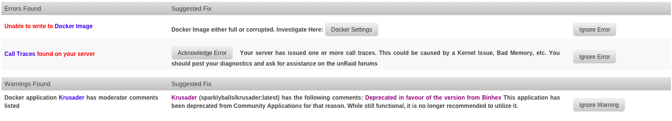

I have now got a few more errors, although the server has not become unresponsive. Some of the docker applications are not working anymore and i am getting a Call Trace Error. I am unable to force update the docker apps, i cant delete them either and I have one that says orphaned (sorry I'm new to UnRaid).
Diagnostics file attached.

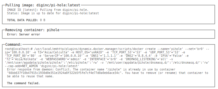

Edited by shuds
Added Screenshot

Call traces are related to btrfs errors on loop2, which is your docker.img so whatever you have done it is still corrupt.

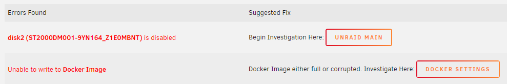

I tried what you asked, there were no errors found and now I am getting another error. After performing the test, one of my HDD's are disabled. SMART is not reporting any errors whatsoever. I have also attached the SMART image. BTW filesystem is XFS
