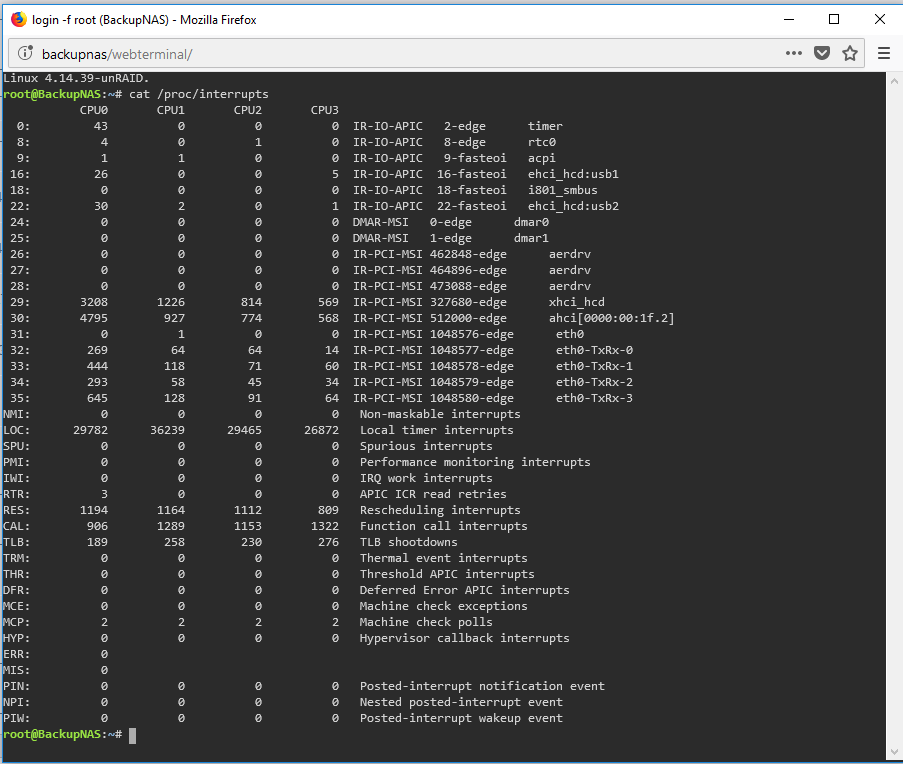

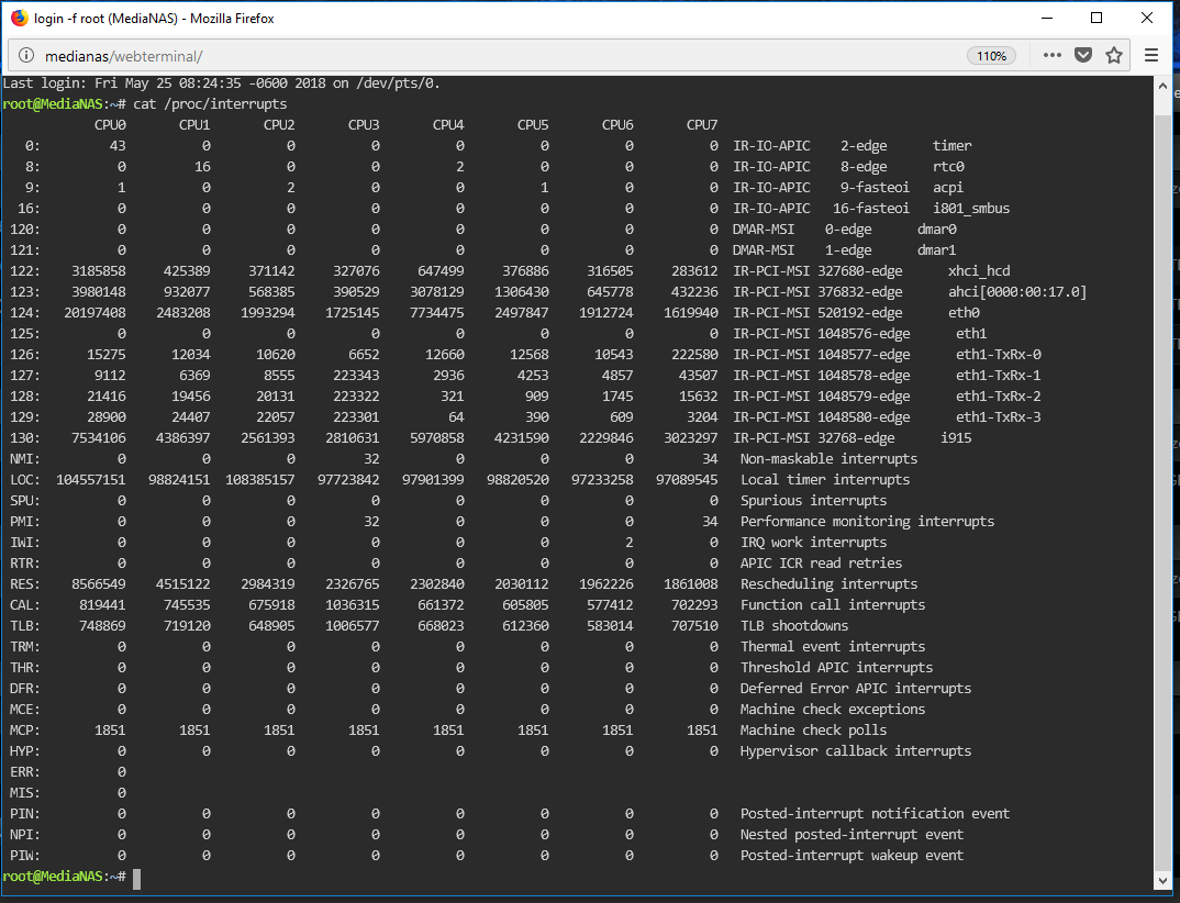

Since the problems are being caused with IRQ 16, you need to find out what is assigned to IRQ 16.  I don't know why you are getting a "no such file or directory" error on "cat /proc/interrupts"  As seen below, I am able to run it without issue on both my unRAID servers. My backup server has USB1 assigned to irq 16.  Your server likely does as well. I am curious if any other drivers are assigned to irq 16.
From the terminal can you do a "cd /proc"  Is there a /proc directory?
Here is the /proc/interrupts output from my main server:
Here is the output from my backup server:

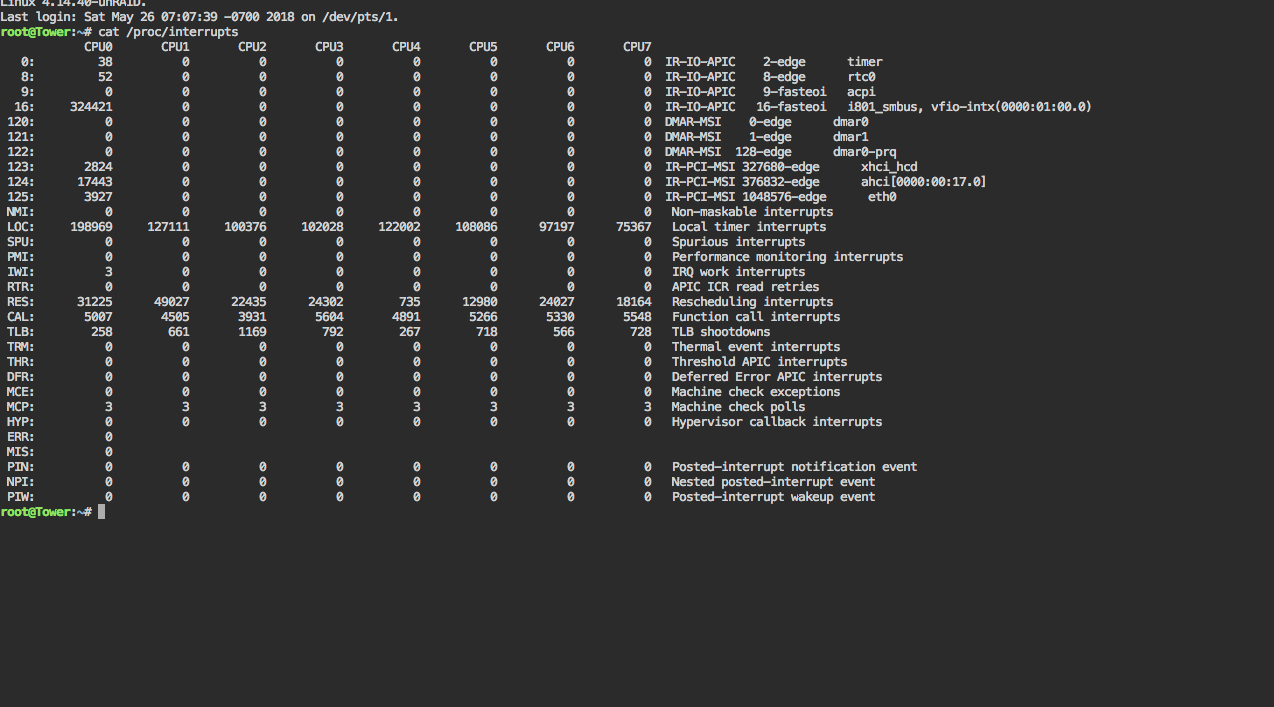

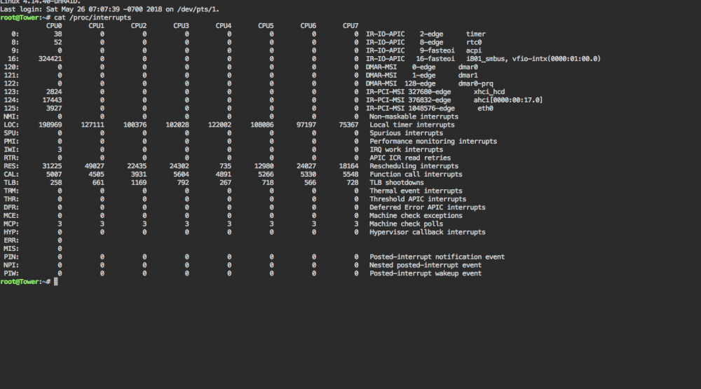

Sorry i got the error because when typing cat /proc/interrupts i didnt put a space after cat.....this is what happens when you spend 9 hours trying to fix something with no breaks.....this is the result of the command entered correctly
Also, i do have an external USB, its the USB with the limetech stuff on it that is needed to boot, other than that its just my mouse and keyboard.Screen Shot 2018-05-26 at 3.11.05 PM.png

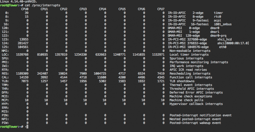

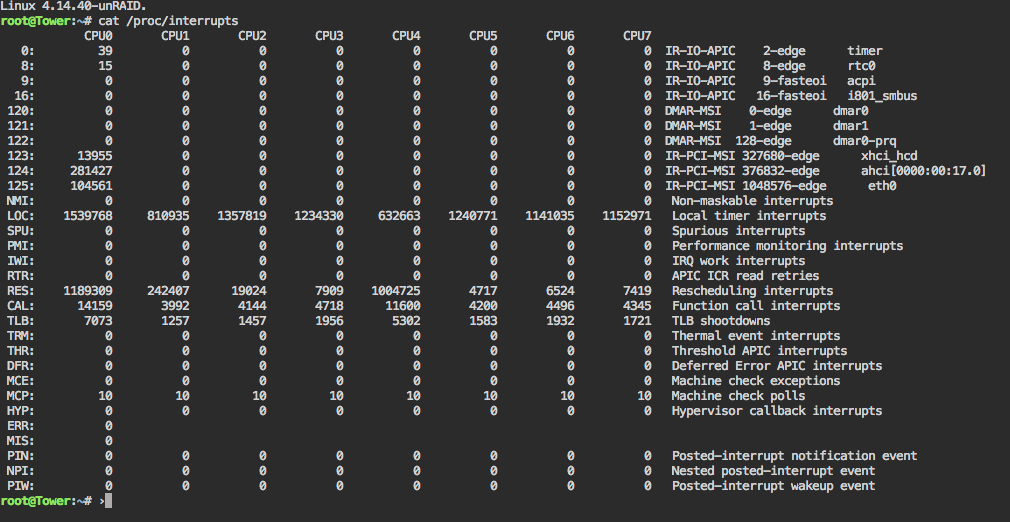

So i have no idea if its because im using OVMF with hyper-v off or because i switched around the USB's (install drive and mouse and keyboard) but i now have ni IRQ work interrupts.....problem solved?
