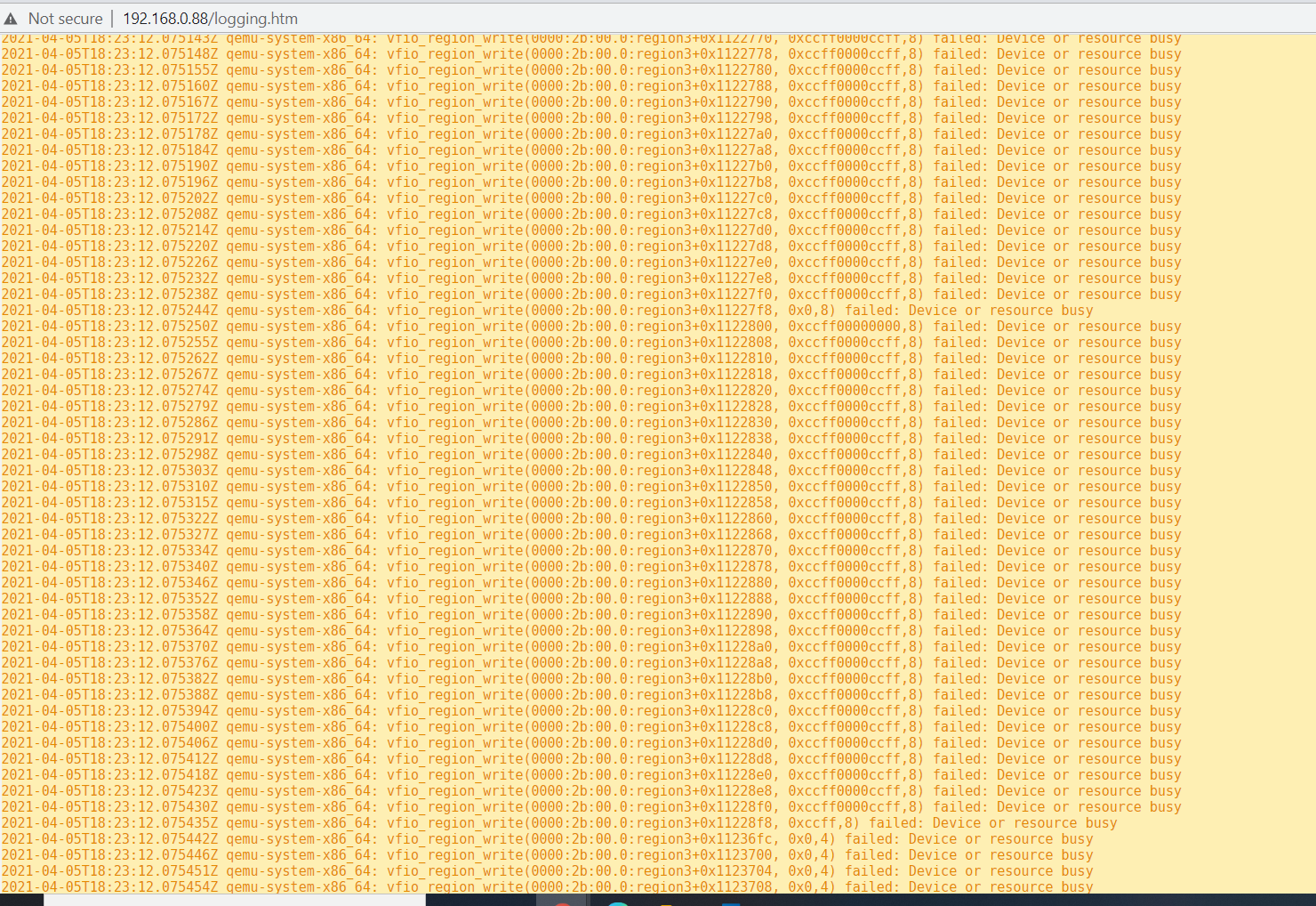

April 5, 20215 yr I'm having the same error myself, i've tried all kinds of fixes and watched every video SpaceInvaderOne has made about Nvidia GPU passthrough and still no display. I just need it to work temporarily until i can get hold of a RTX 3080 at a non extortionate rate. This is the error code in the log (Log Screenshot Attached) 2021-04-05T18:23:12.073130Z qemu-system-x86_64: vfio_region_write(0000:2b:00.0:region3+0x111d780, 0xccff0000ccff,8) failed: Device or resource busy 2021-04-05T18:23:12.074649Z qemu-system-x86_64: vfio_region_write(0000:2b:00.0:region3+0x1121708, 0x0,8) failed: Device or resource busy Unraid 6.9.1 Motherboard: MSI Tomahawk b550 (MS-7c91) Version 2. CPU: AMD Ryzen 5600x 6-core. GPU: Nvidia GeForce GTX 650 ti. RAM: 16gb DDR4 3200mhz. Latest Bios Installed I've tried both types of vbios (Hex editing and Script in unraid) All IOMMU Groups passed through successfully and i can boot into GUI Mode! IOMMU groups enabled in bios as well as VM's

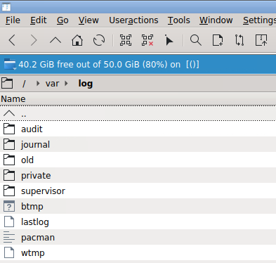

February 25, 20233 yr Community Expert 2 hours ago, Joseph Higgins said: I can't find that file to delete it.... You will have to do from the command line root@computenode:/var/log/libvirt/qemu# ls HA.log Unraid-VM.log root@computenode:/var/log/libvirt/qemu#
February 25, 20233 yr I used krusader to start with since I don't know the unix command lines at all. I did not think I saw it. Still can't find it.
