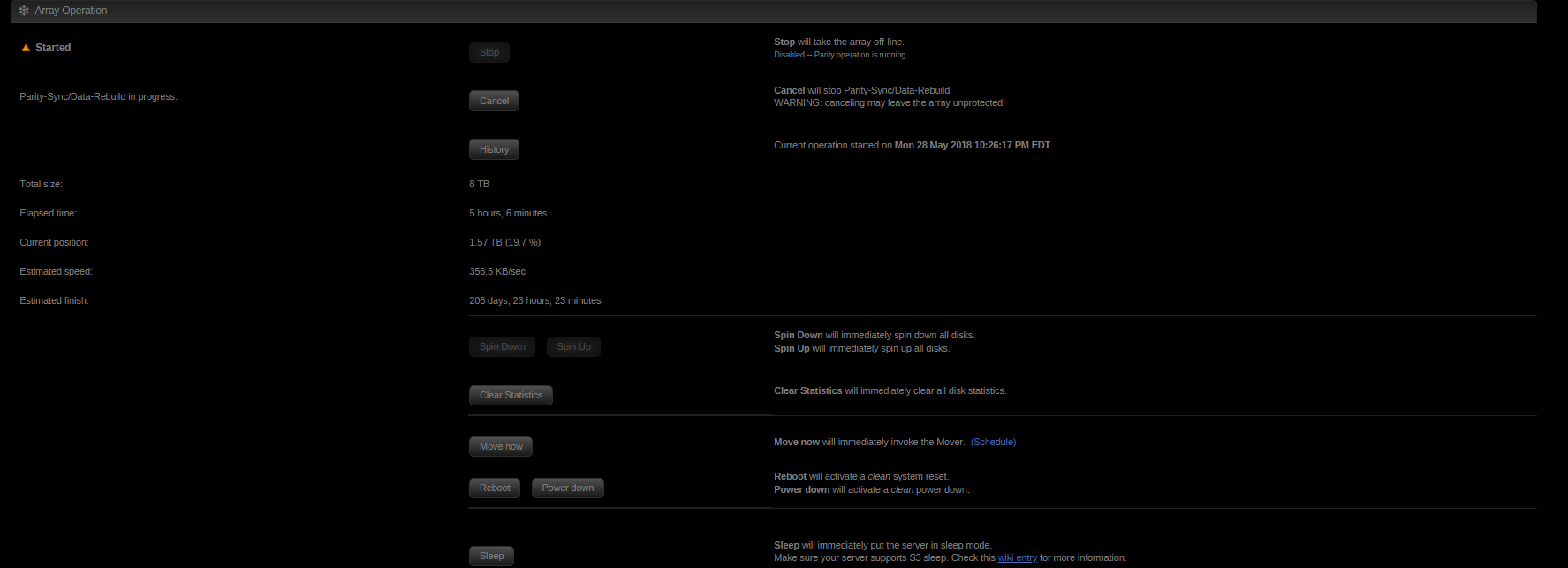

I swapped out a drive for my parity drive to rebuild parity and it starts off great and then next thing you know it is going at a rate less tham 5mb/s sometimes less than 1mb/s and that is horrible with an 8tb parity drive. If I try to run the drive without the parity it works okay but quickly becomes unusable. I attached my diagnostics files and would really appreciate the help.

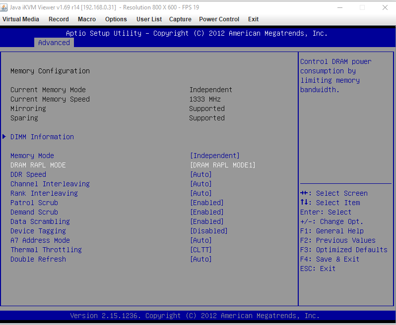

Also this is the only setting I saw in the bios about ram figure I take a screen grab and show it since I am still learning a lot about server hardware and all this fancy stuff. Currently still in school for compi sci/info system,
Those memory setting seem fine.  Try running that memory test option from the boot menu.  I'd run that test for several hours at least but you might see errors pretty quickly if the memory is bad.

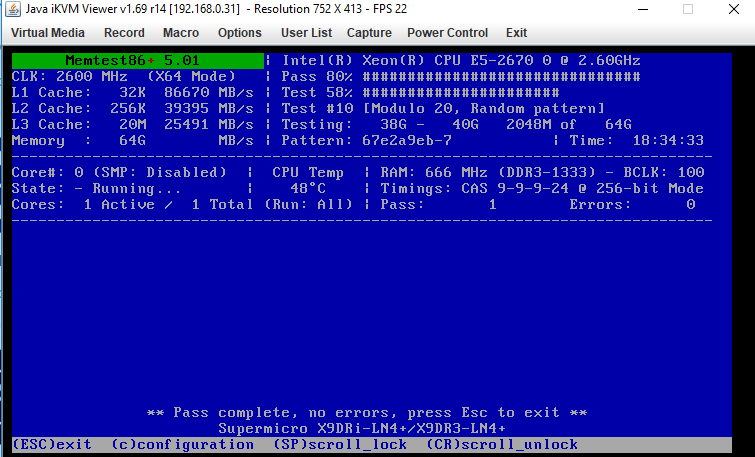

Sounds good I started it I am at 8% right now on the first pass. I really hope it's just a bad stick or two of ram and not a tricky thing to figure out what is causing the slow down.
So I ran it for about 7 hours today and it is still currently going This is what memtest is showing thus far.
Check the board's SEL (system event log), there might be some more info there, single bit memory errors would be corrected by ECC and go undetected by memtest.
Should I let memtest finish first it says it's at 80%

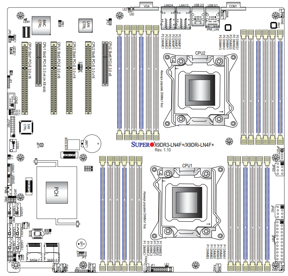

Ohhh truck... I just pulled Those and rearranged the ram for cpu 2 so the blue slots are loaded so it would boot. third times the charm.... right?
Okay this is just really weird... After pulling those other 2 I checked and take a look at this...
10,System Event,2018/05/30 15:29:05 Wed,Memory,#0x00,Assertion: Memory| Event = Correctable ECC@DIMMB1(CPU1)
Another 1????
Does this make any sense or could it honestly be shit ram?
sel3.txt
Edited by taserz
It might be a board problem, try with the minimum amount of RAM possible, and with different stick(s).

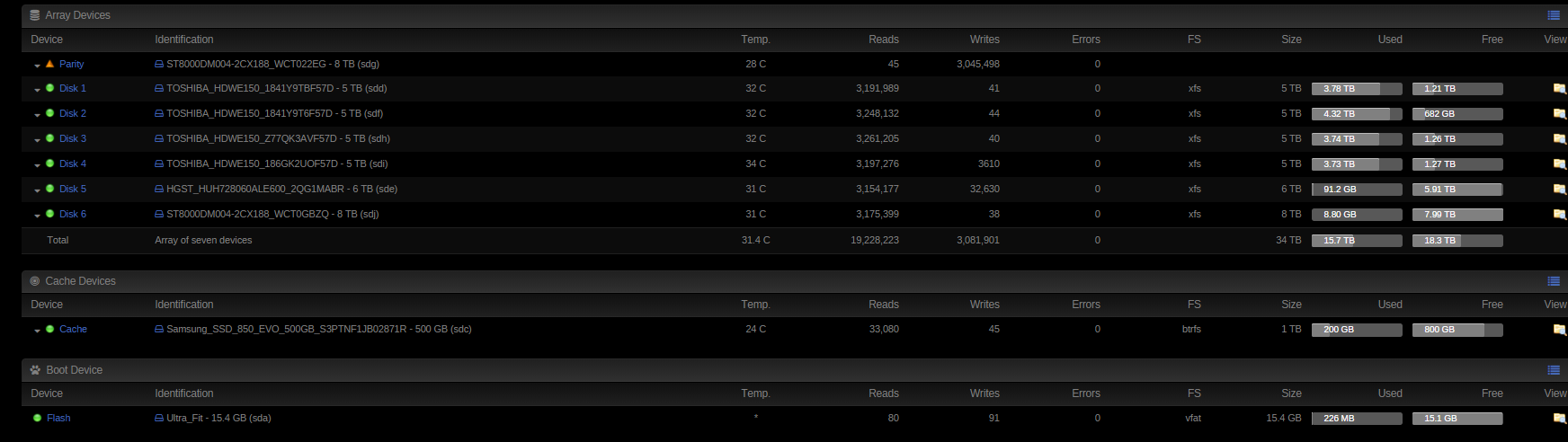

Also on a side note... I just realized my 500gb ssd is showing up in unraid at 1tb? Is there a way to fix this I am not sure what unraid will try to do once it gets to 500gb.
You have an unassigned SSD that is currently part of the cache pool, you can remove it with (with the array started):
btrfs dev del /dev/sdb1 /mnt/cache
Check it's still sbd as it was in the diags posted.
Yeah I was going to have it set as a raid 0 but I did not want a headache if it fails so I am going to way to get a third ssd so everything has a parity.
I ran that command and it didn't seem the chance the number. I see sdb in my unassigned devices.
You need to wait for the data to be transferred, sdb had most of the pool data, the device will then be removed from the pool and a GUI refresh will show the new space usage.
